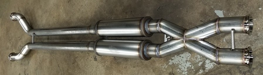

connoisseurr Posted May 8, 2019 Report Share Posted May 8, 2019 Exhaust system looks great. Eager to see more! I’m also standing by for a Group Buy. I think most folks will want some sort of metric being able to justify the cost of these downpipes set. 1 Quote Link to comment Share on other sites More sharing options...
snmjim Posted May 8, 2019 Author Report Share Posted May 8, 2019 (edited) 19 hours ago, connoisseurr said: Exhaust system looks great. Eager to see more! I’m also standing by for a Group Buy. I think most folks will want some sort of metric being able to justify the cost of these downpipes set. I ask that everyone please be patient because 1st we have to refine the various Tunes then to meet our sponsors requirements we need to rent the track to enable us to achieve the various configuration track slips then we need to schedule dyno time. We plan on having all of this done within the next 2 to 3 months...if all goes well... In addition my Mother just passed so this will have a negative impact on my progress pace...? Edited May 9, 2019 by snmjim 4 Quote Link to comment Share on other sites More sharing options...

Xtra Posted June 3, 2019 Report Share Posted June 3, 2019 (edited) Super nice job on that exhaust as well as some great photos . This is by far the best set up on an Edge that I have ever seen. The design and execution is top shelf. Just a few questions if you don't mind. I might have missed it but what is the diameter of the pipe? And I am wondering if those are two mufflers that I see in line, if so can I get some more info on them. Like the size, make and model. Thanks. Edited June 3, 2019 by Xtra 3 Quote Link to comment Share on other sites More sharing options...
snmjim Posted June 3, 2019 Author Report Share Posted June 3, 2019 (edited) 11 hours ago, Xtra said: Super nice job on that exhaust as well as some great photos . This is by far the best set up on an Edge that I have ever seen. The design and execution is top shelf. Just a few questions if you don't mind. I might have missed it but what is the diameter of the pipe? And I am wondering if those are two mufflers that I see in line, if so can I get some more info on them. Like the size, make and model. Thanks. Hey there Brother from the Best Coast... Good to hear from you, how's the ankle healing? Thank you for the compliments! The following are my responses to your questions: - Pipe diameter is a consistent 2.5" from the Turbos back however, we initially wanted to go 3.0" from the Turbos back but due to the late model 2015 through 2019 Edge Sport & ST front Turbo configuration the extreme turn the downpipe has to make immediately coming off the front Turbo would not be conducive to the exhaust gasses flowing smoothly out of the front Turbo. Therefore we were able to achieve a smooth flowing bend using 2.5" pipe. NOTE: after careful measuring, analysis and research we came to realize there's no negative impacts going 2.5" because it well exceeds stock and stock modified Turbo exhaust port size. - Those are two resonators (https://www.amazon.com/dp/B01C63YQSU/ref=cm_sw_r_em_apa_i_Bas9Cb0YFHJWP) commonly called back in our hot rod days as glass packs, thrush mufflers or cherry bombs. We elected to go with the two resonators to mitigate droning without increasing restriction. However, to maintain the sleeper concept we went with retaining the stock muffler which is steadily blowing out due to the added Turbo pressure and ironically the resulting tone is one we've decided to stay with... BIG NOTE: we made it possible to have the entire system reproducible from the down pipes back to the tail pipes without needing the car so they are available to order and shipping to your front door. Your flavors are 2.5" downpipes into the stock exhaust system or 2.5" downpipes with a 2.5" exhaust system to the tail pipe or any variation there of, after all he is a custom fabricator... Drive by sample with WOT & cutouts open: https://youtu.be/639Cx_dxJwo Edited June 3, 2019 by snmjim 3 1 Quote Link to comment Share on other sites More sharing options...
