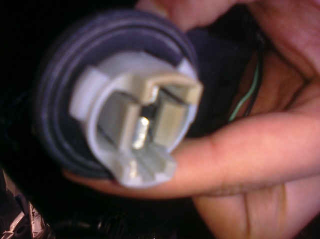

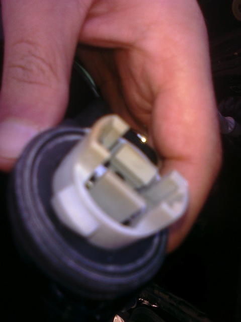

k_m Posted January 18, 2010 Report Share Posted January 18, 2010 (edited) After reading this thread I decided to check mine. We have a 2010 Edge w/ 2000 miles on it. Our tail lights are starting to show signs of discoloration around the socket [The white portion] as well. Its not as bad as the ones posted in here but looks like they are heading in the same direction Looks Like I need to start looking into LEDS as well [hopefully they will stop the burning process] . Really do not want to go that route but its better than having a burnt/possibly damaged socket Also has anyone checked the front turn signal bulbs/socket? Have they started to burn/discolor as well? Edited January 18, 2010 by k_m Quote Link to comment Share on other sites More sharing options...
k_m Posted January 18, 2010 Report Share Posted January 18, 2010 (edited) Our local Autozone has 3157R Super-Bright Red LED by Jam Strait [12v] bulbs for $16.99. They are about the same brightness as the stock bulbs. and the blink rate is slightly faster than what it was w/ the stock bulbs. Also, attached are a couple of pics from our 2010 Edge indicating slight discoloration around the socket [right now we are at 2000 miles] Hope this helps [uPDATE: I checked the front Turn Signal Bulbs/socket and everything looked fine. Must only be an issue with the Rear Tail Lamps. Don't know if it made a difference that the front bulbs are orange/amber colored and the read tail lamps are clear.] Edited January 18, 2010 by k_m Quote Link to comment Share on other sites More sharing options...
