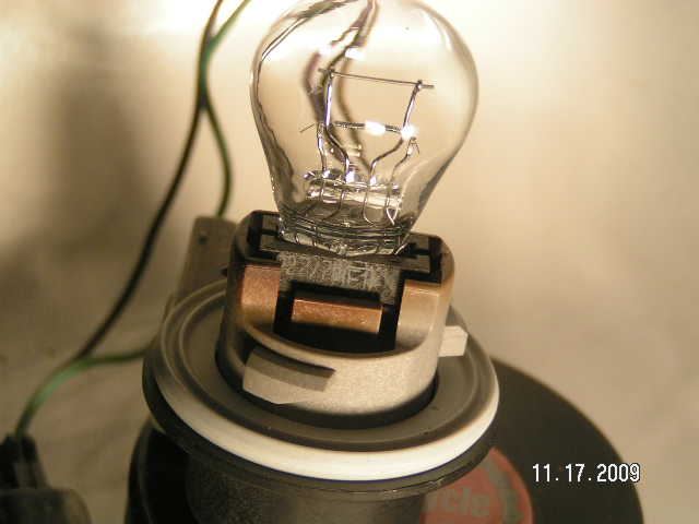

tpm419419 Posted November 18, 2009 Report Share Posted November 18, 2009 With 16000 miles on my 2007 Edge my signal/brake light went out.. first time it went out but later came back on and stayed working. now a week later it went out again. It is the rear left side that the bulb went out and I found it was burnt. Look at the pictures. The new bulb is working for now. Ford told me to come in right away so that will be tomorrow morning. Quote Link to comment Share on other sites More sharing options...

tpm419419 Posted November 19, 2009 Report Share Posted November 19, 2009 (edited) I will see what they have to say tomorrow. If anyone has a service or tech bulletin # on the burning bulbs please let me know Thanksa Just got back from Ford. They said the bulbs were defective, the filaments were giving off too much heat. They changed the bulbs to an upgraded type and said the sockets were discolored on the outside but didn't pose a problem. (inside looked good). Surprisingly they also ordered 4 new chrome clad wheels for me because of the corrosion on the outer edge of the wheels I am trusting what they say and would rather not cut into the wiring to change the sockets if it didn't need to be Edited November 19, 2009 by tpm419419 Quote Link to comment Share on other sites More sharing options...

Kanatronic Posted November 19, 2009 Report Share Posted November 19, 2009 Just got back from Ford. They said the bulbs were defective, the filaments were giving off too much heat. They changed the bulbs to an upgraded type and said the sockets were discolored on the outside but didn't pose a problem. (inside looked good). Surprisingly they also ordered 4 new chrome clad wheels for me because of the corrosion on the outer edge of the wheels I am trusting what they say and would rather not cut into the wiring to change the sockets if it didn't need to be Sorry but do not trust so blindly, that is total BS, the ones they placed are also plastic wedge (just check them) and will burn the sockets again. The ones I reco before, that I got from Candlepower, are glass wedge/polymer collar, and rated to 14 volts for all time on heavy duty use, which make them a lot cooler and safer, and they still burnt the sockets, the material of the sockets is BS, and need to be replaced, so unless they change the socket material, I will go with LEDs... Quote Link to comment Share on other sites More sharing options...
tpm419419 Posted November 19, 2009 Report Share Posted November 19, 2009 Sorry but do not trust so blindly, that is total BS, the ones they placed are also plastic wedge (just check them) and will burn the sockets again. The ones I reco before, that I got from Candlepower, are glass wedge/polymer collar, and rated to 14 volts for all time on heavy duty use, which make them a lot cooler and safer, and they still burnt the sockets, the material of the sockets is BS, and need to be replaced, so unless they change the socket material, I will go with LEDs... I just may do that but need to know if I need a resister or how to install the resister for the signals Quote Link to comment Share on other sites More sharing options...
