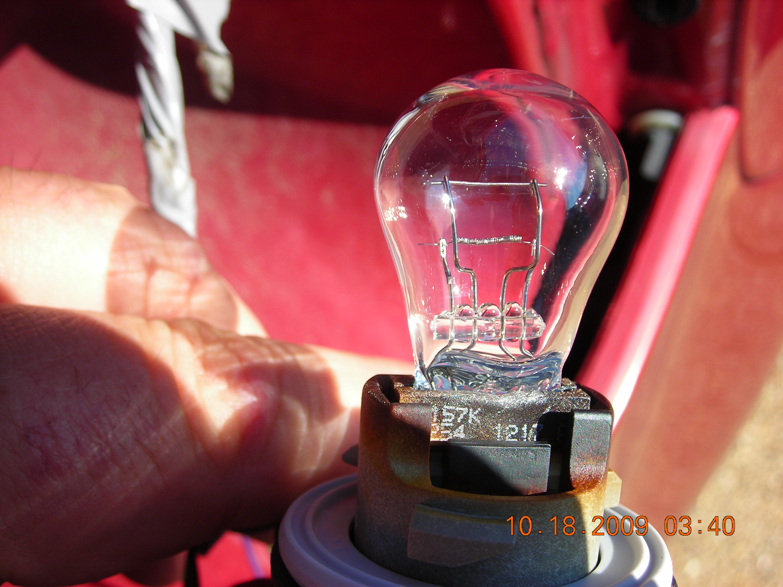

gsafree Posted October 19, 2009 Report Share Posted October 19, 2009 Last week I installed a Hidden Hitch and T-One wiring harness on my 2007 SE. The job was pretty simple, just time consuming, as others have noted. It took a little longer for me though, since my hitch was bent from shipping and the horrible packaging it was sent in...but I digress. My concern came when I went to install the T-One harness. I removed the tail lights and found that the main light bulbs on both sides had gotten so hot that they were blackened and even a little melted. Has anyone seen anything like this? The only other problem that I have had is the transmission shifting hard at low speed, otherwise I have 16K on it and rolling! When I checked mine out on my 2007 Edge with 28 K they are also bad and looks like I need to take it in . This looks like it could be a recall. The socket is burnt and looks like design or wrong part install at the factory. Quote Link to comment Share on other sites More sharing options...
Kanatronic Posted October 19, 2009 Report Share Posted October 19, 2009 When I checked mine out on my 2007 Edge with 28 K they are also bad and looks like I need to take it in . This looks like it could be a recall. The socket is burnt and looks like design or wrong part install at the factory. Do not replace the bulbs take it ot the dealer and have them replace the wiring harness as well under warranty...later on replace the bulbs with the ones I stated above from Candlepower, which Daniel Sterns endorse... Quote Link to comment Share on other sites More sharing options...
Sparky Posted October 19, 2009 Report Share Posted October 19, 2009 Do not replace the bulbs take it ot the dealer and have them replace the wiring harness as well under warranty...later on replace the bulbs with the ones I stated above from Candlepower, which Daniel Sterns endorse... Is this 07, 08 problem or any 09, 10 owners had to deal with this. Quote Link to comment Share on other sites More sharing options...

LFJ2025 Posted October 20, 2009 Report Share Posted October 20, 2009 Last week I installed a Hidden Hitch and T-One wiring harness on my 2007 SE. The job was pretty simple, just time consuming, as others have noted. It took a little longer for me though, since my hitch was bent from shipping and the horrible packaging it was sent in...but I digress. My concern came when I went to install the T-One harness. I removed the tail lights and found that the main light bulbs on both sides had gotten so hot that they were blackened and even a little melted. Has anyone seen anything like this? The only other problem that I have had is the transmission shifting hard at low speed, otherwise I have 16K on it and rolling! check this out!!!!! http://www.wtoctv.com/Global/story.asp?S=9...mp;nav=menu89_2 Quote Link to comment Share on other sites More sharing options...
