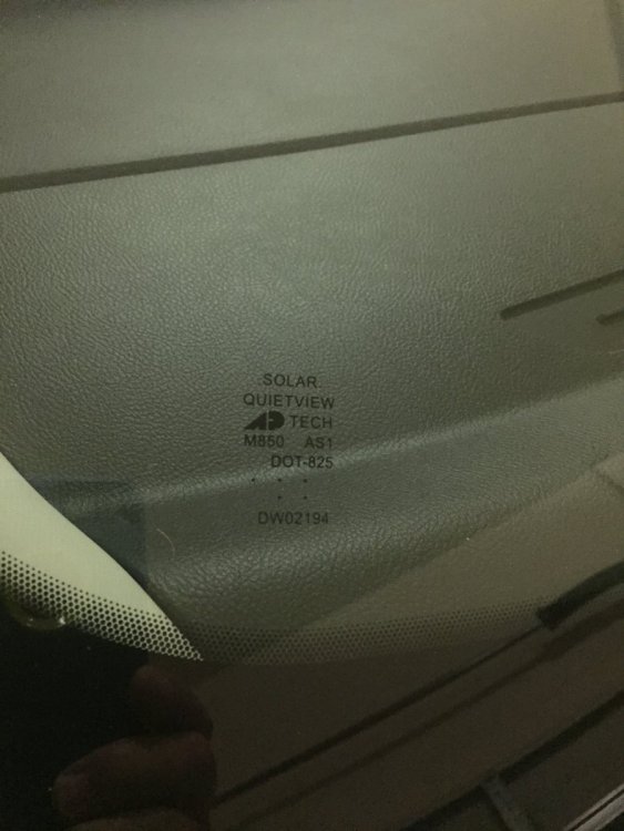

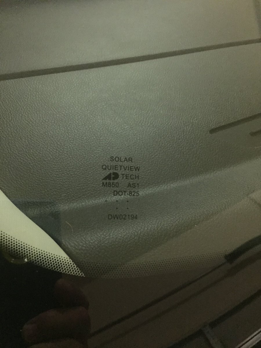

LDRONNOW Posted November 8, 2018 Report Share Posted November 8, 2018 Just traded in my Merc mountaineer for a used 2017 edge. I am very happy with the vehicle however just curious if any one has had a windshield replace and now have a loud wind noise at 70 mph. I am guessing that this is what has happen but wanted to check first to see if anyone else has experience wind noises from the front dash area. Quote Link to comment Share on other sites More sharing options...

LDRONNOW Posted November 9, 2018 Author Report Share Posted November 9, 2018 Not seeing any of those symbols Quote Link to comment Share on other sites More sharing options...
WWWPerfA_ZN0W Posted November 10, 2018 Report Share Posted November 10, 2018 Doesn't match up to any known manufacturer by DOT code. This is what I am referencing, may be a better reference out there: http://www.carwindshields.info/dot_db I did find the glass by P/N DW02194, still no go on mfr https://jmcautoglass.com/replacements/ford/edg/ws-edg/15-16-ws-edg/2015-2016-ford-edge-windshield-replacement-pricing-aci/ 1 Quote Link to comment Share on other sites More sharing options...

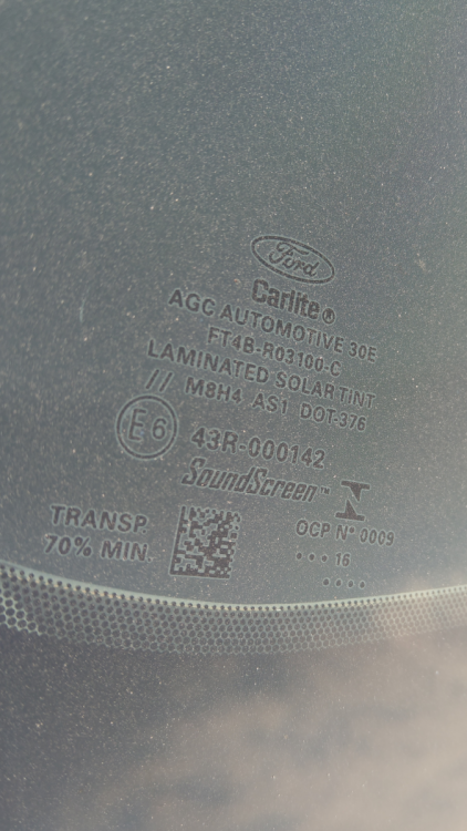

omar302 Posted November 10, 2018 Report Share Posted November 10, 2018 (edited) Seems it's either a bad install or lesser quality replacement. This is the logo on my 2016 Edge. Edited November 10, 2018 by omar302 2 Quote Link to comment Share on other sites More sharing options...
