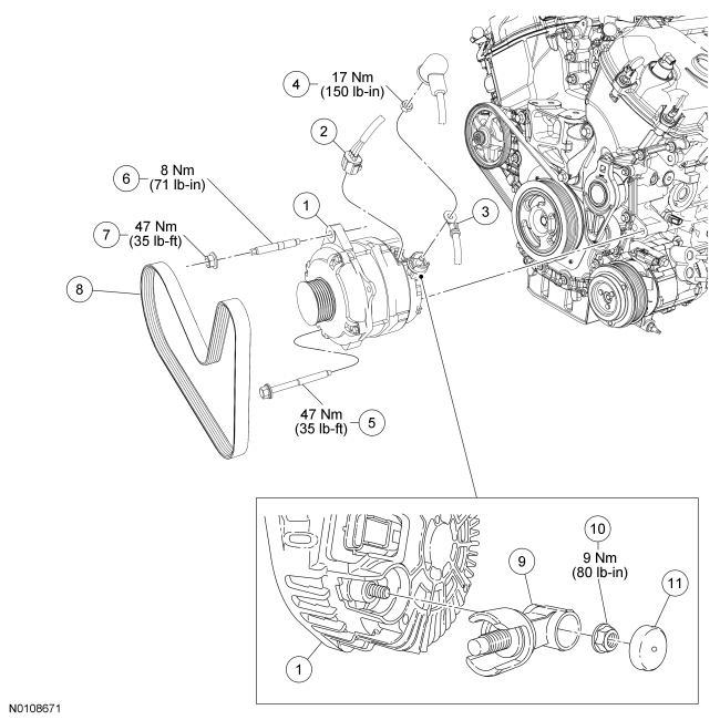

enigma-2 Posted November 4, 2018 Report Share Posted November 4, 2018 (edited) This is the procedure for a 2009 Edge, but I think it hasn't changed since 08. Item Part Number Description 1 10300 Generator 2 Generator electrical connector (part of 14B060) 3 Generator B+ terminal (part of 14B060) 4 W711953 Generator B+ terminal nut 5 W709986 Generator bolt 6 W712609 Generator stud 7 W520414 Generator nut 8 8620 Front End Accessory Drive (FEAD) belt 9 10329 Radial arm adapter 10 Radial arm adapter nut (part of 10329) 11 Radial arm adapter cap (part of 10329) Removal and Installation NOTE: The radial arm adapter is a serviceable item. Do not replace the generator if the radial arm adapter is the only concern. Disconnect the battery. For additional information, refer to Section 414-01 . Remove the cooling fan. For additional information, refer to Section 303-03 . Rotate the accessory drive belt tensioner counterclockwise and position the accessory drive belt aside. Position the generator B+ terminal protective cover aside, remove the nut and position the generator B+ terminal aside. To install, tighten to 17 Nm (150 lb-in). Disconnect the generator electrical connector. Detach the pin-type retainer and wiring harness. Remove the generator stud nut. To install, tighten to 47 Nm (35 lb-ft). Remove the generator stud. To install, tighten to 8 Nm (71 lb-in). Remove the RH fender splash shield. For additional information, refer to Section 501-02 . Loosen the generator bolt and remove the generator. To install, tighten to 47 Nm (35 lb-ft). To install, reverse the removal procedure. Be a good time to check the tensioner and change the belt as well. Edited November 4, 2018 by enigma-2 2 Quote Link to comment Share on other sites More sharing options...
WWWPerfA_ZN0W Posted November 4, 2018 Report Share Posted November 4, 2018 With time & care, yes it is DIY. Yes, it is a good ole PITA too. Change belts while you are in there, old ones have to come off anyway. 2 Quote Link to comment Share on other sites More sharing options...
