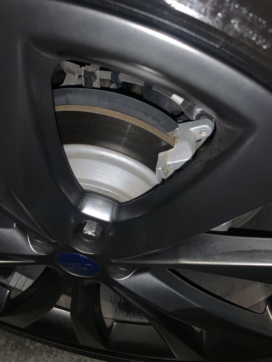

1004ron Posted May 20, 2023 Report Share Posted May 20, 2023 6 hours ago, SlippyNuxx said: Hey @1004ron, it's been almost a year, so how are the Centric rotors/pads working out for you in regards to performance and rust/corrosion resistance? I'm still very happy with them - smooth and quiet. I used the same silver paint on the new front rotors and the rear, and as can be seen they still look better than they would if they weren't painted, but could do with a fresh coat of paint. 1 1 Quote Link to comment Share on other sites More sharing options...
