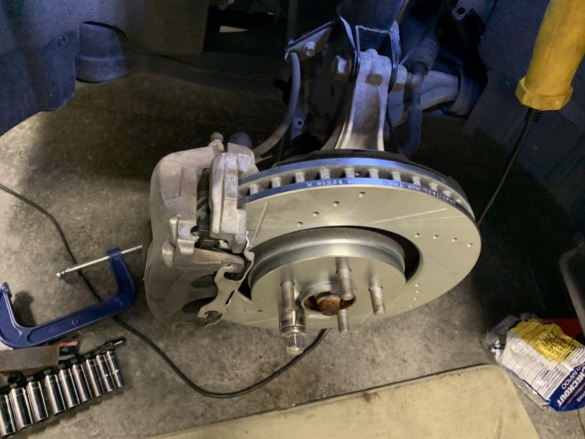

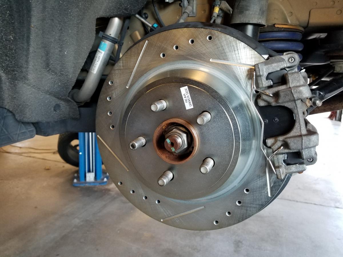

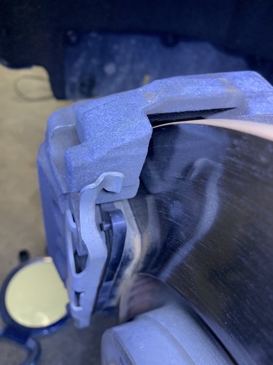

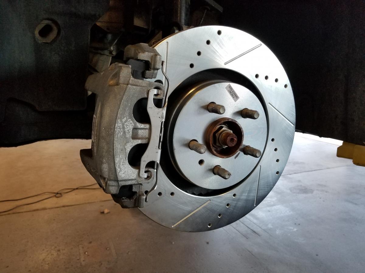

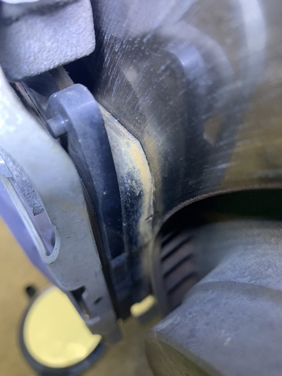

Beezz Posted November 13, 2018 Report Share Posted November 13, 2018 (edited) Ive had the same kit sitting for 2 months in the garage, no damn time to install. Plan to do brake fluid, ss lines, rear swaybar, F/R links, caliper covers, and winter tire swap all at the same time. Any tips for the install? Any issues with the install? Did your pads have any chipping on them? I ordered 2 sets of front and rear pads and the fronts both have chipping. (ordered everything from rock auto) Thanks! On 10/31/2018 at 12:47 PM, snmjim said: If you feel you don't need the exotic calibers & rotors & pads that Xtra & Root have on their Sports but feel your braking system has the caliber pressure/power you require but with better pads & rotors it would be all you need then try the Power Stop Pad & Rotor kit #K7231 Comes with pads, rotors and all replacement hardware for all four wheels. I purchased mine from www.rockauto.com for under $300. after the Rock Auto discount & PowerStop rebate... Edited November 13, 2018 by Beezz Quote Link to comment Share on other sites More sharing options...
WWWPerfA_ZN0W Posted November 13, 2018 Report Share Posted November 13, 2018 Got pics to share of the chipped front pads? I have to date not had any issues with them either on the Edge or the Fusion. Quote Link to comment Share on other sites More sharing options...
snmjim Posted November 13, 2018 Author Report Share Posted November 13, 2018 12 hours ago, Beezz said: Ive had the same kit sitting for 2 months in the garage, no damn time to install. Plan to do brake fluid, ss lines, rear swaybar, F/R links, caliper covers, and winter tire swap all at the same time. Any tips for the install? Any issues with the install? Did your pads have any chipping on them? I ordered 2 sets of front and rear pads and the fronts both have chipping. (ordered everything from rock auto) Thanks! Beezz, All looks like the makings of a thorough project. Tips/Reco/Comments: - The caliper rubber grommets for the slide pins that come with the Power Stop pad kit should be greased inside & out with a non rubber deteriorating grease to ease install & movement, it can be a battle without it unless there's a special tool or technique I lack, - Stabilizer bar link locks to prevent horizontal shifting of the bar, especially since the tolerance from bar end to electronic brake servo will be close. - H&R Springs from Tirerack No, I didn't have any chipping on my pads however, I can't comment in detail without some Pics. 2 Quote Link to comment Share on other sites More sharing options...

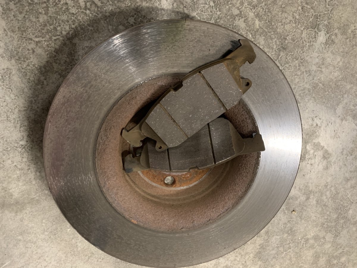

1004ron Posted March 31, 2019 Report Share Posted March 31, 2019 (edited) On 10/31/2018 at 12:47 PM, snmjim said: If you feel you don't need the exotic calibers & rotors & pads that Xtra & Root have on their Sports but feel your braking system has the caliber pressure/power you require but with better pads & rotors it would be all you need then try the Power Stop Pad & Rotor kit #K7231 Comes with pads, rotors and all replacement hardware for all four wheels. I purchased mine from www.rockauto.com for under $300. after the Rock Auto discount & PowerStop rebate... Thanks for this informative post. I'm happy with the the original brakes performance and was planning to stick with OEM pads, but recently I've been reconsidering that. My 2017 Sport with 21" wheels is at two years and 39K miles, and since a couple of months ago I've notice and heard a slight vibration from the front when applying brakes at 70 mph, but below 50 mph its quiet and smooth - this had me start searching for a way to address this slight vibration and this led me to your post. When I checked the pads at 36K miles they still had around 50% material left, but will be installing a Power Stop kit before they're actually due for replacement because of the vibration - a shame to spend money on this when the pads have so much material left on them. I'm thinking of just doing the front with the Power Stop K7143 and the $15 rebate which makes it $159 https://www.rockauto.com/en/catalog/ford,2017,edge,2.7l+v6+turbocharged,3434543,brake+&+wheel+hub,rotor+&+brake+pad+kit,13824 Please confirm that it is the 345mm Front Rotors. Edited March 31, 2019 by 1004ron Quote Link to comment Share on other sites More sharing options...
onyxbfly Posted March 31, 2019 Report Share Posted March 31, 2019 35 minutes ago, 1004ron said: Thanks for this informative post. I'm happy with the the original brakes performance and was planning to stick with OEM pads, but recently I've been reconsidering that. My 2017 Sport with 21" wheels is at two years and 39K miles, and since a couple of months ago I've notice and heard a slight vibration from the front when applying brakes at 70 mph, but below 50 mph its quiet and smooth - this had me start searching for a way to address this slight vibration and this led me to your post. When I checked the pads at 36K miles they still had around 50% material left, but will be installing a Power Stop kit before they're actually due for replacement because of the vibration. I'm thinking of just doing the front with the Power Stop K7143 and the $15 rebate which makes it $159 https://www.rockauto.com/en/catalog/ford,2017,edge,2.7l+v6+turbocharged,3434543,brake+&+wheel+hub,rotor+&+brake+pad+kit,13824 Don't know how you feel about Auto Anything but if you use this code EM10WBN010XB you can get 10% off, free shipping and not tax! Total comes out to $177.62 compared to $199.89 (Including $15 rebate that you have to wait for!) https://www.autoanything.com/brakes/power-stop-z23-evolution-brake-kits 1 Quote Link to comment Share on other sites More sharing options...

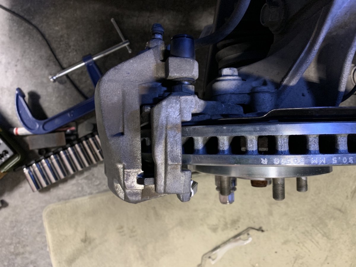

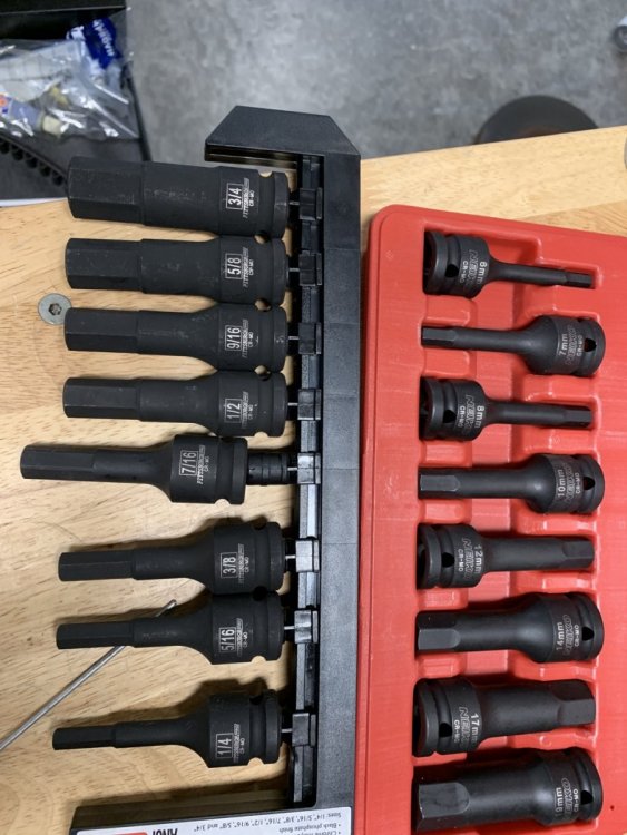

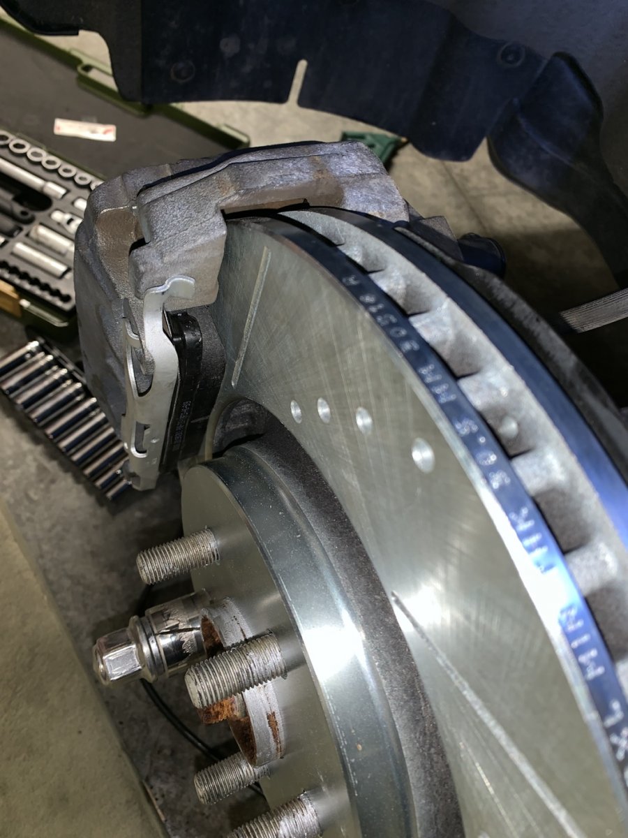

1004ron Posted March 31, 2019 Report Share Posted March 31, 2019 (edited) Can those that have done the front brakes confirm that its a 12mm hex socket needed to take the caliper off. Also, is there any special techniques for retracting the caliper pistons? Edit/Update: Its 11mm Edited November 27, 2019 by 1004ron Quote Link to comment Share on other sites More sharing options...
snmjim Posted March 31, 2019 Author Report Share Posted March 31, 2019 (edited) 6 hours ago, 1004ron said: Thanks for this informative post. I'm happy with the the original brakes performance and was planning to stick with OEM pads, but recently I've been reconsidering that. My 2017 Sport with 21" wheels is at two years and 39K miles, and since a couple of months ago I've notice and heard a slight vibration from the front when applying brakes at 70 mph, but below 50 mph its quiet and smooth - this had me start searching for a way to address this slight vibration and this led me to your post. When I checked the pads at 36K miles they still had around 50% material left, but will be installing a Power Stop kit before they're actually due for replacement because of the vibration - a shame to spend money on this when the pads have so much material left on them. I'm thinking of just doing the front with the Power Stop K7143 and the $15 rebate which makes it $159 https://www.rockauto.com/en/catalog/ford,2017,edge,2.7l+v6+turbocharged,3434543,brake+&+wheel+hub,rotor+&+brake+pad+kit,13824 Please confirm that it is the 345mm Front Rotors. From my research on RockAuto and the 2016 Ford Edge Sport in general which applies to late model 2015 thru 2018 you have the 345mm rotors, I also confirmed this with RockAuto & Power Stop. Therefore you are ordering the correct kit however, you may want to give strong consideration to replacing all brakes based on age alone due to warping & rotor hot spots & micro fractures which could lead to a very ugly outcome. Being 62 and that project being like 12 projects ago there is no way for me to remember socket sizes, sorry there however if you don't have a complete compliment of tools you may want to solicit some help, especially with the overhaul parts, especially the rubber slider bushings. Your caliper pistons do not require any special treatment to retract the pistons just use the standard retracting tool. BIG NOTE: Per the factory service manual (FSM) you MUST go into the dash menu and put your brakes into the service/maintenance mode before start of work and taken out of that mode once service is complete! NEVER CUT CORNERS ON SAFETY ITEMS ESPECIALLY WHEN IT COMES TO Hi-Po APPLICATIONS!!!... Edited March 31, 2019 by snmjim 3 Quote Link to comment Share on other sites More sharing options...

1004ron Posted July 27, 2019 Report Share Posted July 27, 2019 (edited) On 3/31/2019 at 11:11 AM, 1004ron said: Can those that have done the front brakes confirm that its a 12mm hex socket needed to take the caliper off. Also, is there any special techniques for retracting the caliper pistons? I can confirm that it is an 11mm hex socket that's needed - I had a metric set that I bought a while back in preparation for this job, then on the day found it lacks the needed 11mm and I ran around to all the stores in my area and none have an 11mm , not on its own and not in a set, so in one shop I grabbed a digital calliper and found an imperial set and the 7/16" was a good match so bought that set. The 7/16" is a very good snug fit. Brake job went smooth, the rotors needed a beating to break free of the corrosion. Can't comment on braking performance just yet as I've only done the break-in, but can confirm that it got rid of the vibration/drone when braking at 60mph and above, and they look good. Complete front kit order on Amazon for $170 (retailer is Jeggs) and two day shipping from the manufacturer in Chicago IL - goods received in perfect order. Edited July 27, 2019 by 1004ron 3 Quote Link to comment Share on other sites More sharing options...
