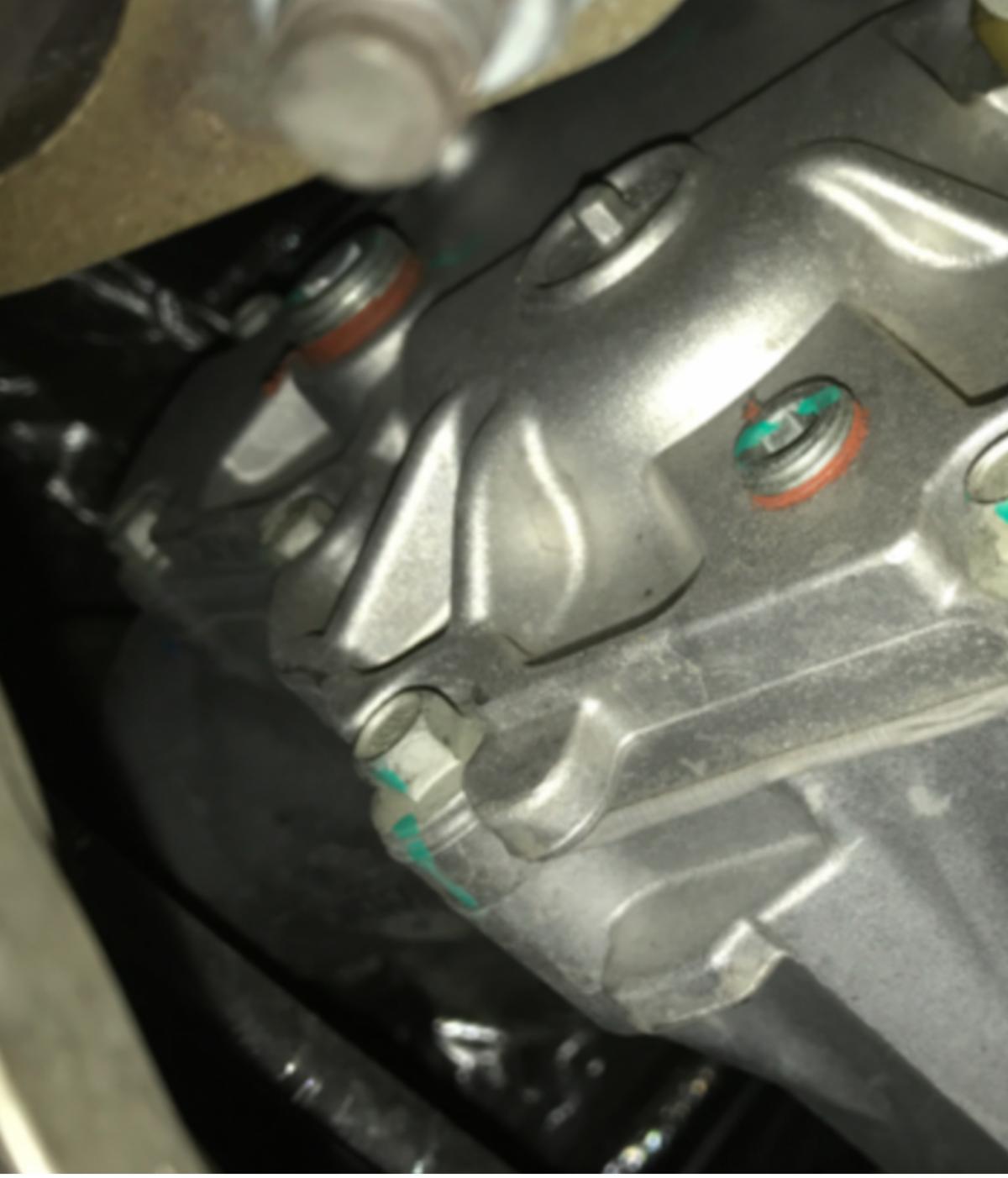

vega Posted October 27, 2018 Report Share Posted October 27, 2018 (edited) I have a 2015 SE AWD. Want to change the fluid in my PTU. I don't have a sport but I see what looks like a drain plug in the PTU but it is not on the bottom like photos I have seen for the sport on the bottom of the PTU. It look like a drain plug on the side but lower from the upper fill plug. Is this a drain plug I am looking at? To the right of the photo? I thought for sure it wouldn't have a drain. Can anyone comfirm that this is the drain plug? Thanks gang. https://photos.app.goo.gl/gsV9CDJ33CeQ1MCT8 Edited October 27, 2018 by vega Quote Link to comment Share on other sites More sharing options...
vega Posted October 27, 2018 Author Report Share Posted October 27, 2018 Here is a picture I found that matches my PTU. 2 plugs. https://www.fordflex.net/forums/download/file.php?id=5529 Quote Link to comment Share on other sites More sharing options...
1004ron Posted October 27, 2018 Report Share Posted October 27, 2018 I have a 2015 SE AWD. Want to change the fluid in my PTU. I don't have a sport but I see what looks like a drain plug in the PTU but it is not on the bottom like photos I have seen for the sport on the bottom of the PTU. It look like a drain plug on the side but lower from the upper fill plug. Is this a drain plug I am looking at? To the right of the photo? I thought for sure it wouldn't have a drain. Can anyone comfirm that this is the drain plug? Thanks gang. Ā https://photos.google.com/photo/AF1QipOC55TTLHTHirwCOOxa3GoWFP5dXlLTBAyLCrq6 That photo isn't showing - try uploading to this site. Quote Link to comment Share on other sites More sharing options...
1004ron Posted October 27, 2018 Report Share Posted October 27, 2018 Here is a picture I found that matches my PTU. 2 plugs. https://www.fordflex.net/forums/download/file.php?id=5529 That is most likely a drain plug, if its at the low point when mounted. Quote Link to comment Share on other sites More sharing options...
vega Posted October 27, 2018 Author Report Share Posted October 27, 2018 Yeah but it's a bit of a surprise because it does not fit the regular drain plug profile. Quote Link to comment Share on other sites More sharing options...

vega Posted October 28, 2018 Author Report Share Posted October 28, 2018 Oh, wow, thank you all. It just looked so weird and just surprised that a 2015 SE would have a drain plug. Makes it much easier!!! Quote Link to comment Share on other sites More sharing options...
WWWPerfA_ZN0W Posted October 28, 2018 Report Share Posted October 28, 2018 Ford quietly implemented drain plugs in all Gen 2 PTUs. 1 Quote Link to comment Share on other sites More sharing options...
