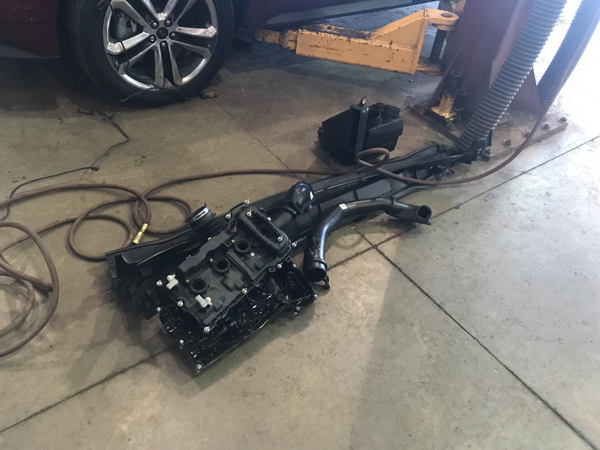

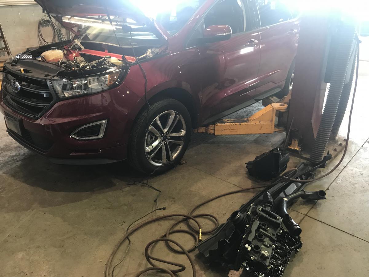

shumax Posted September 14, 2018 Author Report Share Posted September 14, 2018 (edited) Ford has asked my dealer to remove the oil pan and heads and submit photos of it taken apart. I have no more details than that - my wife spoke to them. They are doing that Monday. Ford would not authorize a rental - even under goodwill. They punted me to my dealer. Because I did not buy it there, they arent as willing. I have some leverage as my company vehicle is a Ford and I have spent $8-$10,000 there in repairs over the last several years and referred people in, too. They recognize that and have not said no. They want to wait and see what Ford says after they pull the engine. I am not upset with my dealer at all. I get it and appreciate what they are doing thus far. Ford? Not happy. I appreciate they dont have to provide a rental; however, given this is the second major engine issue in 20,000 miles, and I am a loyal customer, they should at least help in some way. My opinion. Should know more on Monday or Tuesday. I plan to create a website to document my experience. I see a few others have on the 2.7eco, too. Shumax Edited September 14, 2018 by shumax Quote Link to comment Share on other sites More sharing options...

shumax Posted September 19, 2018 Author Report Share Posted September 19, 2018 Ford required the dealer to pull the valve cover, and drop the oil pan, and submit photos. New engine should be approved today. Should get the new engine by Friday. Put it in on Monday... 1 Quote Link to comment Share on other sites More sharing options...
