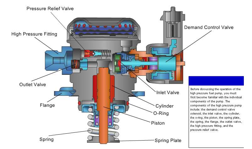

Xtra Posted September 7, 2018 Report Share Posted September 7, 2018 (edited) It has come to my attention that a high performance HPFP is needed for the 2.7 EB . These are available for almost every other displacement EB out there and somehow the 2.7 has been overlooked. The HPFP is the key to unlocking the full potential of this engine. If the engine has no fuel it does not matter what mods you do . The stock HPFP can only supply so much fuel and that ultimately determines how much power one can make. The HI Pressure Fuel Pump ( HPFP ) is driven off of the back cam lobe and I am not sure if we have 3 or 4 lobe cam on the 2.7 EB . A proper performance HPFP could deliver enough fuel to run E85 if wanted or needed. I have found HPFP that deliver 35% more and others at 60% more fuel than stock but they don't fit the 2.7EB. Anyway here are some drawings describing the HPFP and how it works. Edited September 7, 2018 by Xtra 1 Quote Link to comment Share on other sites More sharing options...
