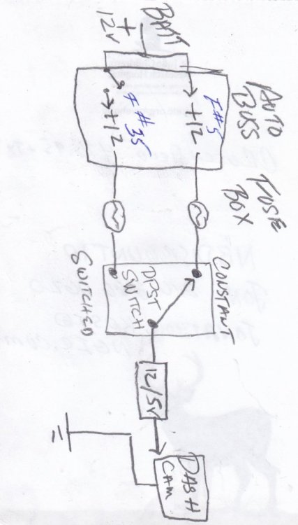

paulwoodside Posted September 11, 2023 Report Share Posted September 11, 2023 I used 2 fuse taps connected one to fuse #5 (always on) and #35 (switched on/off) installed a DPST toggle switch next to the steering column and ran the output from the switch thru the dash cam 12 to 5 volt converter and on to the dash cam, this way I can select if I want always on for parking mode or only on while driving. 1 Quote Link to comment Share on other sites More sharing options...
