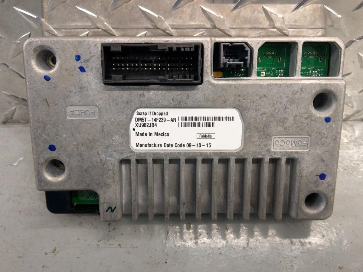

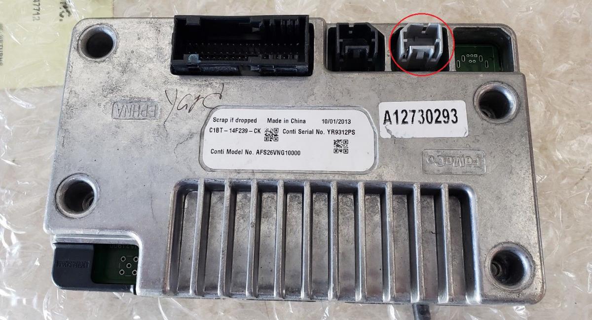

3) Some of them have 2 connectors in the back, while some have 3 connectors. Are they different? Please see the pictures.

3. The 3rd connector is for another USB port not used in our cars. I can look at mine tonight and edit this post but don't remember if all 3 had the extra usb.
