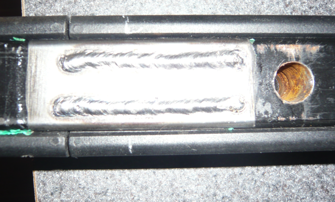

Lex Talionis Posted March 27, 2009 Report Share Posted March 27, 2009 Finally, I got the weld trick done today thanks to a buddy. 2 beads, not very tall, as I just needed to take up the minor space. hand insert is very snug so I have good expectations. I am convinced the Curt hitch is not the culprit, but a foreign made bike hitch with a draw bar fit that is not spec (and it uses an ABS high impact plstic adaptor to take it from Class I to Class II) is the issue. the sway of my bikes was driving me crazy. So, here are some photos before I paint it up. I will find out if it works as I travel with the bikes this weekend and I will report back. Quote Link to comment Share on other sites More sharing options...
BlazedUp Posted March 27, 2009 Report Share Posted March 27, 2009 Damn Lex, was your welder blind. I made better beads on my first attempt at welding. They do look strong though and you'll never see them. Hope it solves your issue. Quote Link to comment Share on other sites More sharing options...
Lex Talionis Posted March 27, 2009 Report Share Posted March 27, 2009 Damn Lex, was your welder blind. I made better beads on my first attempt at welding. They do look strong though and you'll never see them. Hope it solves your issue. boy you sure talk a big game... as though it really matters the weld in this situation that is hidden and only used to take up space and has no structural requirements... I could not care less if it was zig-zagged or a smiley face. if it takes up the right room, stops the slop, who cares. and BTW, yes, he does only have 1 eye Quote Link to comment Share on other sites More sharing options...
