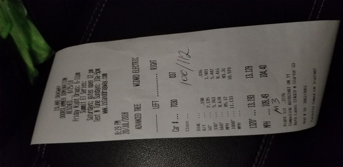

037 Posted July 21, 2018 Report Share Posted July 21, 2018 Also, raced and beat a 2009 M3 sedan at the strip yesterday. Quote Link to comment Share on other sites More sharing options...
