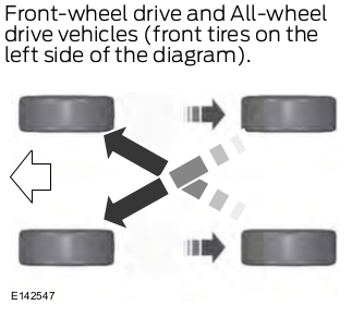

flymore Posted September 5, 2019 Report Share Posted September 5, 2019 Gearing up for my first tire rotation on my new to me 2018 Edge AWD Titanium. The owners manual indicates there are "arrows" that show the lift points, "9. The vehicle jacking points are depicted by arrows on the underside of the vehicle at the locations shown above." I'm not finding the arrows that indicate the lift points. The second question is the rotation pattern. The manual clearly states that for FWD and AWD vehicle use this pattern. There is another post that states for AWD vehicles you must use an X pattern where LR to RF and RR to LF. RF to LR and RR to LF. "On four-wheel drive and all-wheel drive vehicles, the recommended rotation pattern is a “Double X” so the right front and left rear tires switch positions as do the left front and right rear." https://www.tireindustry.org/tire-maintenance/tire-rotation Thanks for any help. Quote Link to comment Share on other sites More sharing options...
