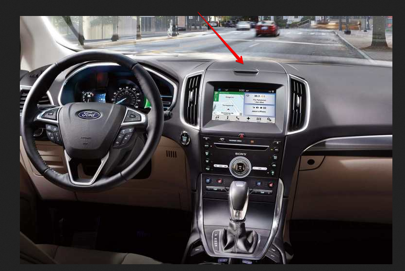

t0lkman Posted July 4, 2018 Report Share Posted July 4, 2018 Does anybody know part number of this part, and if it's easy to replace? Quote Link to comment Share on other sites More sharing options...
omar302 Posted July 5, 2018 Report Share Posted July 5, 2018 This link is for the part. I couldn't find the procedure for removing it, the speaker grille can be pried off & the speaker has 2 bolts (procedure attached). But looking at the parts diagram, there are clips for the cover, so it might just pry off (probably after removing the speaker). Instrument Panel Center Speaker.pdf 2 Quote Link to comment Share on other sites More sharing options...
