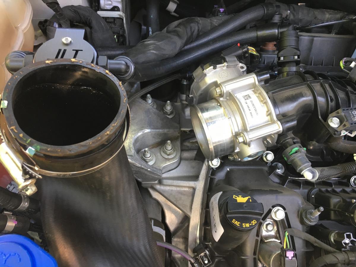

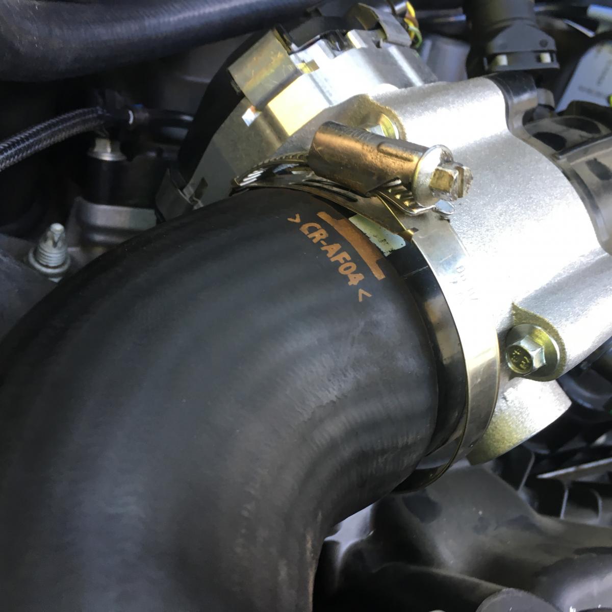

Xtra Posted June 24, 2018 Report Share Posted June 24, 2018 (edited) I just completed the install of the BBK 65 Throttle Body on my 2016 Edge Sport. The BBK 65mm Throttle Body is on the right . Stock 60mm is on the left. Edited June 24, 2018 by Xtra 2 1 Quote Link to comment Share on other sites More sharing options...

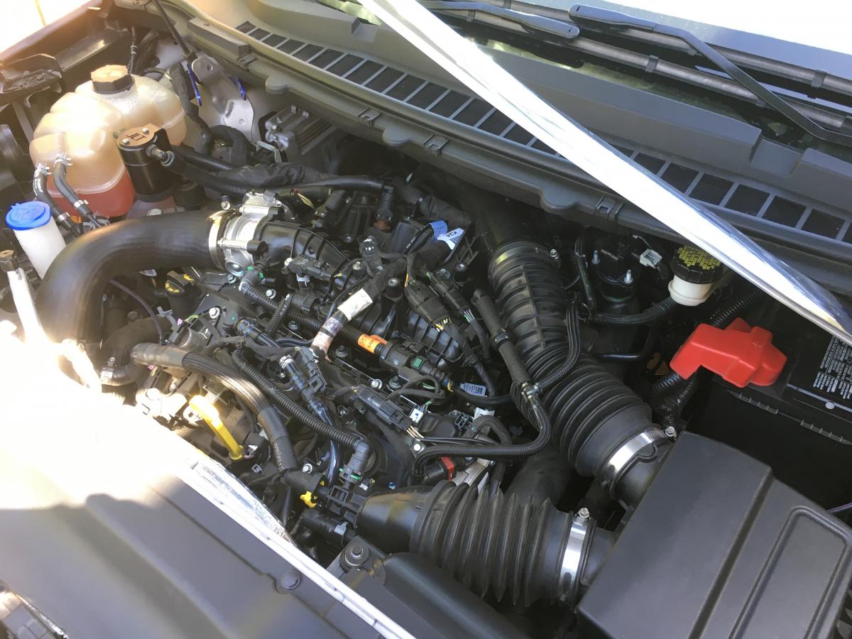

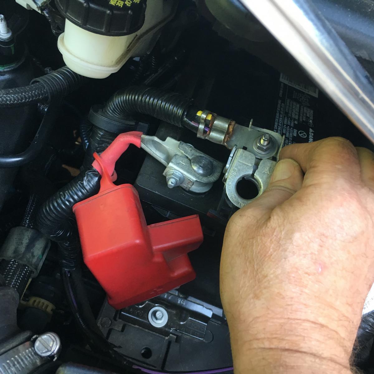

Xtra Posted June 24, 2018 Author Report Share Posted June 24, 2018 (edited) The first thing to do is remove the engine cover and then remove the negative battery terminal. Touch the negative terminal to the positive terminal to discharge the memory capacitors . This will allow the system to relearn the idle and the new throttle body curve. Edited June 24, 2018 by Xtra 1 1 Quote Link to comment Share on other sites More sharing options...

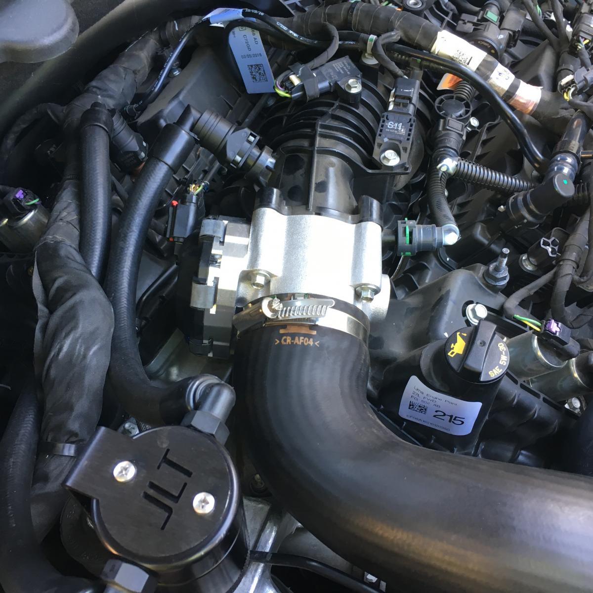

Xtra Posted June 24, 2018 Author Report Share Posted June 24, 2018 (edited) Locate the throttle body and loosen the hose clamp, then remove the hose . The clamp will stay attached to the hose as it is designed that way .So just loosen it up and remove the hose. Edited June 24, 2018 by Xtra 1 1 Quote Link to comment Share on other sites More sharing options...
Xtra Posted June 24, 2018 Author Report Share Posted June 24, 2018 (edited) Next unplug the wire harness. Lift up on the red locking tab then remove the plug. Edited June 24, 2018 by Xtra 1 1 Quote Link to comment Share on other sites More sharing options...

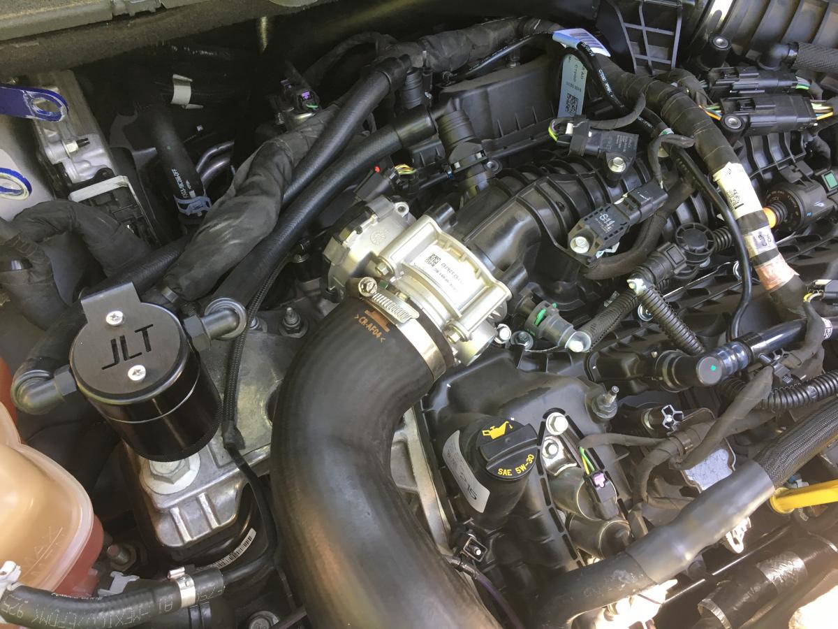

Xtra Posted June 24, 2018 Author Report Share Posted June 24, 2018 (edited) Now use a 8mm wrench to loosen up the 4 bolts on the TB. I got them all broke loose then I took out the bottom bolt closest to the firewall first as it is the hardest to get to. After removing the OEM TB make sure the "O" ring is in place and clean before installing the new BBK 65mm TB. Edited July 8, 2018 by Xtra 1 1 Quote Link to comment Share on other sites More sharing options...
Xtra Posted June 24, 2018 Author Report Share Posted June 24, 2018 (edited) Now just bolt in the new 65mmTB with the four 8mm bolts. Attach the control cable and push down on the red locking tab. Reattach the hose and tighten the hose clamp. Hook up the negative battery terminal and put on the engine cover. It took me around 45 min to this job. It was super easy to do. Edited June 24, 2018 by Xtra 1 1 Quote Link to comment Share on other sites More sharing options...
Xtra Posted June 24, 2018 Author Report Share Posted June 24, 2018 (edited) This is a very important part of the install. Now that the new TB is installed and the old memory has been erased, start the car and let it idle for 15 minutes. Make sure that all accessories are off , no radio headlights anything. Do not disturb the car by opening the doors or windows. just start it, get out of the car and let it run for the full 15 minutes . During this time the idle will re-calibrate and smooth out. After the full 15 minutes take the car for a test drive, just drive it normal not hard or baby it. This will let the transmission reset the shift points of the car. After I did this my car ran much smoother. Some of the NVH in the cabin I attributed to the RMM at idle was just rough idle. This trick smoothed out the idle completly. The new TB works great and it is just what the car needed. It runs smoother and has more power than ever before. I believe that the new BBK 65MM TB complements the Comp Turbos, UPIC and the RamFab Pipe, it is just what the Dr. ordered. Edited June 24, 2018 by Xtra 3 1 Quote Link to comment Share on other sites More sharing options...
