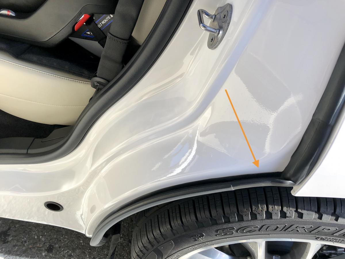

t0lkman Posted June 21, 2018 Report Share Posted June 21, 2018 I'm attaching the photo of the weatherstrip part which could be very easy pulled it looks like it's not glued or attached to hold well. is it the same case for you? Quote Link to comment Share on other sites More sharing options...
Tightanium Posted June 21, 2018 Report Share Posted June 21, 2018 If you’re talking about the rear door one yes. Had to use rtv to help keep it on. 2 Quote Link to comment Share on other sites More sharing options...
omar302 Posted June 21, 2018 Report Share Posted June 21, 2018 I don't see a photo. Quote Link to comment Share on other sites More sharing options...
t0lkman Posted June 22, 2018 Author Report Share Posted June 22, 2018 Didn't attach for some reason initially... 2 Quote Link to comment Share on other sites More sharing options...
Tightanium Posted June 22, 2018 Report Share Posted June 22, 2018 Yep. That’s the one I was thinking it was. I used RTV. The reason I used RTV was I’m thinking it would be easier to clean up if I had to remove the weather strip. There was a thread here about this already if you want to research more. I put A thin bead on the strip itself then pushed it on the pinch weld. Be sure to use the smallest hole in the tube because you can push the tip inside the weather strip, slide it along the opening and no RTV is visible. Unless you squeeze to much in there. Close door for a day. No drips no mess. So far so good. 3 Quote Link to comment Share on other sites More sharing options...

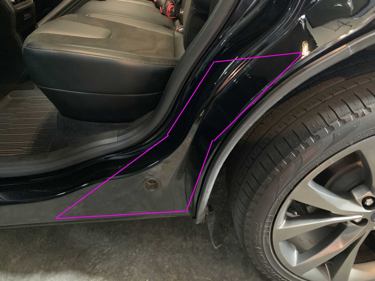

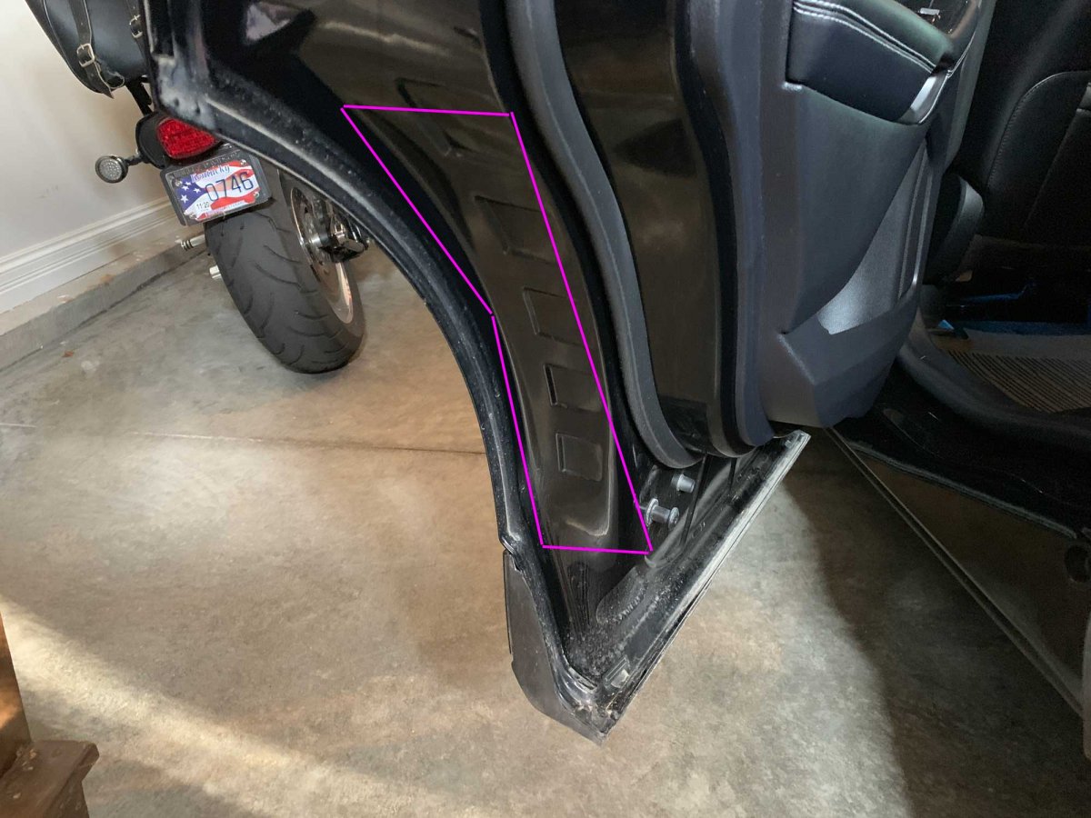

1004ron Posted July 24, 2019 Report Share Posted July 24, 2019 (edited) Just visualize that weatherstip coming off, and it'll be pretty obvious where the muddy water thrown off the wheel is going to go, the areas I've outlined. Also seen in the attached photos is the inner seal, and with that in tact there's no way water or debris, or noise is going to make its way inside. Edited July 24, 2019 by 1004ron 1 Quote Link to comment Share on other sites More sharing options...
