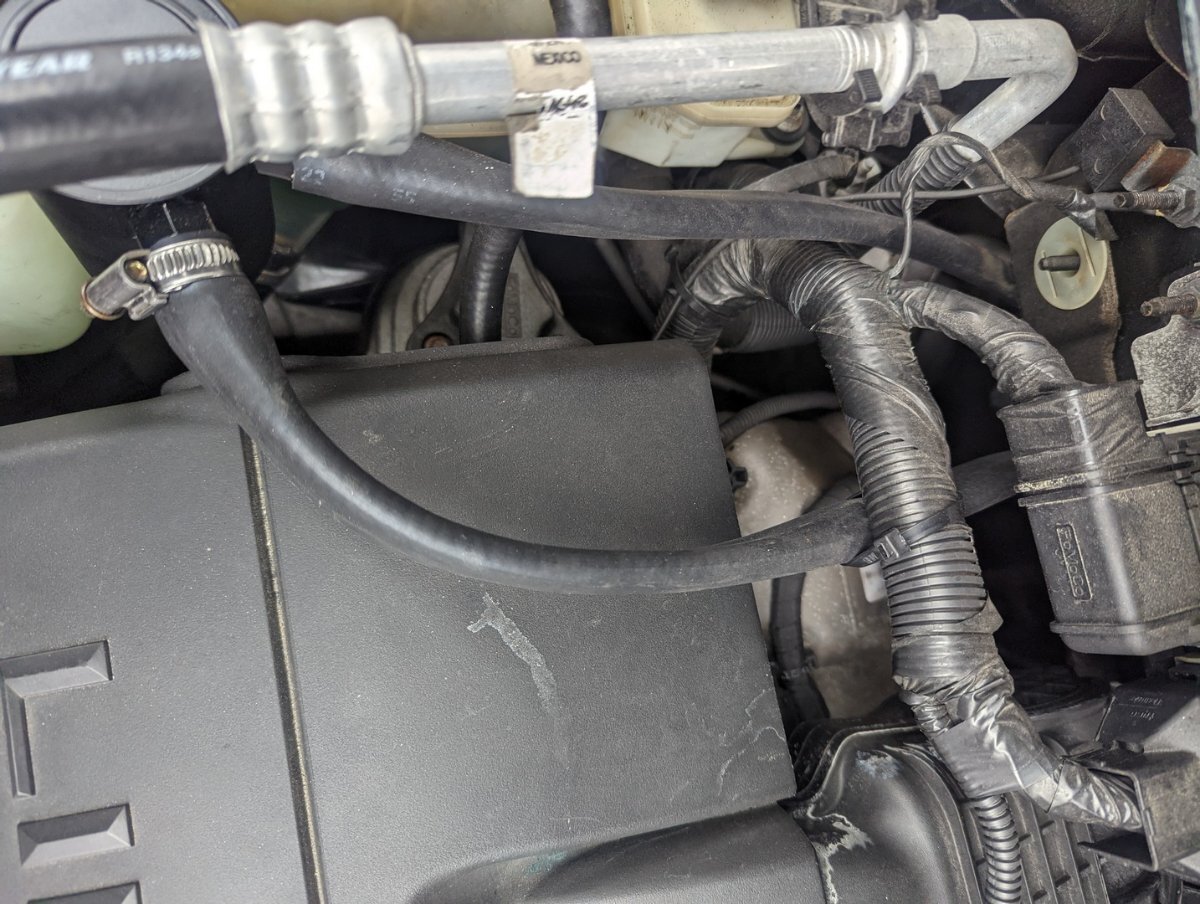

NzP Posted yesterday at 01:21 AM Report Share Posted yesterday at 01:21 AM (edited) So I installed an oil catch can approximately 400+ miles ago. I've got a table spoon of s*it in it since then. And just today I open the hood showing it to my friend with engine running I noticed that rubber hoses almost flat(engine runs just fine, no codes). So I think should I replace those rubber hoses with a plastic tube or just keep like that if it has been running 400+ miles with no problems? Edited yesterday at 01:22 AM by NzP 2 Quote Link to comment Share on other sites More sharing options...
1004ron Posted 22 hours ago Report Share Posted 22 hours ago That's what happens if you go with the el-cheapo catch can and its hoses. Quote Link to comment Share on other sites More sharing options...
NzP Posted 21 hours ago Report Share Posted 21 hours ago (edited) what's the problem u think? the filter inside the can doesn't allow enough air go trough? The hoses are pretty thick, but they are regular, like a heater core hoses. So why it works flawlessly then and does its job? If it works fine for 400+ miles - do u think is there any danger for the engine? Edited 21 hours ago by NzP Quote Link to comment Share on other sites More sharing options...
1004ron Posted 18 hours ago Report Share Posted 18 hours ago Your best option is to buy the catch can kit from a reputable supplier which includes hoses with the appropriate specification. I expect that the correct hoses don't only meet temperature and pressure requirement but also a vacuum specification. Ex. High-Temperature Vacuum-Rated Coolant Hose 1 Quote Link to comment Share on other sites More sharing options...
1004ron Posted 18 hours ago Report Share Posted 18 hours ago Universal Catch Can Hose 3/4" x 4' | Mishimoto PCV/Fuel Rubber Hose, By The Foot Hose & Tubing | Damond Motorsports 2 Quote Link to comment Share on other sites More sharing options...
