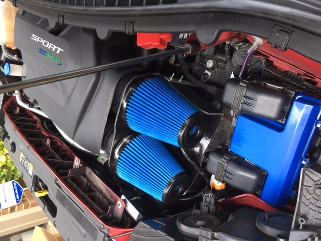

LivingOnTheEdge247 Posted May 13, 2018 Report Share Posted May 13, 2018 Anyone try out this new Intake from Steeda for the 2017-2018 Ford Fusion Sport 2.7? https://www.steeda.com/steeda-fusion-twin-turbo-cold-air-kit From the images it looks like either it would fit or fit with small adjustments. I am thinking of purchasing this unit it and making it work. Thought I'd get your thoughts first. https://www.steeda.com/thumbnail.asp?file=assets/images/555-3214-1.jpg&maxx=1500&maxy=1000 https://www.steeda.com/thumbnail.asp?file=assets/images/555-3214_6_.jpg&maxx=1500&maxy=1000 Quote Link to comment Share on other sites More sharing options...
037 Posted May 14, 2018 Report Share Posted May 14, 2018 2 members of my FB group tried it and performance was worse than factory box. 1 Quote Link to comment Share on other sites More sharing options...
Nick Halstead Posted May 14, 2018 Report Share Posted May 14, 2018 it's made by steeda, thats enough reason not to purchase it. but as 037 said, it doesn't fit and doesn't seal on the EDGE, which makes it suck in more hot air than oem does. Quote Link to comment Share on other sites More sharing options...
midair Posted June 26, 2018 Report Share Posted June 26, 2018 (edited) I obtained the Steeda 2.7 intake from a friend who's Fusion GT was totaled, .. never got a chance too install it. He gave it too me. I have a 2015 Sport FWD. Yes the box dont fit in stock. We cut the box away too use as a mound and took measurements, made one simple bracket. Laying up a new box from 6 oz carbon fiber & System 3 resin. Once we have it completed, we'll fit the seal up tight. Looks good, sound nice.. Edited June 26, 2018 by midair Quote Link to comment Share on other sites More sharing options...

Special_K Posted July 2, 2018 Report Share Posted July 2, 2018 ops so i would like to see logs from this setup and some flow numbers 1 Quote Link to comment Share on other sites More sharing options...
Nick Halstead Posted July 5, 2018 Report Share Posted July 5, 2018 Extremely hot air thats what the log is goong to show and pretty quick heat soaking! Quote Link to comment Share on other sites More sharing options...
