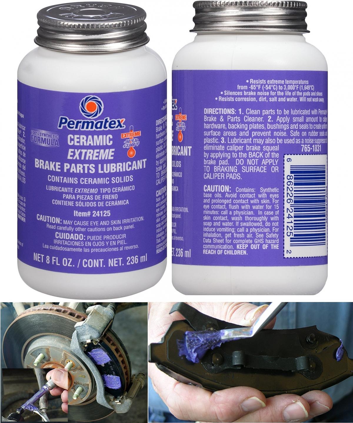

Permatex Ceramic Extreme Brake Parts Lubricant (already had a large bottle I've been using for years don't remember cost) but I learned the hard way that standard stuff like Permatex Ultra caliper lube can't take the extreme heat (Motorhome going down 8% grade lessons).

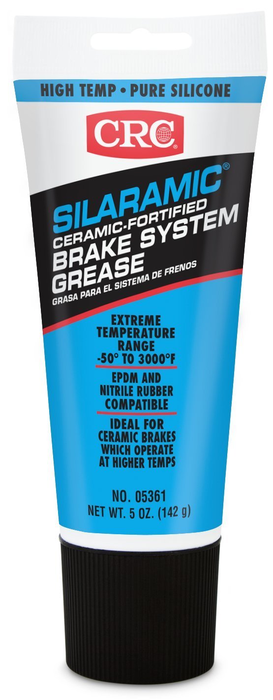

8 oz of the Permatex is about 16$ and 5 oz of the CRC is about $18 right now on Amazon. Permatex is slightly better at low temps (-65F vs -50F) but both protect to 3,000F.
In comparison, the Permatex Ultra
Temperature Range: -40°F to 400°F (-40° to 204°C)
