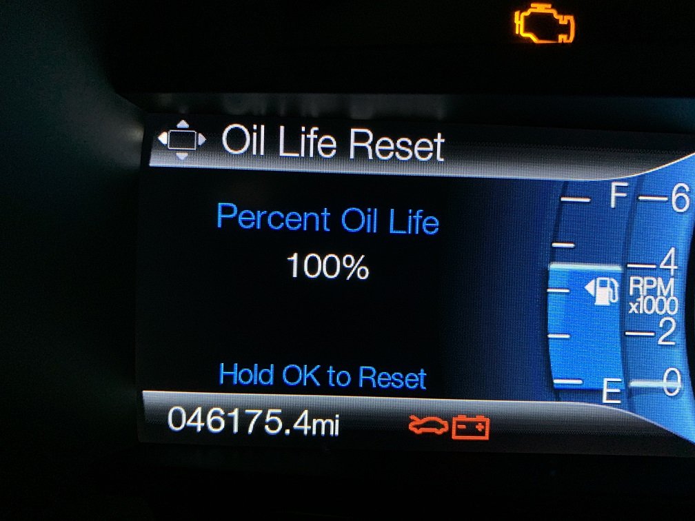

MICTIP Posted October 24, 2019 Report Share Posted October 24, 2019 My problem is a little different. I drive my 2013 Edge about 8,000mi a year but every 5-6 mos it tells me to change my oil. I use synthetic oil, which should last 10,000mi and I don't want to get rid of the good oil. Is there a way to not have this message appear so often? Quote Link to comment Share on other sites More sharing options...
WWWPerfA_ZN0W Posted October 25, 2019 Report Share Posted October 25, 2019 Using strictly miles to determine oil change time is a fallacy. It is very dependent on the nature of the miles - highway, mixed, city. You drive less than the average driver in the U.S., almost 50% less, and sounds like either mixed or city conditions are a significant portion of those miles. Engine hours (use Trip 2 to help track) is a much better way of correlating oil change warnings to actual need. Are you the original owner of the vehicle? You might want to check at what level the warning of remaining oil life is set. By default I think it is 10% but some are aggressive enough to change it to 50% due to either changing oil early, or knowing they won't go into the shop right after the warning pops up, etc. Oil is cheap compared to a new engine, or having to replace the water pump/timing system parts. Don't worry too much, use only full synthetic. 2 Quote Link to comment Share on other sites More sharing options...
1004ron Posted October 25, 2019 Report Share Posted October 25, 2019 (edited) On 10/25/2019 at 7:05 AM, WWWPerfA_ZN0W said: Are you the original owner of the vehicle? You might want to check at what level the warning of remaining oil life is set. By default I think it is 10% but some are aggressive enough to change it to 50% due to either changing oil early, or knowing they won't go into the shop right after the warning pops up, etc. Not sure I'm reading that correctly, but how do I go about changing the service due alert to 50% ? Edited October 26, 2019 by 1004ron 1 Quote Link to comment Share on other sites More sharing options...
onyxbfly Posted October 25, 2019 Report Share Posted October 25, 2019 51 minutes ago, 1004ron said: Not sure I'm reading that correctly, but how do I go about changing the service due alert to 50% ? No you read it correctly. Just like you I do not see an easy way to change the IOLM service alert. 1 Quote Link to comment Share on other sites More sharing options...
WWWPerfA_ZN0W Posted October 26, 2019 Report Share Posted October 26, 2019 (edited) It may not allow you to do this in the base cluster, but in the advanced cluster, under Settings/Vehicle Settings, Vehicle, Oil Life Reset, you can set the desired % for the light to come on. EDIT: Base cluster - go into Settings, Convenience, Oil Life Reset. Edited October 26, 2019 by WWWPerfA_ZN0W 1 Quote Link to comment Share on other sites More sharing options...
onyxbfly Posted October 26, 2019 Report Share Posted October 26, 2019 4 minutes ago, WWWPerfA_ZN0W said: It may not allow you to do this in the base cluster, but in the advanced cluster, under Settings/Vehicle Settings, Vehicle, Oil Life Reset, you can set the desired % for the light to come on. EDIT: Base cluster - go into Settings, Convenience, Oil Life Reset. Thanks for the info PerfA, I'm going to take a look at it as soon as I take a lunch break! 1 Quote Link to comment Share on other sites More sharing options...
1004ron Posted October 26, 2019 Report Share Posted October 26, 2019 16 minutes ago, WWWPerfA_ZN0W said: It may not allow you to do this in the base cluster, but in the advanced cluster, under Settings/Vehicle Settings, Vehicle, Oil Life Reset, you can set the desired % for the light to come on. EDIT: Base cluster - go into Settings, Convenience, Oil Life Reset. Thanks, but no such option on my 2017 Sport. 1 Quote Link to comment Share on other sites More sharing options...
