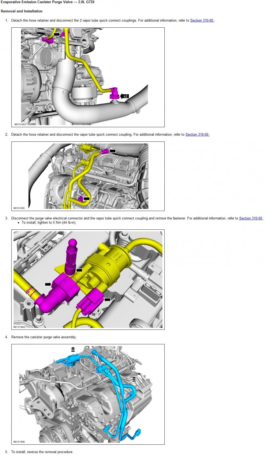

jjerisk Posted April 24, 2018 Report Share Posted April 24, 2018 Hello everyone, Last week I have a Code ( check engine light come up) on my 2012 Ford edge SEL. I have 2.0 eco boost. I went to auto zone and the code that was read stated I need a canister purge valve. I bought the valve on rock auto. Today I tried to install this & I looked all over online and within my engine. I can not find where to install this thing. ANY HELP?????? I have attached the picture on the canister purge valve I have bought. Thanks, Joe Quote Link to comment Share on other sites More sharing options...

WWWPerfA_ZN0W Posted April 24, 2018 Report Share Posted April 24, 2018 Should be on top of the valve cover, after you remove the engine appearance cover. Trace it back from the hose shown in the first diagram. Of course Ford shows it as an assembly, so ... 2 Quote Link to comment Share on other sites More sharing options...

WWWPerfA_ZN0W Posted May 2, 2018 Report Share Posted May 2, 2018 TBH, I could not begin to tell you. Ford simply refers to these bundles as hose assemblies and it is up to you to guess if it is the right one. A trip to the dealer is in order, I think. Take pics of the part in question so they can identify it easier. Look for stamped part numbers on the hoses and components. Quote Link to comment Share on other sites More sharing options...
