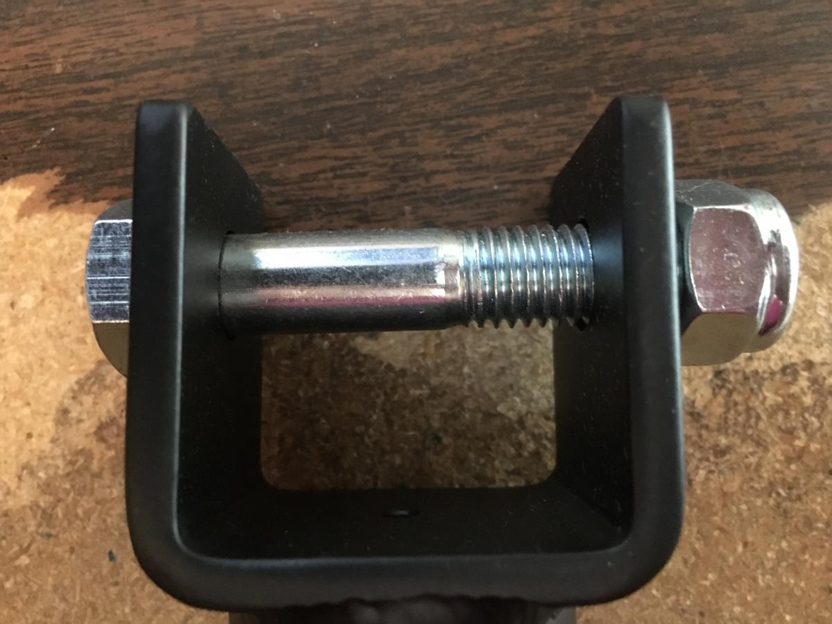

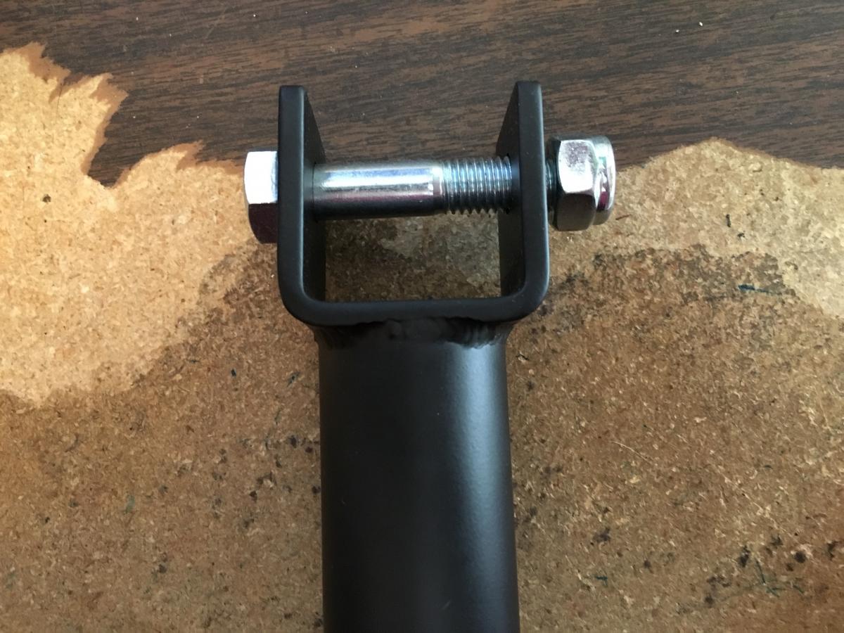

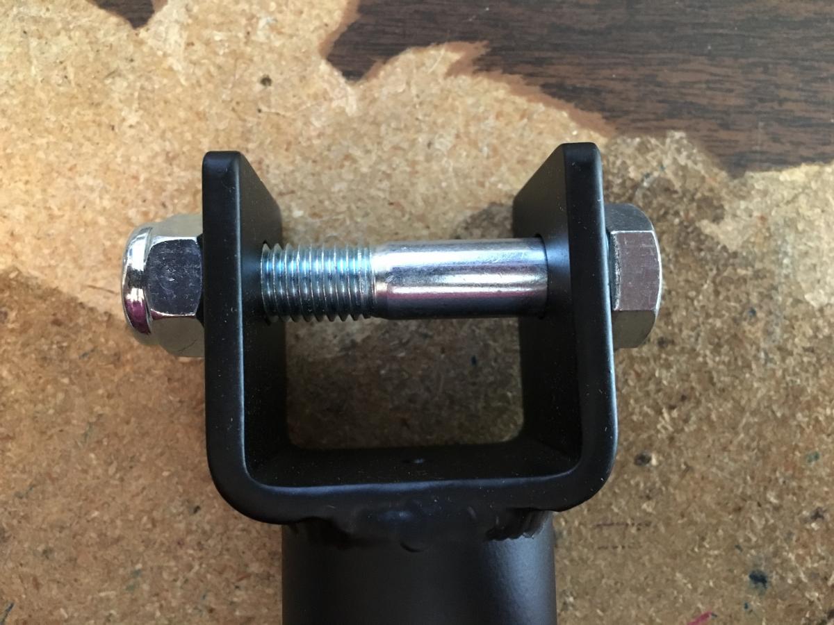

Mikula Posted April 22, 2018 Report Share Posted April 22, 2018 So I ordered the RMM from ultimate performance, and.. well.. I'm disappointed. Maybe I'm a perfectionist. Being a fabricator and welder has made look at things differently over the years. The bends are not 90* (hard to tell in the photo, one is 4* over bent, the other side is 1* under bent) and the holes are not in line for the bolt to go through. From end of bracket to center of hole is .051" different on each side. Just not what I would have expected quality wise. Since the holes don't line up, it seems it will put things in a bind under load,which is the opposite of what I'm going for here. My question is, has anyone else bought one that looks like this? I'm sending mine back regardless, as I expected better quality for that kind of cost. If this is a one off mistake, I'll have them send replacement, otherwise I'll be finding something else to put under there that is better. 1 Quote Link to comment Share on other sites More sharing options...

Mikula Posted April 23, 2018 Author Report Share Posted April 23, 2018 (edited) On 4/23/2018 at 9:20 PM, Xtra said: Mine is fine looks like you did get a bad one and they need to watch their quality control. I was told the durometer was a 73 and they would double check that and get back to me but never did. Perhaps it is off by only a few thousand's it shoutd be with in tolerances, it could be better as well. RMM.JPG RMM-2.JPG RMM-3.JPG Maybe my eyes are crossed, it looks like your bolt/holes are not perpendicular either. the bolt sits at a slight angle. When I measured mine, they are almost 1/16" off. I would imagine he builds these in a jig, so I'm guessing the jig is off. amazing that he hasn't noticed. From top of bracket, to top of hole, on each side should be identical. Mine are not. Edited April 23, 2018 by Mikula Quote Link to comment Share on other sites More sharing options...
Mikula Posted April 23, 2018 Author Report Share Posted April 23, 2018 They are sending a replacement, and his email literally said "hmm, maybe it got damaged during shipping" Apparently he thinks I'm an idiot. I didn't know shipping companies could drill holes off center like that! 2 Quote Link to comment Share on other sites More sharing options...

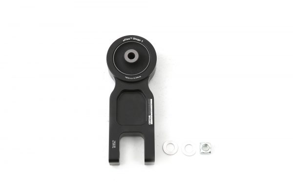

onyxbfly Posted April 26, 2018 Report Share Posted April 26, 2018 https://cp-e.com/shop/product/ford-fusion-sport-xflex-rear-motor-mount/ Quote Link to comment Share on other sites More sharing options...
