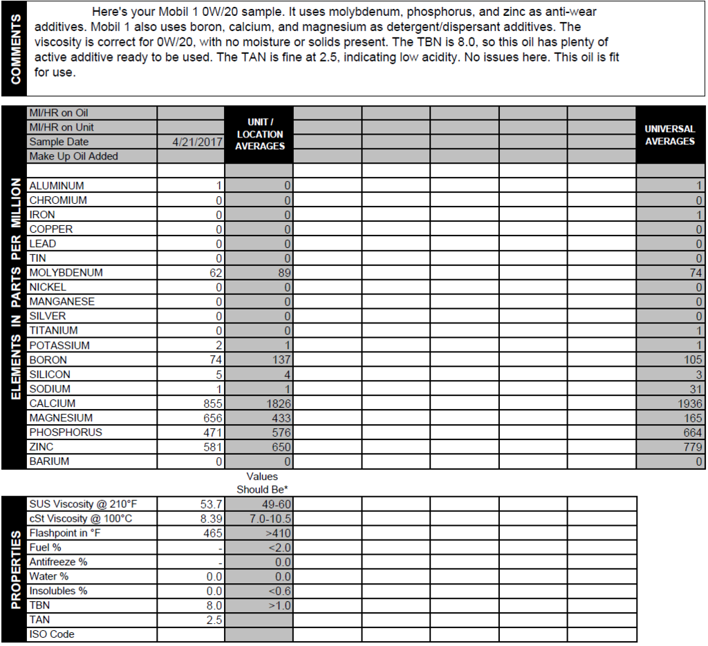

WWWPerfA_ZN0W Posted September 13, 2018 Report Share Posted September 13, 2018 (edited) they seem to be using stronger base stocks with the AP product, but the lack of antiwear additives compared to their regular Mobil1 and Mobil1 EP is surprising. https://bobistheoilguy.com/forums/ubbthreads.php/topics/4389559/mobil-1-0w-20-annual-protection-voa-tbn-tan Granted this is 5w20 data, but you can see it at mactgarage.com under the Oil Analysis section. https://docs.google.com/spreadsheets/d/1oTuPwZHKoSqFLClaZrBhMh9D5vpX0VhLZrmVdLyFnbE/edit#gid=1379600026 Test of 5W30 AP by PQIA back in March shows it in a better light http://www.pqiadata.org/Mobil1_Annual_Protection_5W30.html Edited September 13, 2018 by WWWPerfA_ZN0W Quote Link to comment Share on other sites More sharing options...
tk2fast Posted September 13, 2018 Report Share Posted September 13, 2018 (edited) Quite interesting. Also would have liked to see mactgarage.com include Amsoil in his analysis. Surprising is the top oil in mactgarage.com, Red Line Synthetic which has a high amount of calcium. We know that calcium is one of the most effective additives for cleanliness and wear protection but also contribute to low speed pre-ignition events (LSPI). I understand that there are quite a few factors that influence LSPI, but again, Red Line receiving top dog rating especially with a $12 price tag per qt is surprising. Edited September 14, 2018 by tk2fast Quote Link to comment Share on other sites More sharing options...
WWWPerfA_ZN0W Posted September 14, 2018 Report Share Posted September 14, 2018 Can only test what the budget allows LOL. Just to get Amsoil, you have to jump through hoops if there are no local distributors. You can see samples of UOA from Amsoil 0W20 on the site on both his Edges. LSPI knowledge is still in flux. But yes, additives, not only in oil but gasoline as well, contribute to it. It is also a forced induction-only issue, and many engines out there are still naturally aspirated. Redline performs quite well also in the field per the UOAs. In addition to significant antiwear properties, which outstrip even the current Amsoil formulations. This is a whole nother debate, but you will see additives being removed in European formulations, and the service intervals being shortened at the same time. Just can't have your cake and eat it too, I guess. American formulations are moving in the same direction. 1 Quote Link to comment Share on other sites More sharing options...
