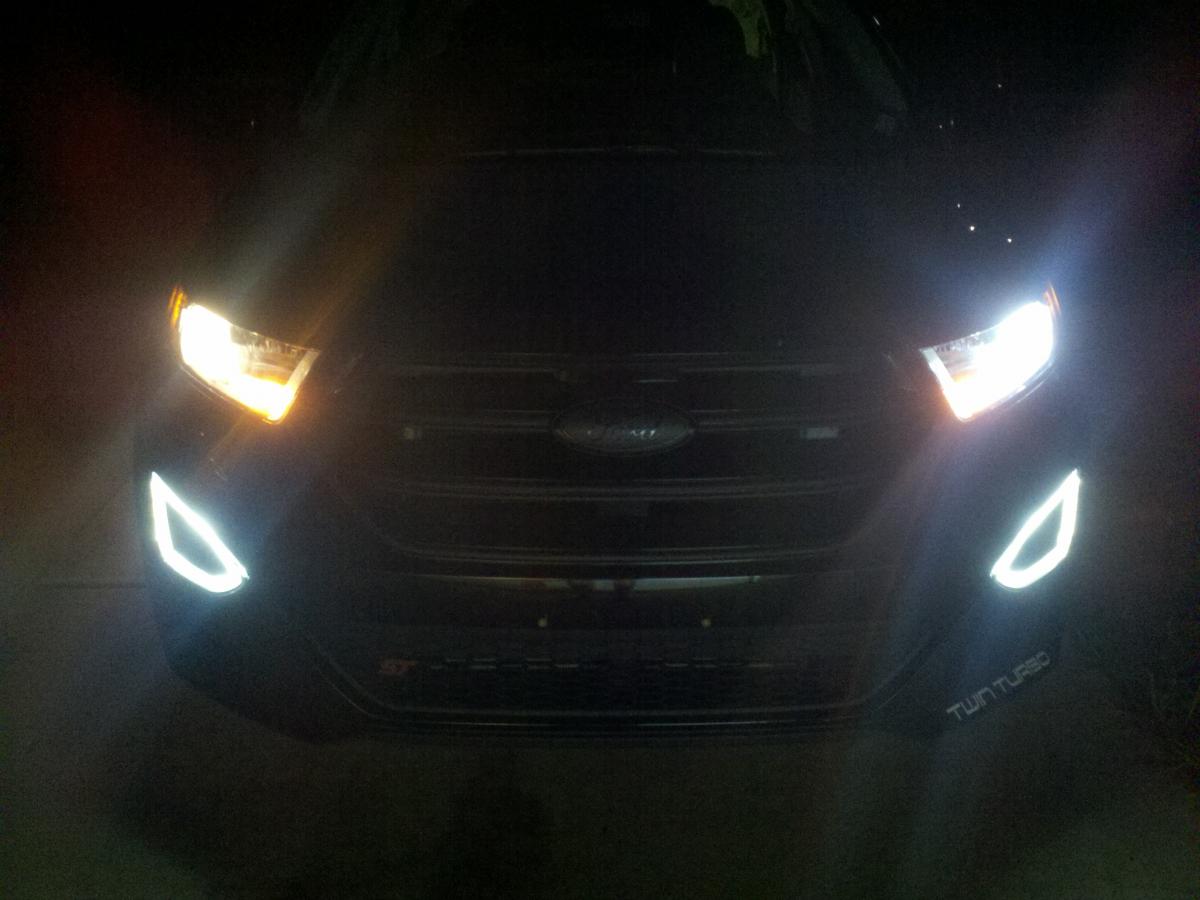

Mikula Posted April 29, 2018 Author Report Share Posted April 29, 2018 I was looking at 35 watt 5000k. But then I keep thinking 6000k would be better. That’s why I can’t decide. I definitely don’t want blue lights. If you go by the pics on web sight the 5k is good. I installed the 6000k today. it is a damn close match. They take a second to warm up apparently. when I first fired them up, they were a bit blue, and I was quite disappointed. by the time i went in to the house to get the wife and show her, they looked spot on. really REALLY happy with them. I'm going to post a "how to" tomorrow. I found a nice little spot to hide everything, and a few tricks along the way. 1 Quote Link to comment Share on other sites More sharing options...

Mikula Posted April 29, 2018 Author Report Share Posted April 29, 2018 Here is a few pics. you can clearly see which one is the HID... 1 Quote Link to comment Share on other sites More sharing options...
