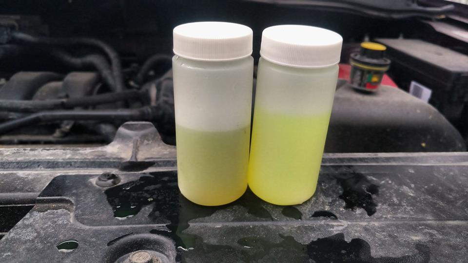

Alright, my first oil change I am checking the PTU oil and maybe maybe changing the anti-freeze. The new stuff they use is supposed to be not corrosive at all. Ive seen too many car guy that really know their stuff and do their own maintenance always having problems and parts wearing quickly for them. Seems like they might change things or get involved sooner then they need to. I try to avoid that.
Edited by sgkukov
Check with your local Service MANAGER before going with the latest OAT coolant.
Reason is, Ford specifically engineered the newer motors to have special blade geometry and a slower spin so that less cavitation is caused in the coolant circuit. (Cavitation is what causes a lot of pitting in the cooling systems).
He can advise what's best for your specific engine & year. If you decide to change coolant type, follow the Ford recommandations and do a proper and thorough flush. Mixing green and orange can cause a silica compound (basically sand and other nasty stuff) to fall out of solution. This is what will kill your engine and clog your coolant passage ways.
Believe there's a procedure out on this (is for my 09). Anyways, Service Manager can advise proper process. Quite involved.
2013 can use Motorcraft Orange coolant. You can use aftermarket universal extended life that has been used in place of the Motorcraft Gold and Green coolants, but I have a sneaking/unconfirmed suspicion that the Dex-Cool extended life coolants might be an even better fit for your Edge.
It is advisable to completely flush out the old coolant before adding in new coolant, especially when changing brands. They may meet the spec, but do not have to arrive at it the same way. Due to the unknowns in how the chemistry might interact, purge the old before installing the new. Keeps the engine healthier in the long run. If its a topoff issue, I would rather just use a little distilled water than mix coolants. Keep a jug of distilled water in your emergency supplies. A dealership can even top it off for you with MC coolant if you are able to get your Edge there in time. No need to buy a full jug just to have it laying around.
