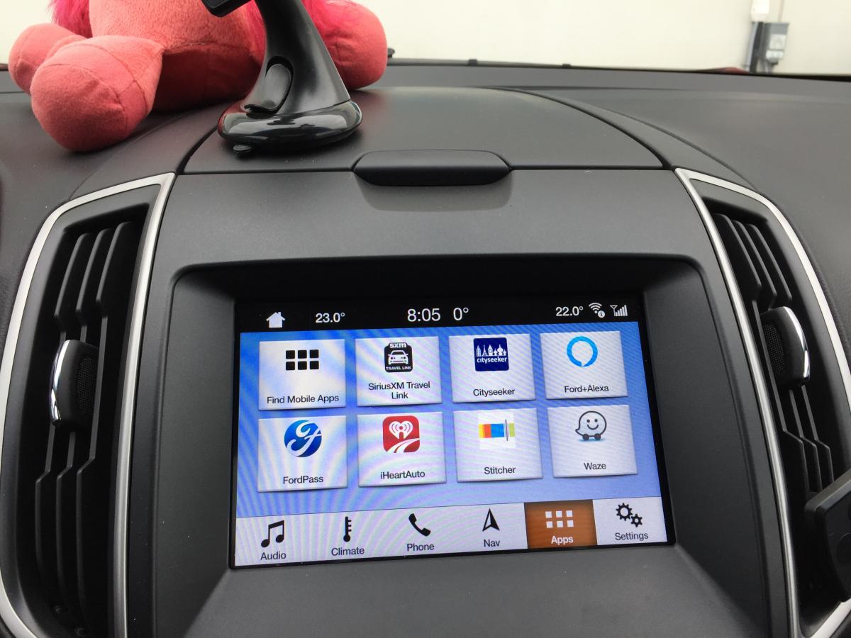

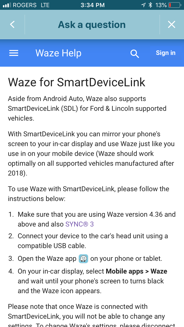

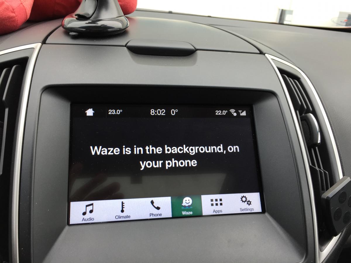

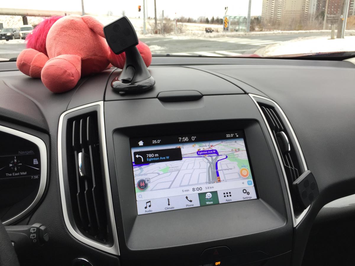

almun Posted April 19, 2018 Report Share Posted April 19, 2018 check this out: Quote Link to comment Share on other sites More sharing options...

FordGuy1 Posted April 20, 2018 Report Share Posted April 20, 2018 Tried Waze last night on a drive home and it worked ok. I noticed that the display showing were your vehicle is located is shifted off center to the right. I thought this was because of transfering to the Ford screen but then when I got home and disconnected my phone I found out that Waze in landscape mode on the phone is off centered, hope Waze fixes this. See "Almun" third picture in above post, it shows the off center display. Quote Link to comment Share on other sites More sharing options...
jwm22222 Posted April 20, 2018 Report Share Posted April 20, 2018 (edited) After messing with it for a bit, got it to work for me in my 2016 Edge. I love that we have this option. A few things I noticed though. 1). Screen seems to be very low contrast for some reason. 2). If you turn off phone (lock screen) map freezes. You have to keep waze app active and phone on at all times. 3). Kind of glitchy. Freezes up every now and then. 4) Waze icon appears on left panel in main screen but no map. Have to be on full screen Nav to work. Edited April 20, 2018 by jwm22222 Quote Link to comment Share on other sites More sharing options...
vwlfan Posted April 20, 2018 Report Share Posted April 20, 2018 Tried Waze last night on a drive home and it worked ok. I noticed that the display showing were your vehicle is located is shifted off center to the right. I thought this was because of transfering to the Ford screen but then when I got home and disconnected my phone I found out that Waze in landscape mode on the phone is off centered, hope Waze fixes this. See "Almun" third picture in above post, it shows the off center display. I see the same off-center screen. I used the WAZE app on my phone to send a support/feedback request to Waze. Quote Link to comment Share on other sites More sharing options...
jwm22222 Posted April 20, 2018 Report Share Posted April 20, 2018 I see the same off-center screen. I used the WAZE app on my phone to send a support/feedback request to Waze. My sense was that this was intentional as turning directions are on left hand side pushing main path to the right to give a better view. Quote Link to comment Share on other sites More sharing options...

FordGuy1 Posted April 26, 2018 Report Share Posted April 26, 2018 Interesting thing on the off-center display. Yesterday I was driving with WAZE running for directions and it had the off-center display with the large black rectangle directions on the left side about centered. I pulled into a gas station and turned off the vehicle without disconnecting or changing the iPhone connection. When I restarted the vehicle WAZE started back up and resume its directions but the display was now centered and the black rectangle directions as smaller in height and at the top of the map display. The directions were readable and the display was exactly the way I would want it. The next time I turned off the vehicle and restarted the display was again off-centered but the black rectangle was still smaller in height but now it was down a little from the top of the map display. It seems that either Ford or WAZE have a few different display selections which would be fine if we could select the one we want and keep it that way. Anyone else experience this? Quote Link to comment Share on other sites More sharing options...
