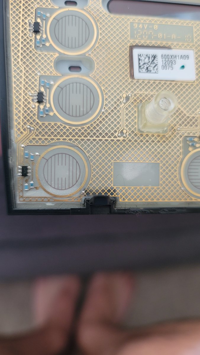

Devo33 Posted July 10, 2022 Report Share Posted July 10, 2022 (edited) I had this problem and going with the theory that the air in between the plastic that covers the round pad censors on the FICM, was causing it to read being pushed up or down. I took a heat gun to the pads and kind of melted it back in place. It works great now! Hope this helps everyone out. Edited July 10, 2022 by Devo33 5 1 Quote Link to comment Share on other sites More sharing options...
techwriter1009 Posted July 12, 2022 Report Share Posted July 12, 2022 On 7/10/2022 at 2:43 PM, Devo33 said: I had this problem and going with the theory that the air in between the plastic that covers the round pad censors on the FICM, was causing it to read being pushed up or down. I took a heat gun to the pads and kind of melted it back in place. It works great now! Hope this helps everyone out. My husband did what you did and it fixed the problem! thank you! Quote Link to comment Share on other sites More sharing options...
stevebrain Posted July 15, 2022 Report Share Posted July 15, 2022 On 7/10/2022 at 11:43 AM, Devo33 said: I had this problem and going with the theory that the air in between the plastic that covers the round pad censors on the FICM, was causing it to read being pushed up or down. I took a heat gun to the pads and kind of melted it back in place. It works great now! Hope this helps everyone out. Did you remove the panel first and apply the heat to the actual switch, or did you leave the panel on and apply the heat directly to the face of the panel? Quote Link to comment Share on other sites More sharing options...
stevebrain Posted July 15, 2022 Report Share Posted July 15, 2022 On 7/11/2022 at 6:07 PM, techwriter1009 said: My husband did what you did and it fixed the problem! thank you! Did you remove the panel first and apply the heat to the actual switch, or did you leave the panel on and apply the heat directly to the face of the panel? Quote Link to comment Share on other sites More sharing options...
