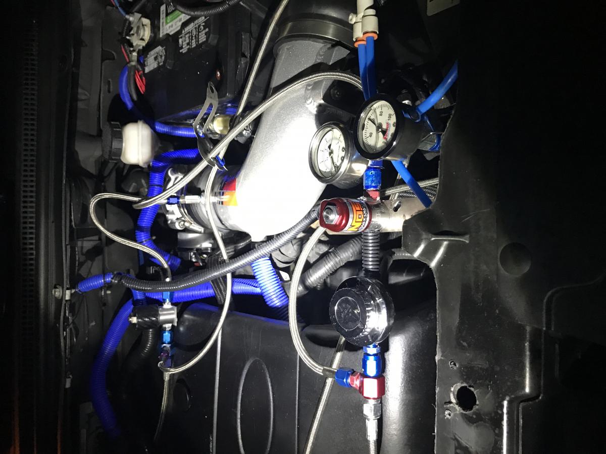

NOS_Edge Posted March 12, 2018 Author Report Share Posted March 12, 2018 Thank you, Im only running a 75 wet shot, I use occasionally but my street tune is my main thing I use from my SCT X4 1 Quote Link to comment Share on other sites More sharing options...

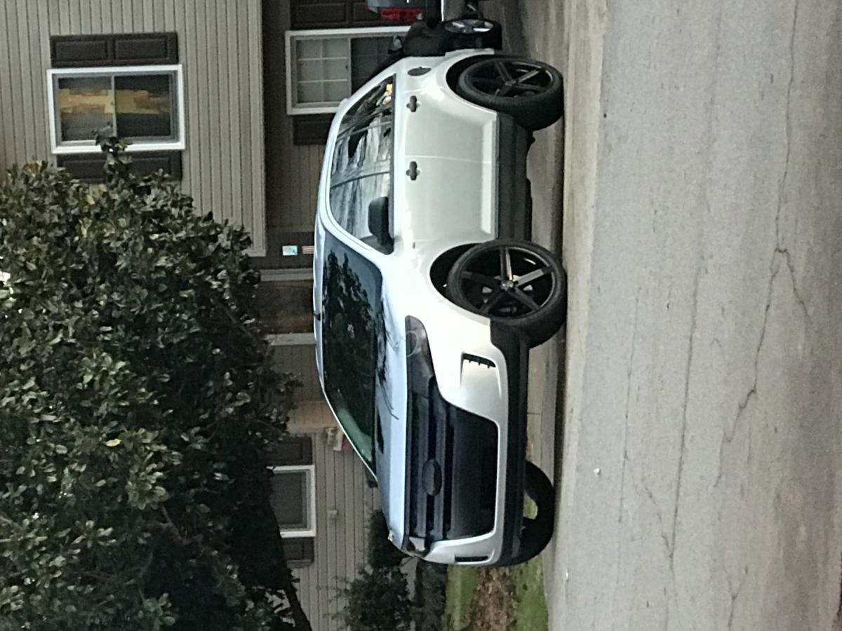

NOS_Edge Posted March 12, 2018 Author Report Share Posted March 12, 2018 (edited) Thanks, Im running 245/60/22 Perellis and versantie rims. I had the motor Dyno tuned actually with my SCT X4 tuner and I have a street program I run daily which gives me an out right 325HP and 295 max torque. I have a Nitrous program I run which retards my timing -4 degrees when running my 75 wet shot. Basically all my engine mods have been a pain in the ass cause their is little to no aftermarket parts for an edge and everything I get is Integrated for my 3.5 L Mustang, focus or fusion Edited March 13, 2018 by NOS_Edge 1 Quote Link to comment Share on other sites More sharing options...

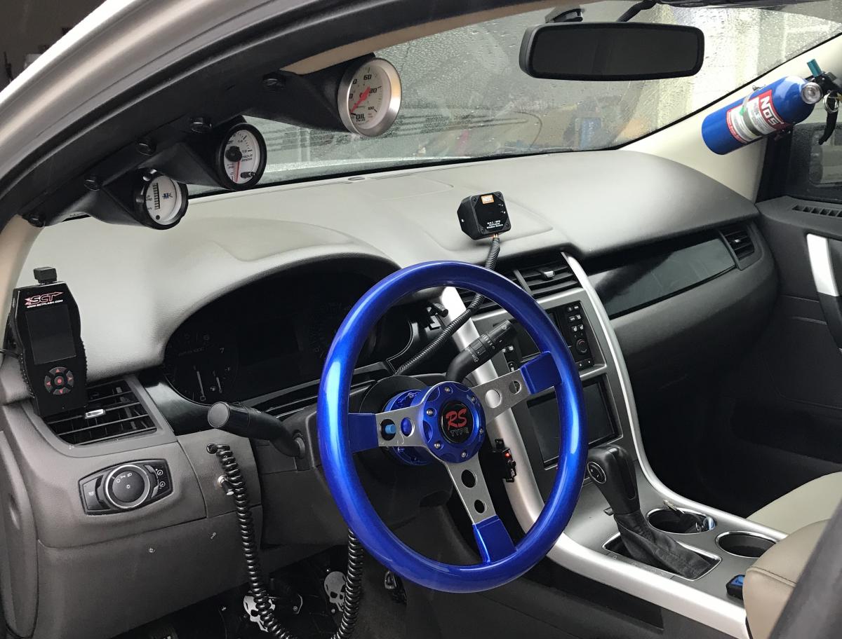

NOS_Edge Posted March 12, 2018 Author Report Share Posted March 12, 2018 I like your pillar pods, can you give any info on them? I want to instal Nguage on the pillar Any. Pillar pods will work the key is to get a heat gun and while the edges are soft form them with the pillar of your car once they are formed use the screw button caps to secure them as you can see in my posted pic if you zoom in unless you wanna go the extra mile and screw them down, use body filler....sand and paint them 1 Quote Link to comment Share on other sites More sharing options...
