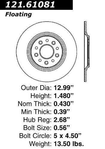

WWWPerfA_ZN0W Posted March 7, 2018 Report Share Posted March 7, 2018 (edited) 2011 on do not use the brake drum/shoes emergency setup. Just the plain ole rotor & caliper. I believe to compensate, the rear rotors are the same size as the fronts. EDIT: Rear is a bit LARGER than front!!! FRONT https://centricparts.centriccatalog.com/Inquiry/PartInt.aspx?pn=120.61090&id=WEB_DISC&v=LD&y=2014&m=54&mm=5858&uid=ANR&sid=0 REAR https://centricparts.centriccatalog.com/Inquiry/PartInt.aspx?pn=120.61081&id=WEB_DISC&v=LD&y=2014&m=54&mm=5858&uid=ANR&sid=0 Edited March 7, 2018 by WWWPerfA_ZN0W 1 Quote Link to comment Share on other sites More sharing options...
