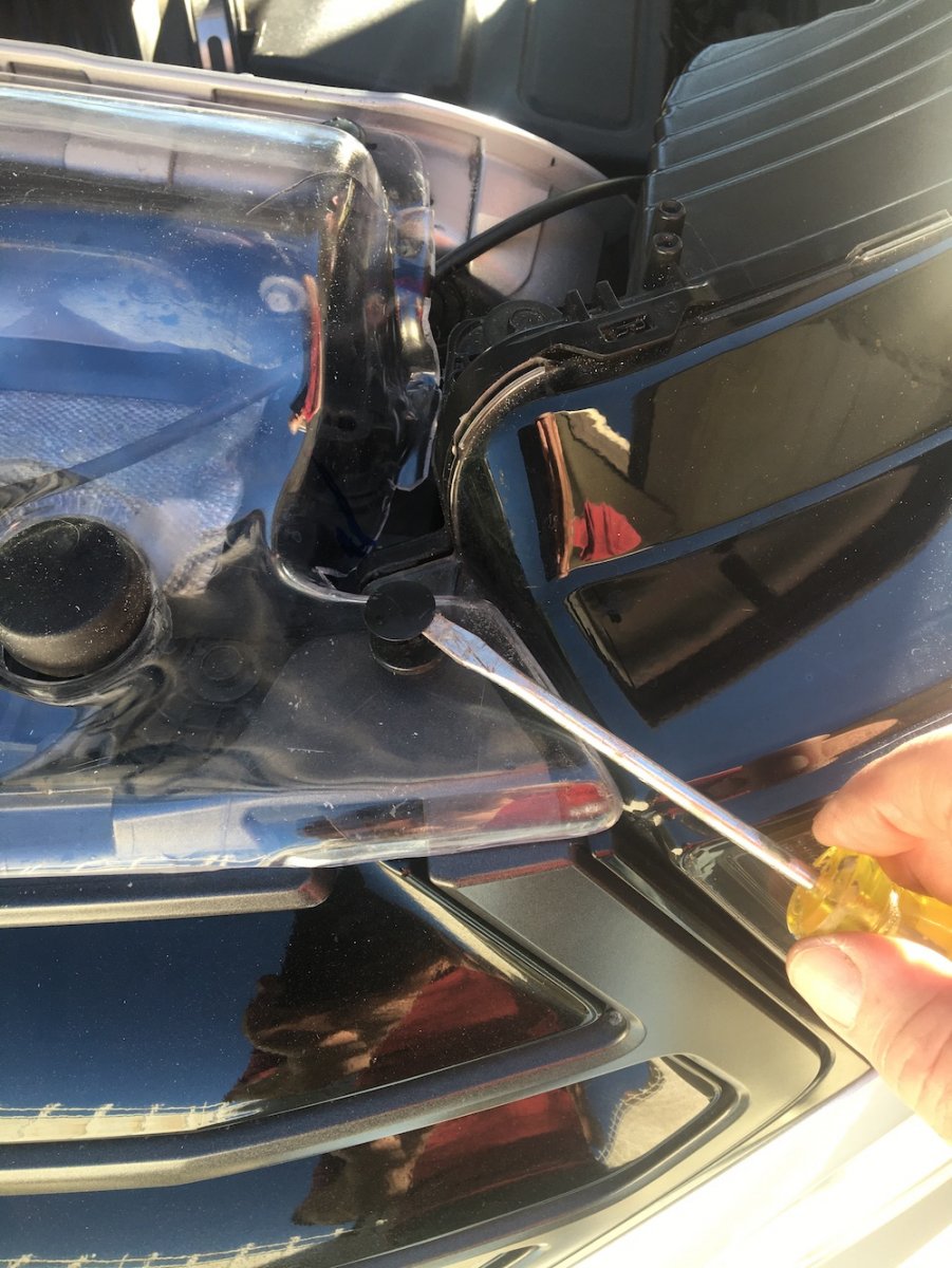

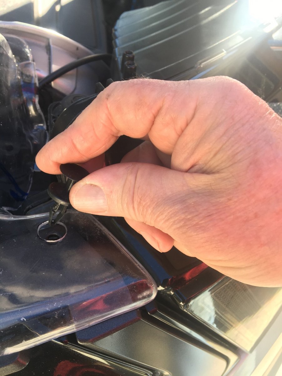

To remove the rivet clips:
1.   Lift up the top center part of of the clip with a screwdriver or butter knife.
2-  Remove both parts of the clip.
That's it, super easy.
To re-install them just reverse the process.

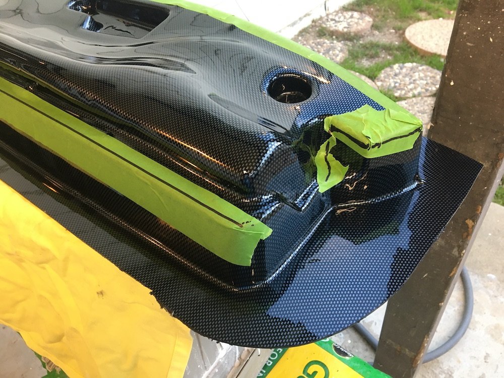

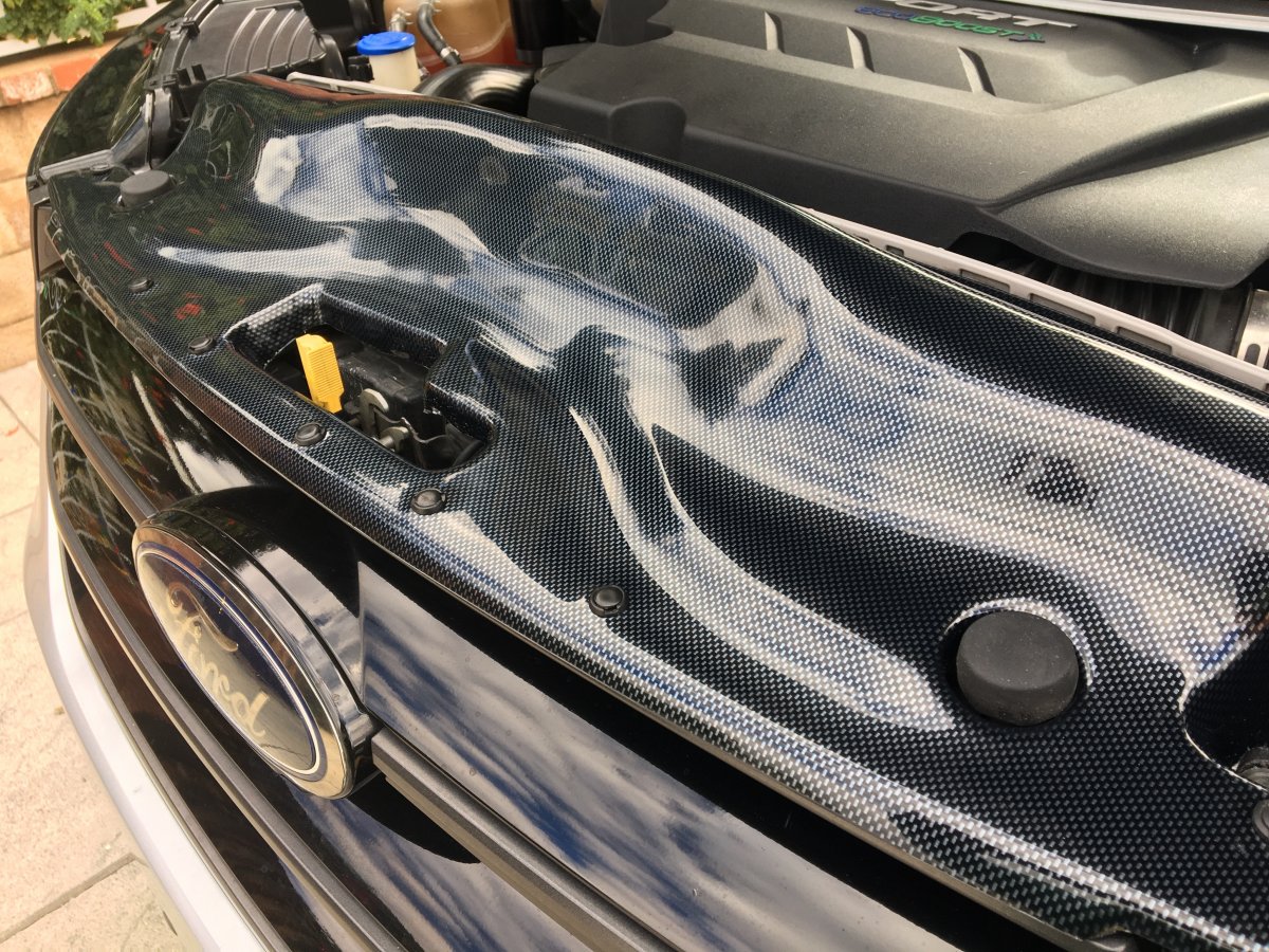

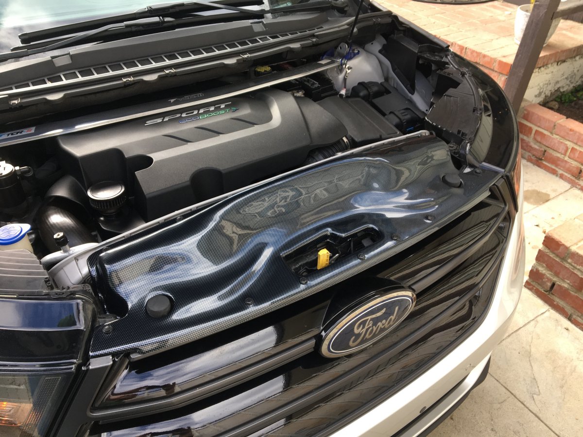

I just picked up the Carbon CAI and it is awesome :happyfeet:.  It worked great with the mold and passed muster with flying colors. The guys are the shop were amazed at how good it looks and the overall results, they had never seen any material like it. It has even exceeded my expectations. This is not a solid carbon fiber piece. According to the manufacture it is a composite of thermoplastic and carbon with a clear gloss top.
Edited by Xtra
Finally, The carbon has been tested, molded, trimmed, and installed. The holes line up much better now that have I moved the marker screws in the mold. Not all the holes are absolutely perfectly centered, but they are within tolerance, and the rivet clips fit as designed. I did have to find longer rivet clips because the intake sits up a bit higher than stock. It is only the front five holes that are affected by this, the rest of the stock clips can be reused. I will include the longer clips with the intake, so no worries.
Edited by Xtra

Someone asked what doe's it do?
This intake takes fresh cool outside air from across the entire front of the grill and feeds it to the snorkel. The design reduces any restrictions caused by the low profile OEM sight shield and provides a  larger, smoother airflow. There is more space under the CAI than stock, and the air stays cooler as it is no longer forced tight against the top of the radiator. As speed increases air is forced into the CAI and the large volume of the intake acts as a manifold to feed the snorkel evenly as demands require. All these little things add up to make HP, and IMHO it also looks cool. :)
