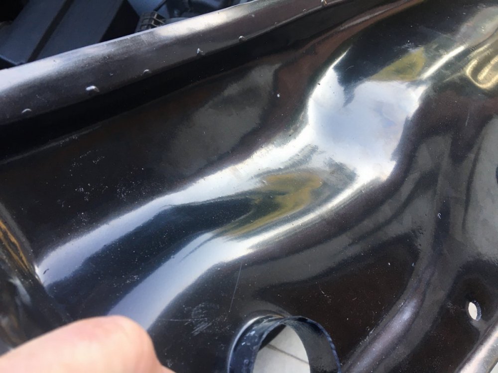

Xtra Posted December 7, 2020 Report Share Posted December 7, 2020 (edited) The carbon arrived one day early and It has a nice gloss finish. Now to test to see if it can be vacuum formed and is compatible with the mold. The plastic shop has never seen or worked with this type of composite material before. This is a very special material, it has a thermoformable plastic base with carbon fiber laminated to it, then a clear top layer is laminated over the carbon. # Bring the Bling! Edited December 7, 2020 by Xtra 3 Quote Link to comment Share on other sites More sharing options...

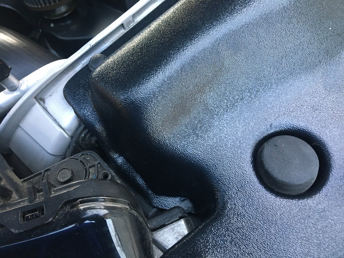

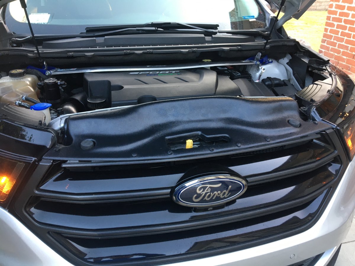

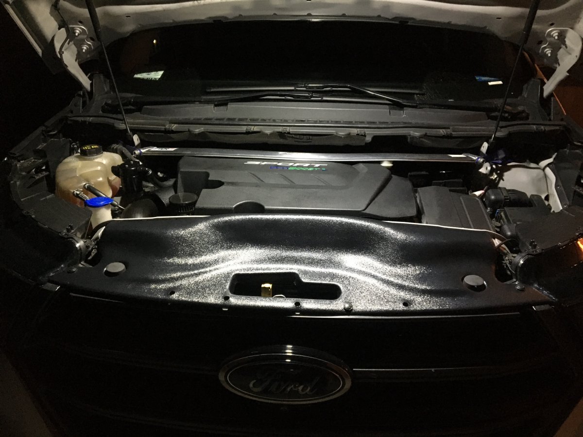

Xtra Posted December 11, 2020 Report Share Posted December 11, 2020 (edited) The first one in black, trimmed, drilled, and installed. Smooth on the inside for better air flow. Textured on the outside for looks. The first finished intake installed. finally. And the hood closes without any interference. ** Should have washed off the bird poop on the grill before I took the photo. LOL Edited December 11, 2020 by Xtra 1 1 Quote Link to comment Share on other sites More sharing options...

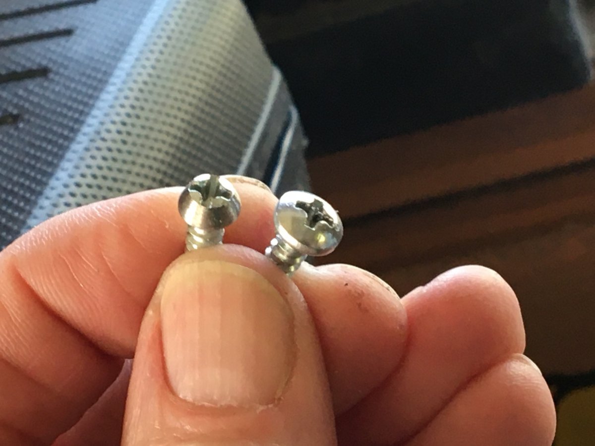

Xtra Posted December 11, 2020 Report Share Posted December 11, 2020 (edited) Spent the morning at the shop refining the mold. I turned down the screws on a lathe to 0.250 inches around and 0.1 tall, then reinstalled them. Edited December 11, 2020 by Xtra 1 Quote Link to comment Share on other sites More sharing options...

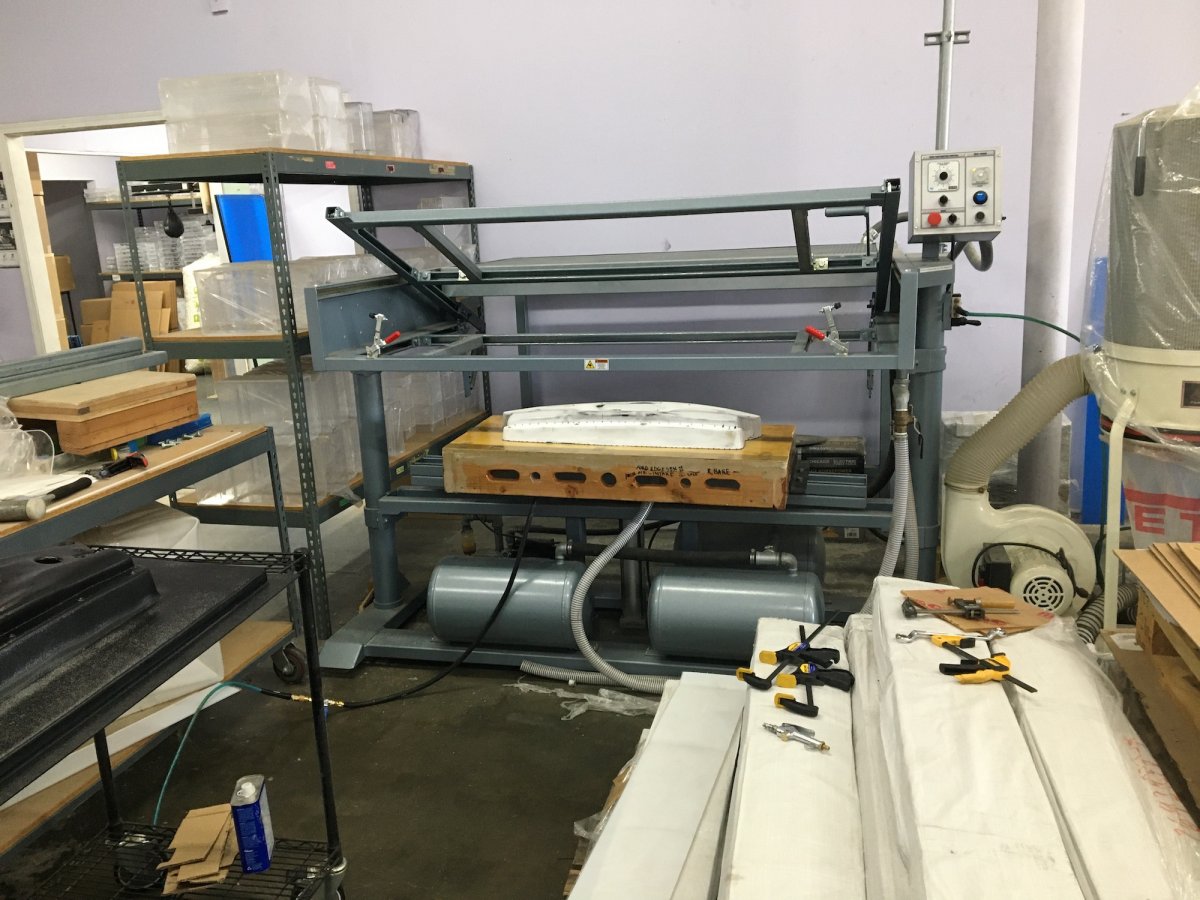

Xtra Posted December 11, 2020 Report Share Posted December 11, 2020 (edited) This is the Vacuum Form machine with the mold ready to go. We will attempt to do the carbon intake this Monday 12-14-20 by the end of the day... Edited December 11, 2020 by Xtra 1 Quote Link to comment Share on other sites More sharing options...

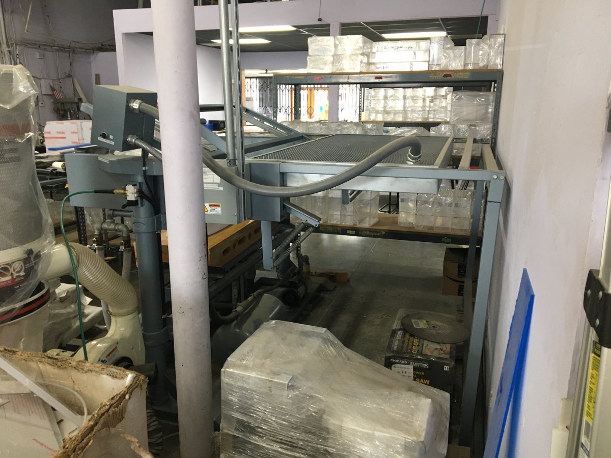

Xtra Posted December 11, 2020 Report Share Posted December 11, 2020 (edited) This is the back of the machine, you can see the heater and the large power cable running from the control box to it. This is the real deal machine. I looked long and hard for a company that had quality equipment. Edited December 11, 2020 by Xtra 1 Quote Link to comment Share on other sites More sharing options...

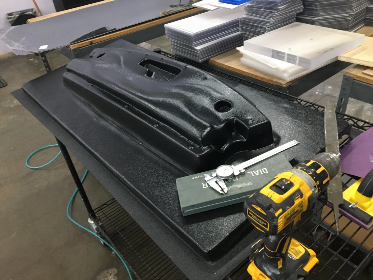

Xtra Posted December 11, 2020 Report Share Posted December 11, 2020 (edited) Good tools make good parts. You can see on this part how large the bumps are that the screws made. That is why I machined them down in size before we test the carbon. That carbon material is expensive and I cannot afford to damage even one of them when molding. The carbon sheet is visible on the table at the top of the photo ready to go. This is the very first CAI to go into production for Edge Sports #001. I consider the clear and fiberglass ones prototypes. Edited April 8, 2022 by Xtra 1 Quote Link to comment Share on other sites More sharing options...
