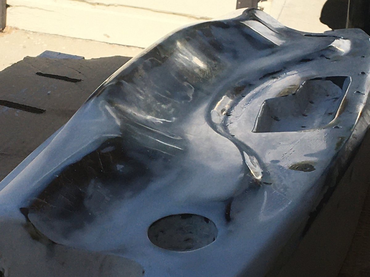

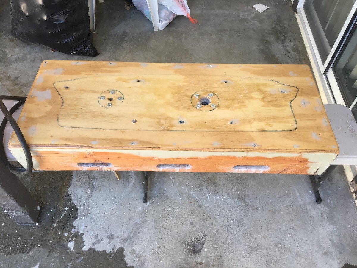

Xtra Posted June 30, 2021 Report Share Posted June 30, 2021 (edited) Almost finished with the V2 mold refresh. It is 100 + degrees today as it has been for over a week now, and I can only handle a couple hours of work a day. I had to take the mold apart to refresh it After patching, I started sanding with 120 followed by 220, then 320 dry grit. I then switched to wet sand paper 400, 600 ,1000 and finished with 1200 grit. For those that were counting, the entire mold was sanded 7 times after patching to get to this point of the refresh. It is now ready for polishing compound. The fiberglass mold patched and wet sanded. It needs to be ready when the CF arrives to stay on track. . Edited June 30, 2021 by Xtra 3 Quote Link to comment Share on other sites More sharing options...

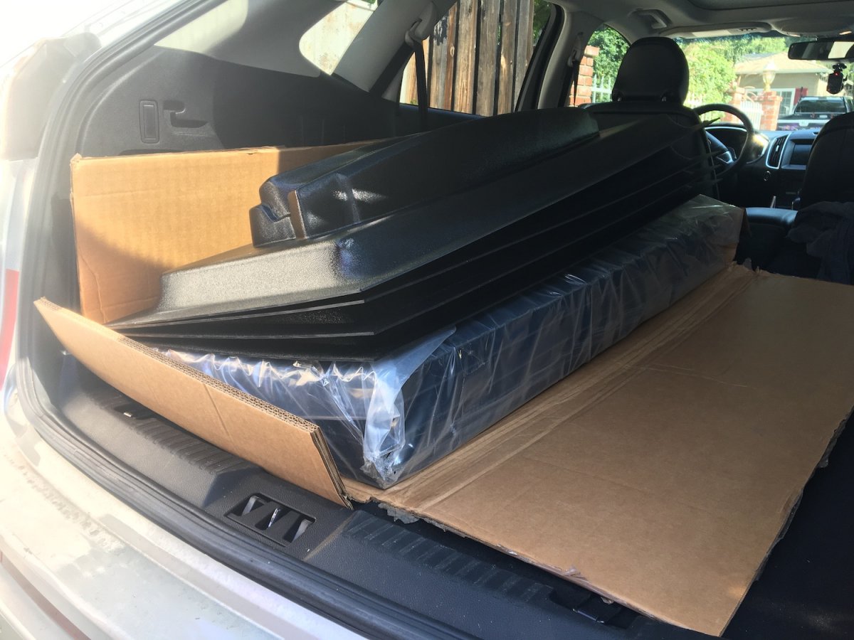

Xtra Posted July 3, 2021 Report Share Posted July 3, 2021 (edited) Loaded up my Edge Sport and took the CF and the mold to the plastic shop today. They said they would mold the intakes sometime during the week of the 5th. Once They are molded I am going to have my hands full for a while getting all the backorders orders shipped. I am having them mold up two extra V2 intakes of each; ABS and Carbon Fiber, that are available for whomever wants one. They fit like a glove . I love my do everything Edge . Edited July 3, 2021 by Xtra 1 1 Quote Link to comment Share on other sites More sharing options...

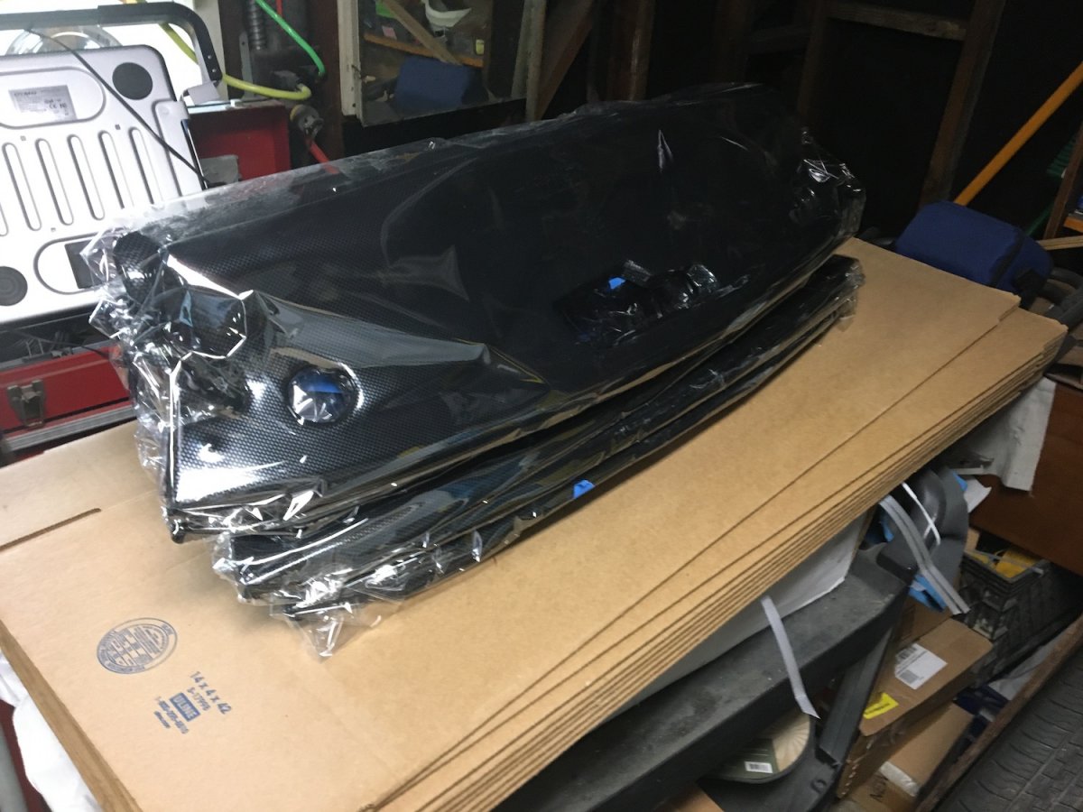

Xtra Posted July 13, 2021 Report Share Posted July 13, 2021 (edited) Picked up the intakes from the plastic shop today. The CF intakes are the ones wrapped in plastic for protection, and the ABS ones are on top. I will start cutting them out tomorrow. There are a couple extra of each that I had molded for anyone wants one. Edited July 13, 2021 by Xtra 5 Quote Link to comment Share on other sites More sharing options...

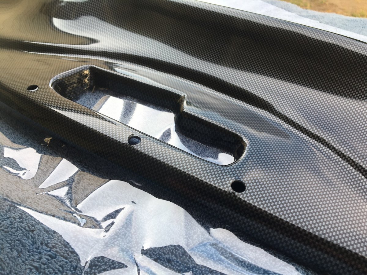

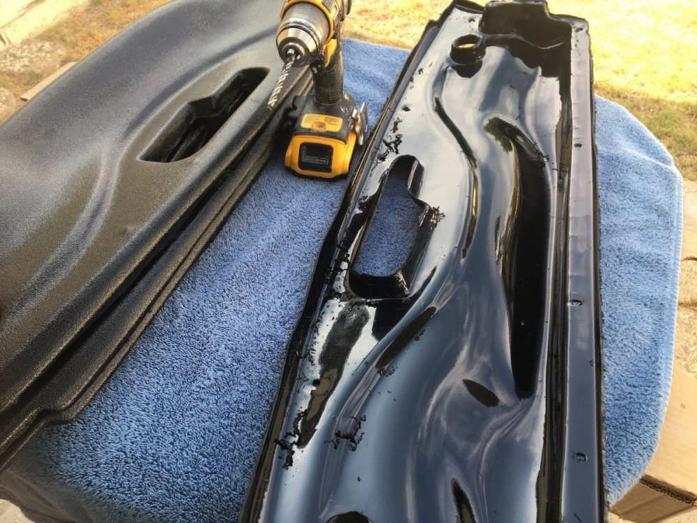

Xtra Posted July 25, 2021 Report Share Posted July 25, 2021 (edited) Finally saw a drop in temps to the low 90s, and managed to drill holes in all the intakes . I first drill pilot holes. The pilot bit is the same size as the hole markers. This helps with accuracy, and as everyone must know by now the holes are not spot on, but close enough to work. Each V2 intake has 12 mounting holes that need to be finished. The backside is smooth to allow the best air flow, and the topside is textured on the ABS intakes. You can see the hole markers that need drilling in this photo. I just use my cordless drill for this job. At this point I have to be careful and a bath towel helps protect the finish, this is super important when working with the Carbon Fiber Material. Edited July 26, 2021 by Xtra 1 Quote Link to comment Share on other sites More sharing options...

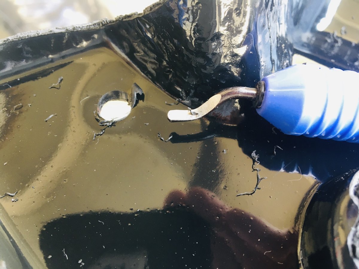

Xtra Posted July 25, 2021 Report Share Posted July 25, 2021 (edited) After drilling all the pilot holes I go back and re-drill them to size with a larger bit. I then use this blue tool to clean up both sides of the holes after drilling. A single hole takes 4 operations to complete. This is the backside of the CF intake, it is smooth like the ABS to allow better air flow. Here Is a CF V2 awaiting to have its holes cleaned up. Now that all the intakes have their mounting holes, the next step is sanding the edges to clean up the saw cuts. That is a operation that uses hand tools, air tools, and a belt sander to accomplish. I have to be diligent otherwise time just keeps slipping, slipping, slipping, into the future...lol ... And I need to get this done so I can continue work on the V3 once the parts are molded later this week. Now that all the holes have Edited July 26, 2021 by Xtra 1 Quote Link to comment Share on other sites More sharing options...

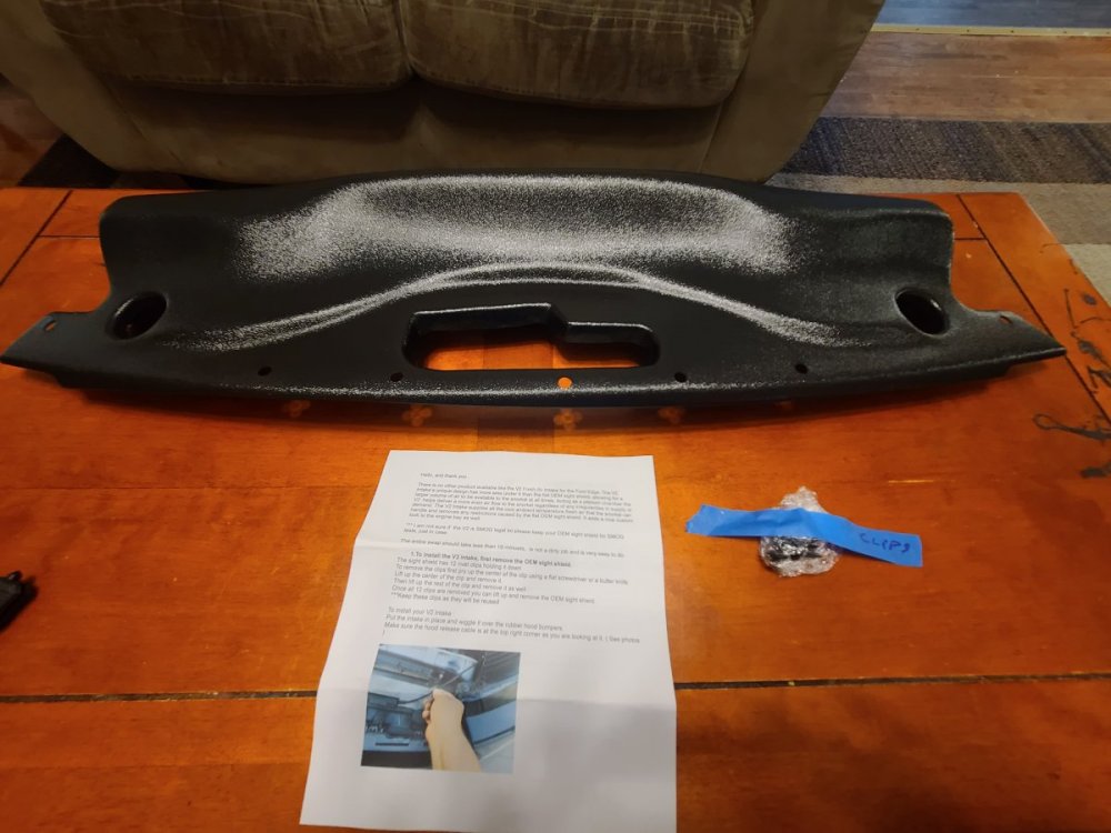

dcmawyer Posted August 27, 2021 Report Share Posted August 27, 2021 Alright, my V2 has arrived! I'll have it on tomorrow. The quality is awesome. I'm excited to see what it does on my 16 Sport 2 Quote Link to comment Share on other sites More sharing options...
