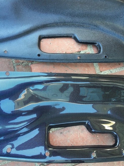

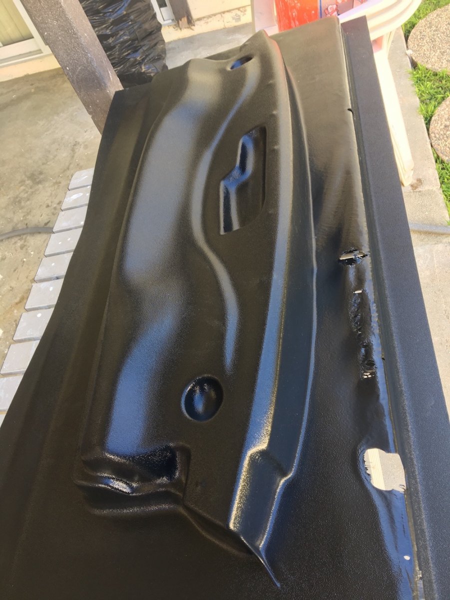

Xtra Posted March 19, 2021 Report Share Posted March 19, 2021 (edited) Finally have an update. The V2 mold was tested and I have one intake molded. Because I rounded off the edges of the wood on the mold there was a problem with getting proper vacuum . This did not hurt the part but made it more difficult for the shop to work with . In the photo of the untrimmed part you can see where the material melted and pulled through. The shop is working on a solution for me and I may have to modify the wood part of the mold again and remove the rounded edges. The good news is that The fiberglass part of the mold is working better than ever. Here you can see how the ABS melted and holes formed along the rounded edges loosing vacuum This compares V1 on the bottom and V2 on top. The gasket line is much better defined on the V2 Test fit of the V2 . I have not even finished hand fitting it and it is looking good. The hood rubber bumpers stick above the intake a little more, and there is added room for the hood latch. I took it for a test drive and I can't tell any difference in performance between V1 and V2. All that is needed is to complete the finishing and then test for universal fit on 2015 to 18 Edges. Edited March 23, 2021 by Xtra 3 3 Quote Link to comment Share on other sites More sharing options...
