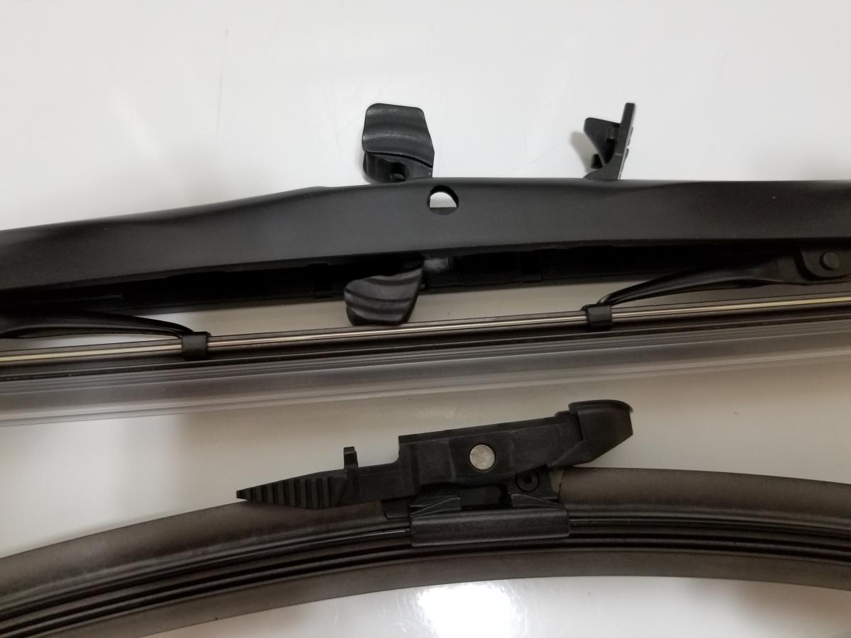

Xtxman Posted September 19, 2018 Report Share Posted September 19, 2018 Trying to replace wipers on my 2015. OEM and new wiper do not look at all compatible(see photo) Any suggestions? Quote Link to comment Share on other sites More sharing options...
TheWizard Posted September 20, 2018 Report Share Posted September 20, 2018 Trying to replace wipers on my 2015. OEM and new wiper do not look at all compatible(see photo) Any suggestions? 20180919_150650.jpg That won't fit. You'll need to find wiper blades that fit an "I&L" arm which has a hook at the end which the blade swivels on to engage squeeze-to-lock tabs. I have found Motorcraft to be the best fit but PIAA, Bosch, and Rain-X also make blades that work. The Motorcraft model is WW-2801-PF. 2 Quote Link to comment Share on other sites More sharing options...
Xtxman Posted September 20, 2018 Report Share Posted September 20, 2018 Thanks, Wizard, I've been changing wiper blades on my vehicles for 50 years and never came across a connector like that. Found a RainX blade that fit at meiers and just got through installing it. Thanks again! 1 Quote Link to comment Share on other sites More sharing options...
