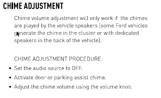

TSCHANNE Posted February 2, 2018 Report Share Posted February 2, 2018 Is there a way to adjust the volume of the chimes from when you first enter the vehicle (2017 Edge Sport) along with the collision warning and front/back/side sensor chimes? Not that I want them loud but all of them in my Edge are barely audible. I did have a shop upgrade my stereo with a new Kenwood Excelon amp and iDatalink Maestro unit several months ago and the chimes have been low volume since the install. If that's the cause and there's no adjustability then that's fine, but if it can be adjusted I'd like to know. Also which speaker/speakers does the chimes come from? TIA Quote Link to comment Share on other sites More sharing options...

JScaro Posted February 26, 2018 Report Share Posted February 26, 2018 Thanks for the info, I'm going with the Kenwood DSP amp, upgrading front speakers / center / sub & sub amp / rear pillar amp. I've done a good bit of research and I think I found how you adjust the chime. Page 3 of the Maestro instruction and it explains it. http://maestro.idatalink.com/search/search?project=ar&vehicle_make_id=12&vehicle_year_id=2017&vehicle_model_id=609&vehicle_audio_id=12796 One other question. Did you radio retain the "Confirmation Beep" when you make a button selection on the screen? Quote Link to comment Share on other sites More sharing options...
JScaro Posted February 26, 2018 Report Share Posted February 26, 2018 (edited) Maybe this will work Edited February 26, 2018 by JScaro Quote Link to comment Share on other sites More sharing options...
TSCHANNE Posted February 27, 2018 Author Report Share Posted February 27, 2018 Thanks John , I'll give it a try. Tom Quote Link to comment Share on other sites More sharing options...
TSCHANNE Posted February 27, 2018 Author Report Share Posted February 27, 2018 John Thanks so much for the research and the tip, worked like a charm!! That issue was buggin the crap out of me for months. All is well now Again , Thanks! 2 Quote Link to comment Share on other sites More sharing options...
