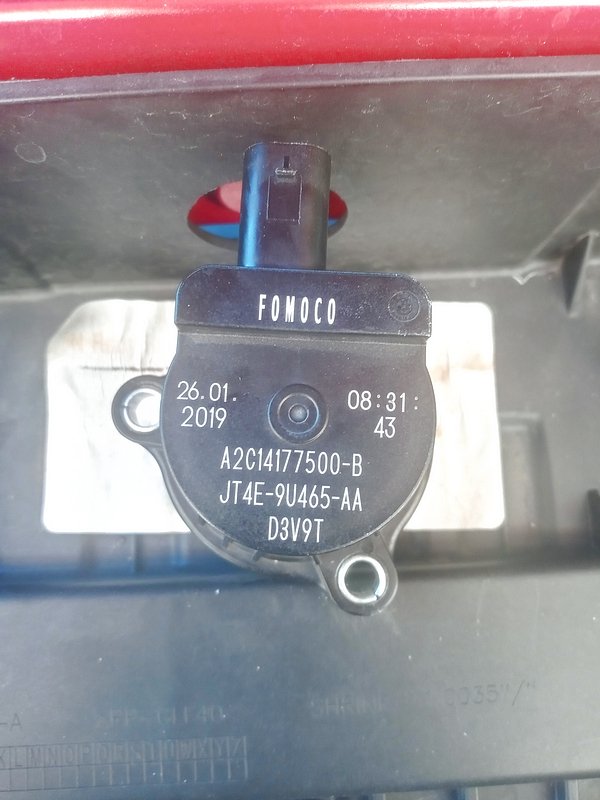

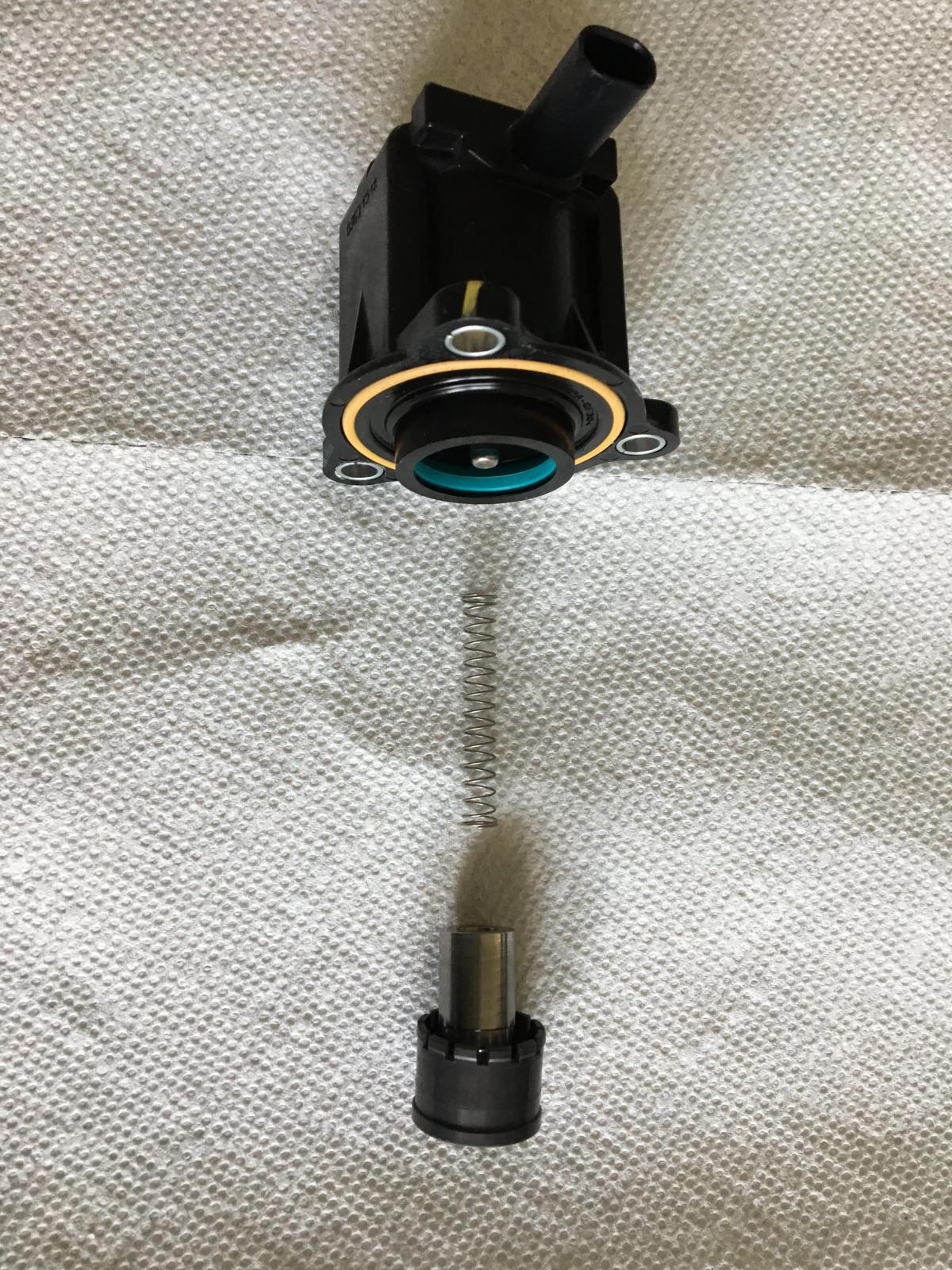

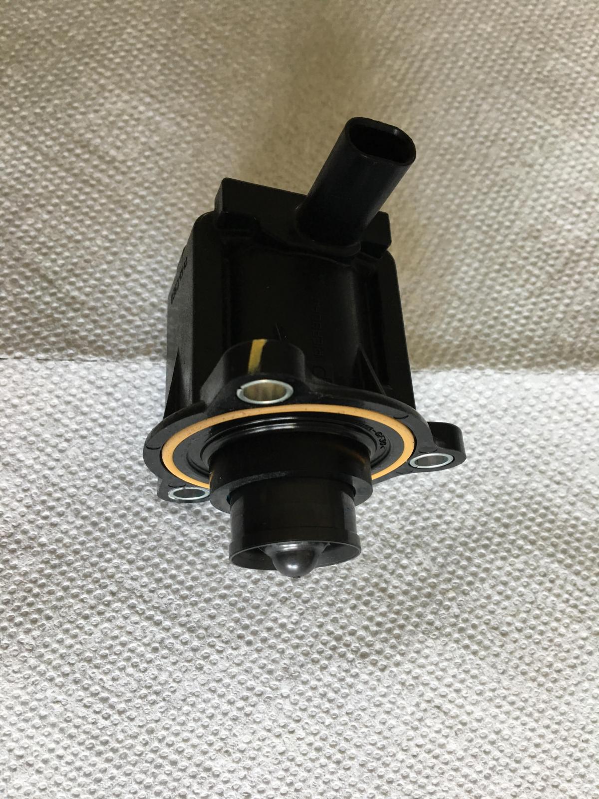

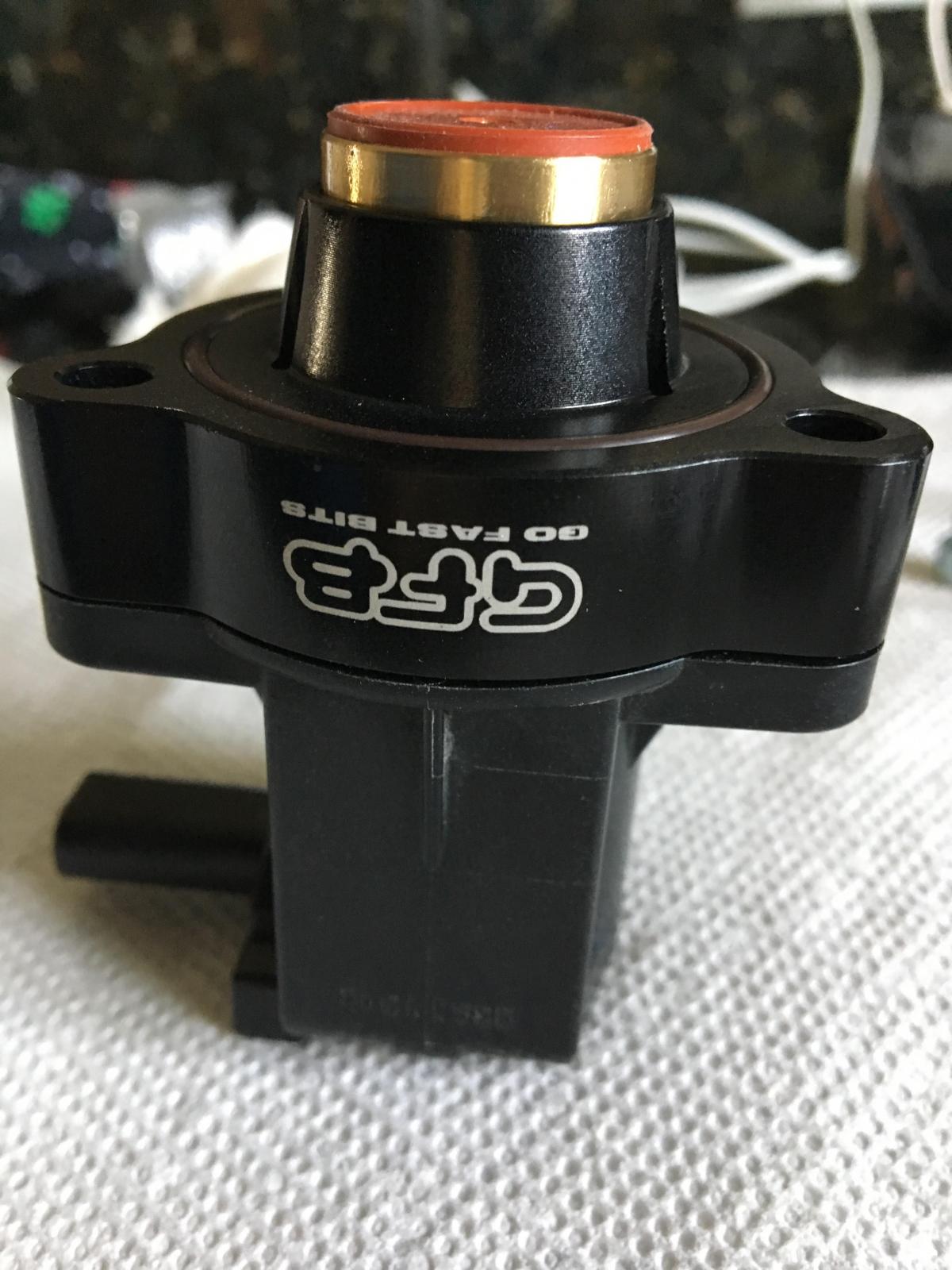

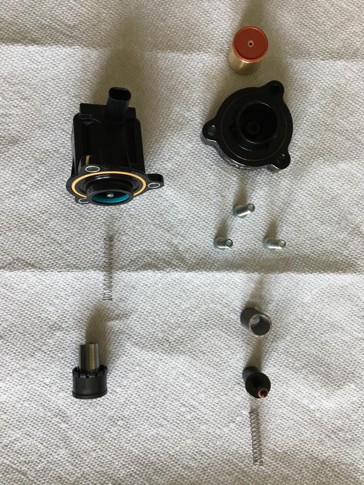

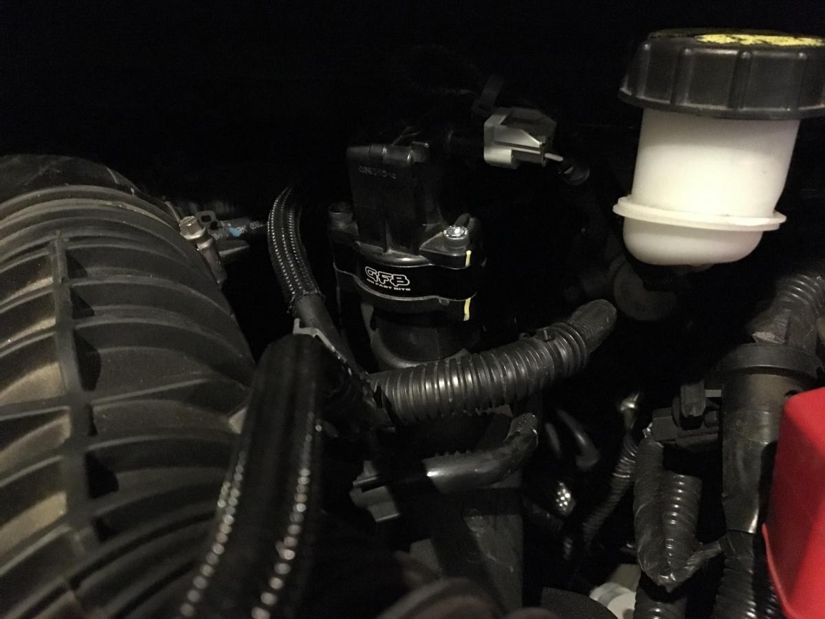

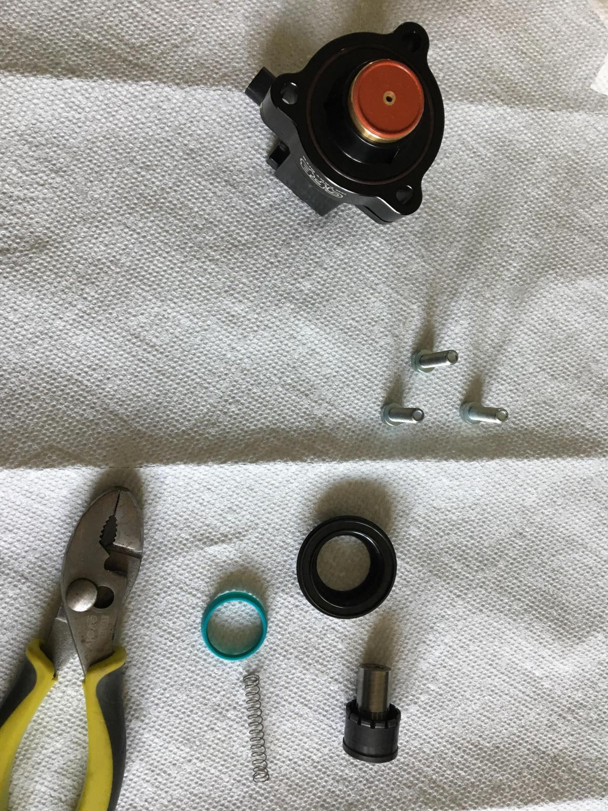

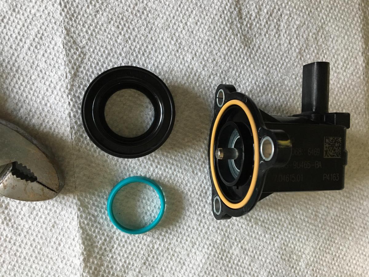

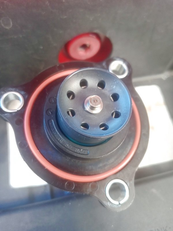

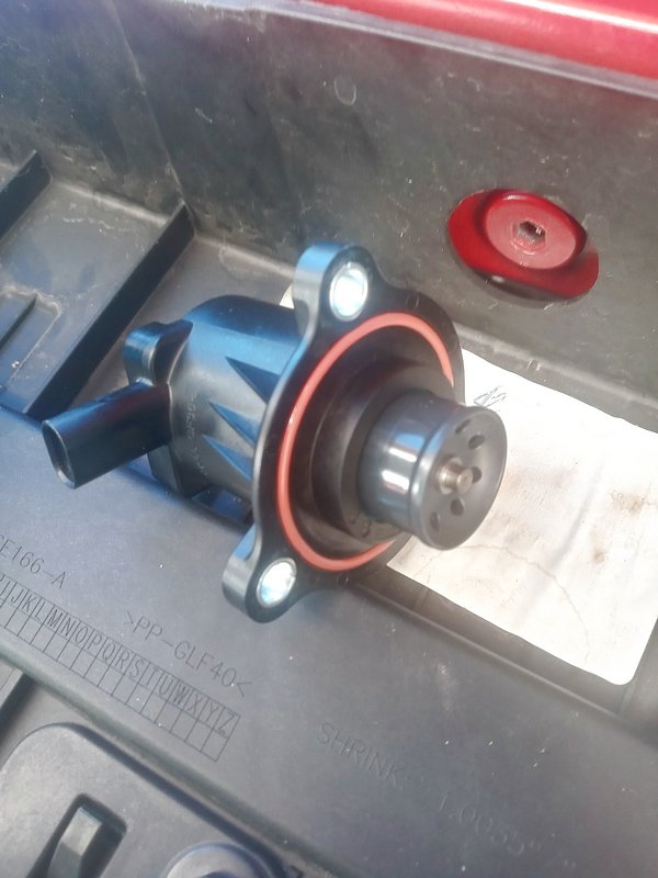

GT500R Posted January 15, 2018 Report Share Posted January 15, 2018 So with all the talk of BOV's and the whole what does this really do thing, I decided to purchase an upgraded Diverter Valve and test to see if there are any benefits from it. I'll try to keep this as short as possible... Product - Go Fast Bits Diverter Valve + -> T9358 (http://www.gfb.com.au/products/blow-off-and-diverter-valves/dv-plus/dv-t9358-suits-mercedes-ford-and-volvo-detail) I have one of these on my GLi and it works flawlessly, holds boost well and prevents leaks due to the weak stock diverter valve. Benefits from the website - Sharper throttle response Faster boost recovery on gearshift Solves boost leaking issues Built to last Installation (see pics attached): Pretty simple and straight forward. I used this youtube video to perform it -> Took around 15 minutes overall, the screw closest to the firewall was the biggest PITA. Testing: I always try to make my tests as consistent as possible so the test conditions were 25* F on the same stretch of road with the same gas and the same test methodology - just off the gas and mash as fast as possible. I find brake boosting is a bit inconsistent to replicate 6 times over and I spin if I boost it too much off the line (AWD still spins...) 3 tests were done with stock DV, 0-80 twice and a 0-100 I was hoping to see quicker boost response or better boost hold at later rpms. Results: Mixed.... overall the acceleration was slightly, and I mean SLIGHTLY better with the GFB+ Left to right is the first run, second run, then third run. You can see, the DV+ does a slightly, ever so slight better job in holding boost. Acceleration was the best with DV+ at 4.97 vs. 5.05 with the stock valve. The build up from 0-20mph was better and more consistent with the DV+. After I hit 2nd gear with the DV+ it seems to accelerate a smidge better then stock. Is it work the $130ish or so? Well... If you want something that will prevent boost leaks and have some consistent boosting, yes. Will this give you tenths upon tenths in the 1/4 mile? No, but I think its worth it for peace of mind. 5 Quote Link to comment Share on other sites More sharing options...
