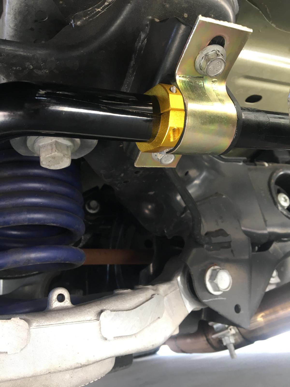

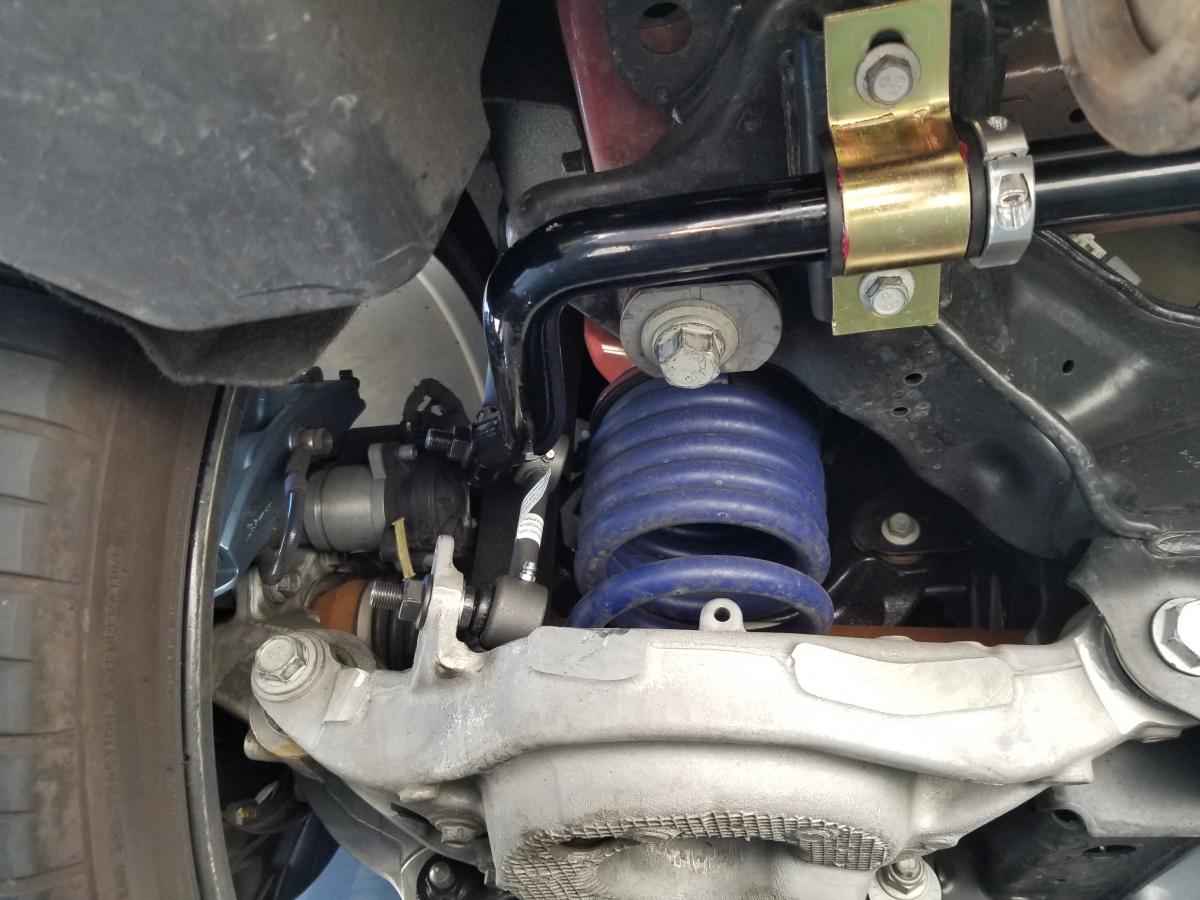

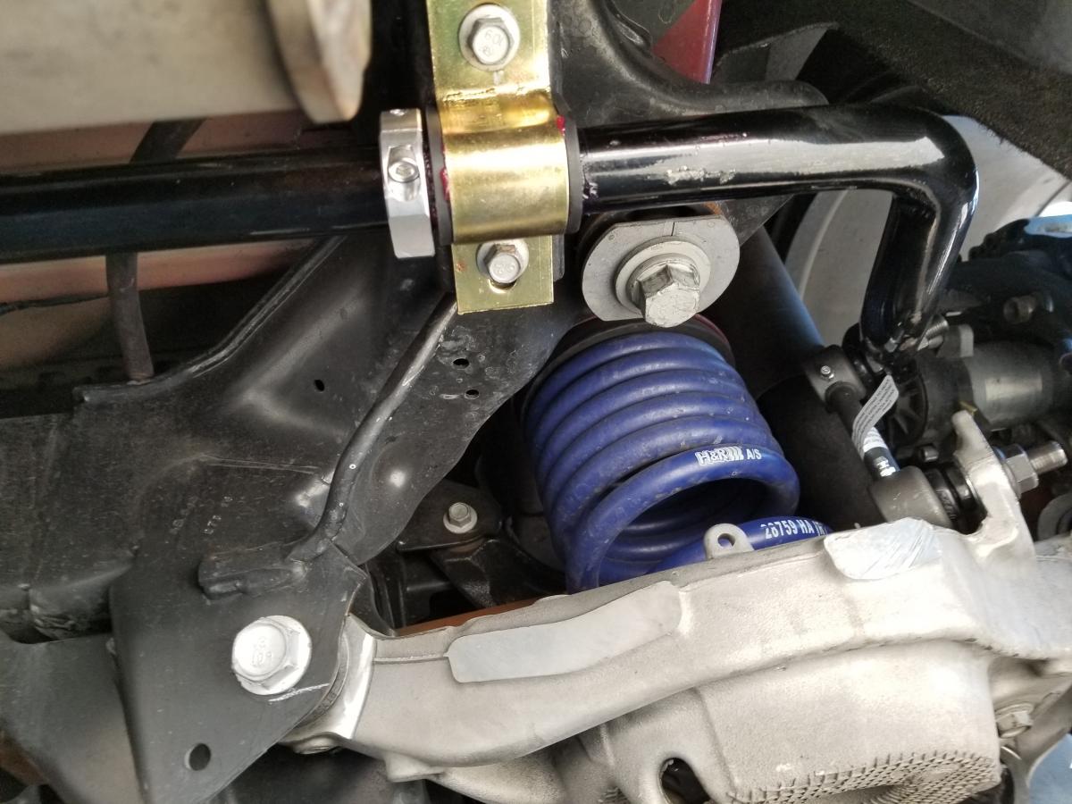

roots57 Posted August 15, 2018 Report Share Posted August 15, 2018 (edited) Got my bar in finally. Glad I decided to wait until I had the shaft collars. It looks like there is plenty of opportunity for the end link studs to start ripping into the parking brake module if it migrates sideways just a tad in either direction. I highly recommend adding them to this mod! Just from the short drive I took, I could immediately notice the reduction in body roll. I played it safe and went with the lighter setting for now. Edited August 15, 2018 by roots57 4 Quote Link to comment Share on other sites More sharing options...
Xtra Posted August 15, 2018 Report Share Posted August 15, 2018 Got my bar in finally. Glad I decided to wait until I had the shaft collars. It looks like there is plenty of opportunity for the end link studs to start ripping into the parking brake module if it migrates sideways just a tad in either direction. I highly recommend adding them to this mod! Great information with good photos Thanks . Was there room to put the lateral lock / shaft collars on after the sway bar was installed or did you have to put them on first ? 2 Quote Link to comment Share on other sites More sharing options...

roots57 Posted August 15, 2018 Report Share Posted August 15, 2018 Great information with good photos Thanks . Was there room to put the lateral lock / shaft collars on after the sway bar was installed or did you have to put them on first ? There's room to put them on afterward, on either side of the brackets too. You can also measure the bracket spread and then add the collars before you put the bar on, but its probably easier to just put them on after. Plus, that way you can be more precise with centering the bar and the amount of play you allow for with the shaft collars. 4 Quote Link to comment Share on other sites More sharing options...
Xtra Posted August 16, 2018 Report Share Posted August 16, 2018 I got mine from McMaster Carr, they're just two-piece hard anodized aluminum shaft collars w/ stainless steel bolts. I paid the same as you guys, $30 for the pair. Your McMaster Carr collars look better and more beefy than the Whiteline collars and they cost the same. What is the part number of those? Quote Link to comment Share on other sites More sharing options...
dmjarosz Posted August 17, 2018 Report Share Posted August 17, 2018 Your McMaster Carr collars look better and more beefy than the Whiteline collars and they cost the same. What is the part number of those? 6436K143 for the 2024 Aluminum 6436K39 for the 303 stainless 9633T22 for the 316 stainless They also come in black oxide, zinc plated, and chrome plated. 4 Quote Link to comment Share on other sites More sharing options...

Xtra Posted August 18, 2018 Report Share Posted August 18, 2018 (edited) I do not recommend installing the ADDCO bar without lateral locks. The stock OEM sway bar has lateral locks pressed onto the bar. Without the locks the sway bar could possibly shift and cause interference problems. Adding Lateral Locks is a good idea with this bar and car. Edited August 18, 2018 by Xtra 1 Quote Link to comment Share on other sites More sharing options...
snmjim Posted August 18, 2018 Author Report Share Posted August 18, 2018 (edited) Being the R&D platform, design team and having the first bar SpecialK & I would have to disagree with the urgency but do agree with installing the locks. However, note that as of today we have been thrashing our platform fairly abusively at times and have yet to find evidence of the bar making any contact in its tight tolerances with the Elect brake calipers or the springs. Yes, we have ordered locks as well but only as a logical precautionary measure... BTW, the tolerances change significantly when the car is on the ground and has been rolled out to level the suspension before measuring...;-) Edited August 18, 2018 by snmjim 2 Quote Link to comment Share on other sites More sharing options...
