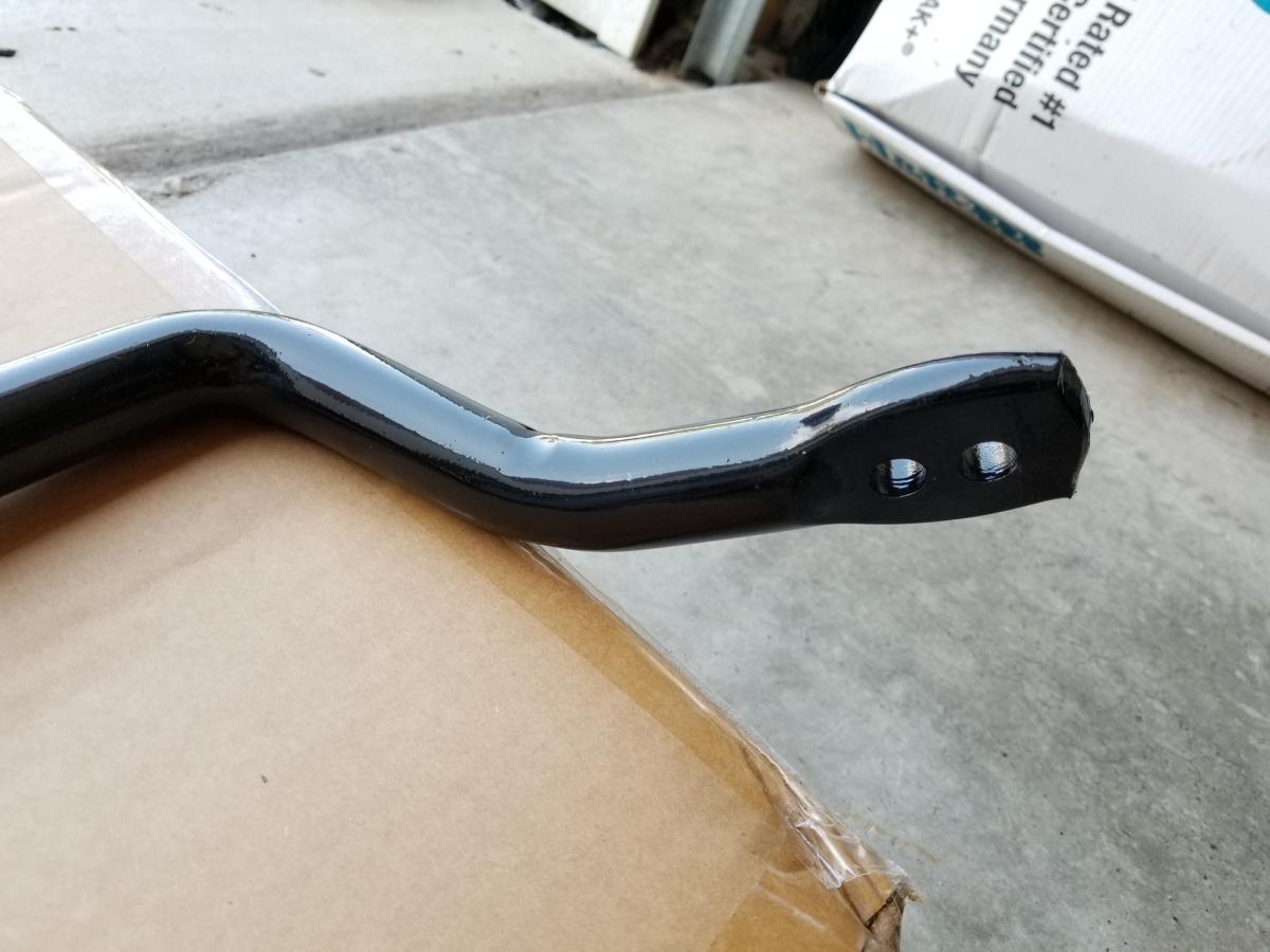

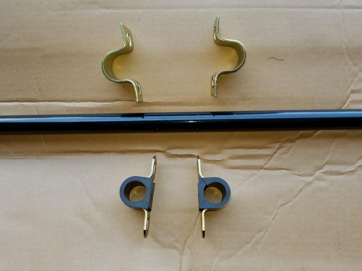

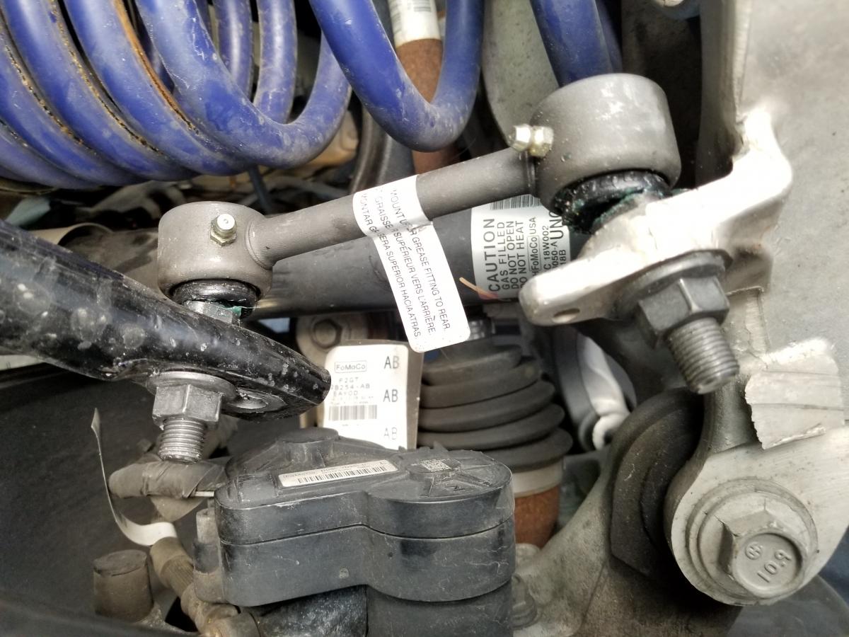

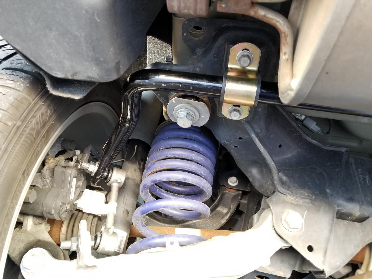

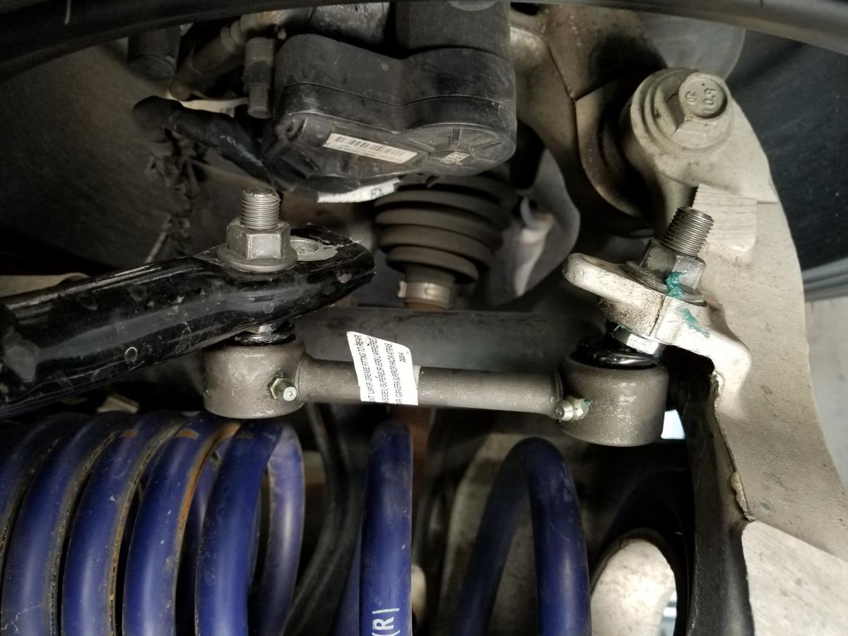

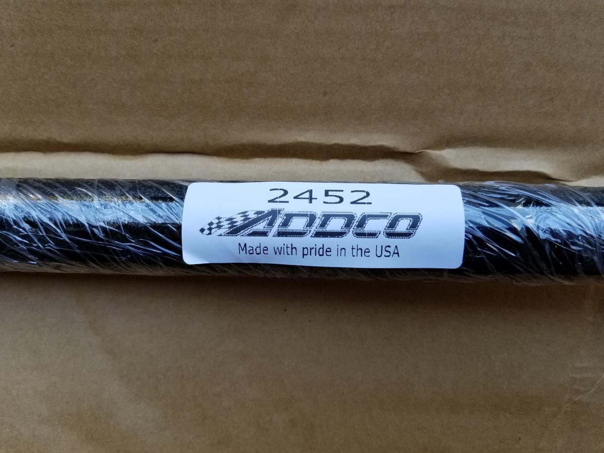

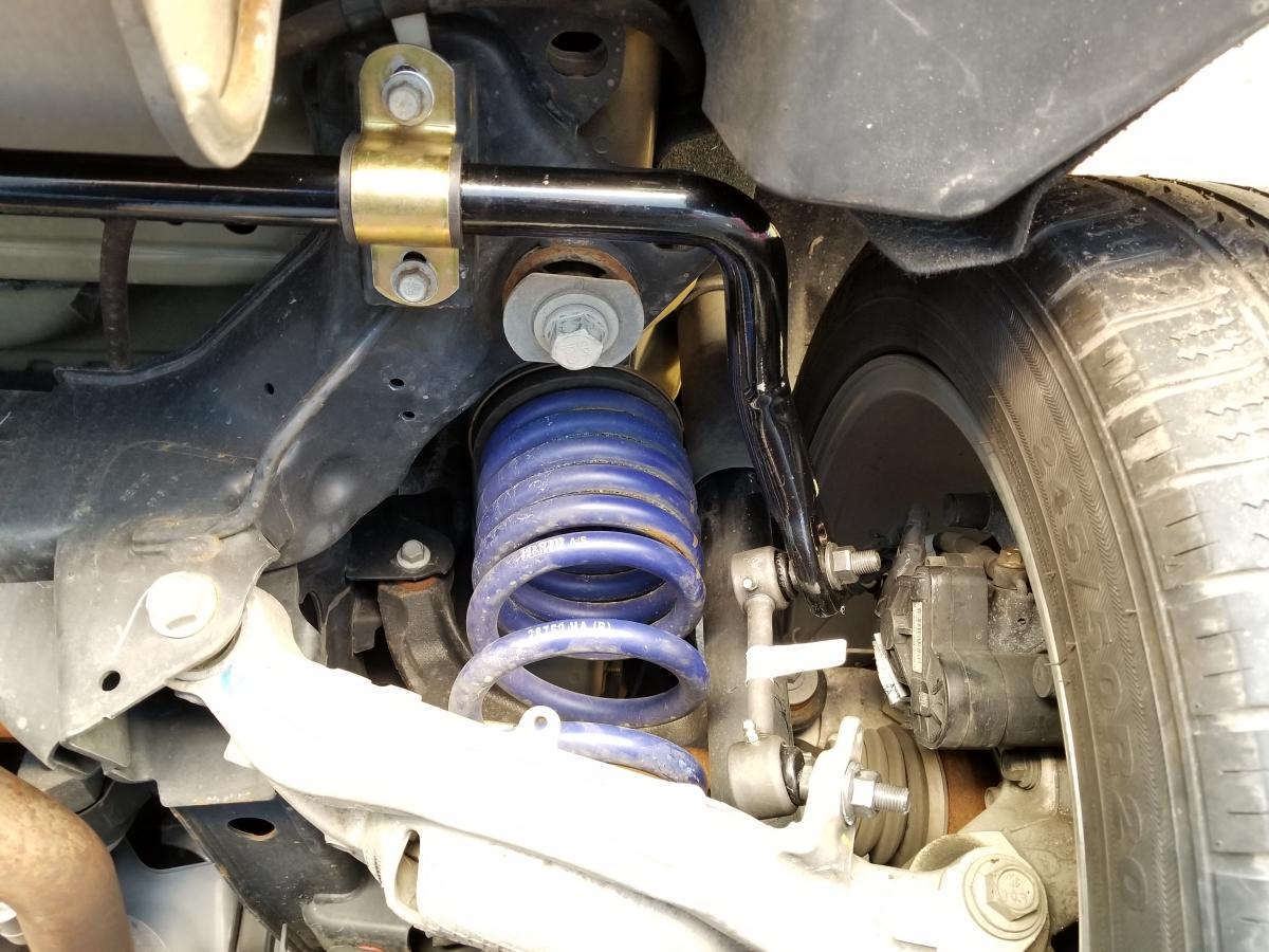

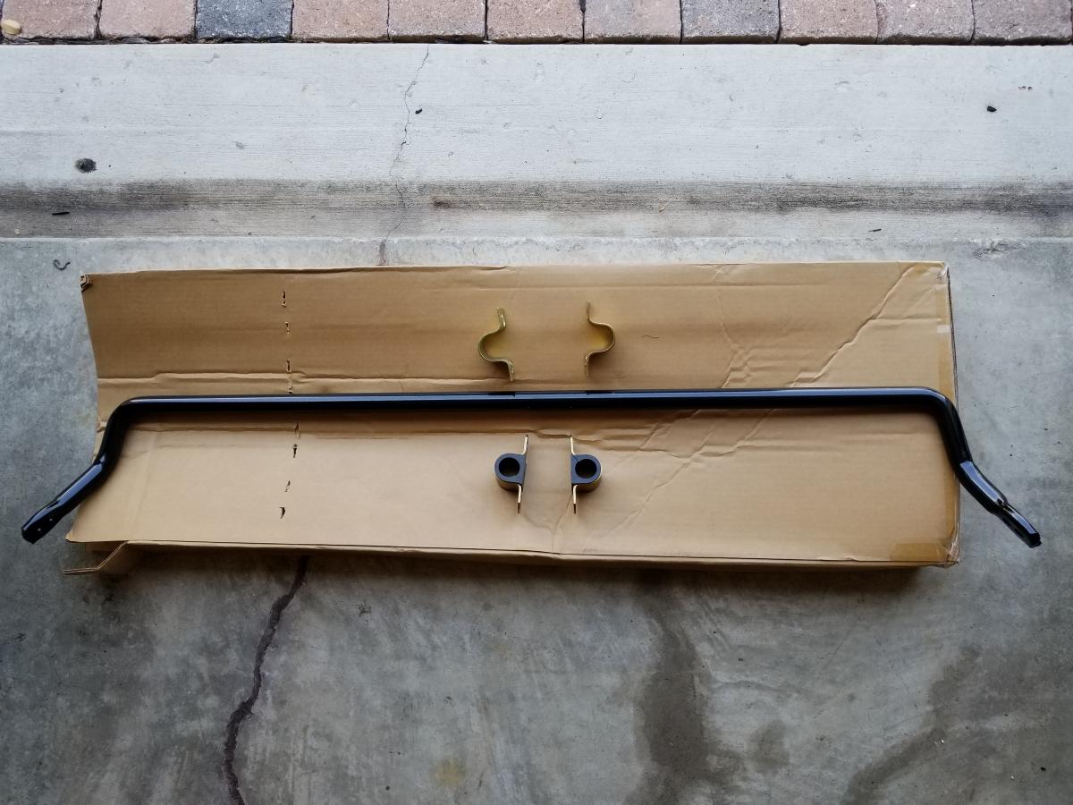

snmjim Posted May 13, 2018 Author Report Share Posted May 13, 2018 (edited) The ADDCO Stabilizer bar specifics are in and ADDCO is ready for us to collectively order!Note: this bar specifically applies to late model 2015 thru 2018 AWD & FWD Edge Sport.ADDCO requires a minimum order of 10 to INITIATE this production run and will not consider a smaller Qty.I'm coordinating this initial purchase for us in order to initiate the minimum production batch price requirement.SpecialK is coordinating Facebook orders to assist with accomplishing the production initiation Qty.Note: if you attempt to go direct to ADDCO you will defeat the purpose of the group rate.The following have committed to placing the initial orders:XtraonyxbflyOne Slow 5.0JScaroroots57Denny GaughanredlancerWe have exceeded the minimum production number, this count includes 5 orders from the Facebook group.Additional orders WILL be accepted as long as they are placed during the required time frame for this initial order (28 May thru 01 June 2018).The bar is powder coated black and supplied with mid section brackets and bushings (Ref Pics).UPDATEs:- As of 24 May 2018 install/fitment is complete and successful with the usual Stab bar install technique.- As of 25 May 2018 Performance testing results for 1st hole:Body roll 80-90% eliminatedCar is firmly planted in sharp speed turnsUndersteer mitigated 80-90%- As of 2 June 2018 Performance testing results for 2nd hole:Body roll 85-95% eliminatedCar is firmly planted in sharp speed turnsUndersteer mitigated 85-95%ADDCO INITIAL ORDER SPECIFICS:As of 29 May 2018:- Immediately contact John Wright (ADDCO primary Engineer) (Office: 800-338-7015 x102 or Cell 828-719-8034) to place your order.- John Wright (ADDCO POC) asked that you leave a Msg if he doesn't answer and he'll return your call.ADDCO Info:www.addco.netPart # 2452 1.125Price = $185.00 (price does NOT include shipping)INSTALLATION COMMENTS:Ref PicsRecommend replacing OE links with MOOG (p/n MOO K750744) from RockAuto. Stiffer bar stronger links.Put very light coat of silicone or grease on inside diameter of bushings to allow for ease of bar left to right alignment.Loose fit the bar by resting it in place over exhaust pipe without bolting down bushing brackets.Then install the links, if you elected to replace them, but leave connected & loosely bolted.Tighten down links first then align bar so the distance is equal for the amount of bar extending beyond the left & right bushing.Tighten down bushings & your done.Note: you may want to consider putting anti seize on all threads...GENERAL COMMENTS: No clue why the FEF App continues to turn my Pics sideways... If we taunt SpecialK enough he just might bless us with an evaluation & comparative video to his last video...hint, hint...I so enjoy taunting that fine young man...lol Edited June 2, 2018 by snmjim 4 Quote Link to comment Share on other sites More sharing options...
WWWPerfA_ZN0W Posted May 13, 2018 Report Share Posted May 13, 2018 So this is just the rear sway bar for now? I see only one item/price listed. Quote Link to comment Share on other sites More sharing options...
snmjim Posted May 13, 2018 Author Report Share Posted May 13, 2018 (edited) So this is just the rear sway bar for now? I see only one item/price listed. No need 2 redesign the front. The modified rear bar will put the vehicle right where the preferred performance handling characteristics recommend. Edited May 13, 2018 by snmjim 1 Quote Link to comment Share on other sites More sharing options...
