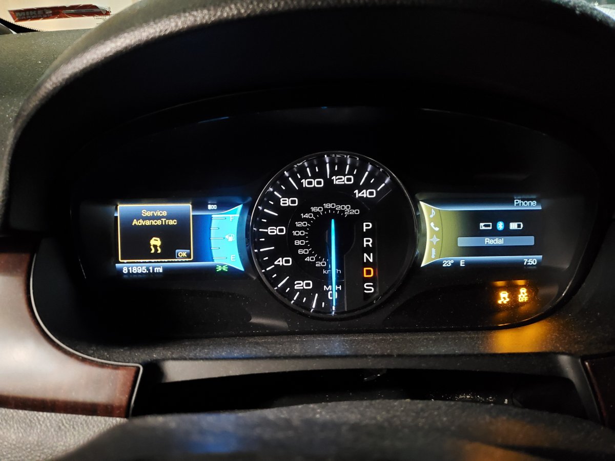

kkrace Posted October 8, 2014 Report Share Posted October 8, 2014 Is there an explanation somewhere about under what circumstances the Service Advancetrac light comes on? Quote Link to comment Share on other sites More sharing options...
WWWPerfA_ZN0W Posted October 8, 2014 Report Share Posted October 8, 2014 (edited) This is a writeup I found via Google here. But assume anything connected to traction control that is providing faulty or missing data would pop the light. That would include brakes, wheel speed sensors, transmission sensors (TSS/OSS), etc. As the writeup explains, there might be a brake booster sensor (if active) or the ABS module (if booster is electrically actuated) kicking it off in this specific instance. BTW, the master cylinder can bleed into the brake booster due to a damaged seal. Check your brake fluid for level & clarity. Edited October 8, 2014 by WWWPerfA_ZN0W Quote Link to comment Share on other sites More sharing options...

Red2149 Posted January 4, 2018 Report Share Posted January 4, 2018 Hey everyone- Started noticing this warning pop up randomly over the last month or so. Seems to happen if my car is on but idle (like sitting in a parking lot.) If I turn the car off and back on, the warning disappears. Any thoughts?? Thanks, Kate. Ford Edge Limited 2011 AWD Quote Link to comment Share on other sites More sharing options...
WWWPerfA_ZN0W Posted January 4, 2018 Report Share Posted January 4, 2018 Possibly needs a PCM software recalibration to fix. There is a TSB on it IIRC,hopefully that is all it is. TSB 13-1-15_ANTI LOCK BRAKE SYSTEM (ABS)-ADVANCED TRAC WARNING LIGHT ILLUMINATED - DTCS P193C AND U0401 - BUILT ON OR BEFORE Jan23-2013.pdf Quote Link to comment Share on other sites More sharing options...

michal4655 Posted March 17, 2018 Report Share Posted March 17, 2018 I am new to the forum and I would like to share my recent experience with the Advance Trac warning light. The warning light first came up during extremely low temperature this winter while driving. It would randomly come up on occasions but it would usually turn off after few seconds of driving or after turning the car off and turning back on. I took my Edge to the dealership and their diagnosis was that my battery is almost dead. Apparently the battery and Advance Trac system have the same diagnosis code so the advance trac system light would come up with the low battery. I find it hard to believe. Anyone heard anything like that? The battery might have been low on power so I don't think I was ripped off at the dealership but is my problem fixed? Quote Link to comment Share on other sites More sharing options...
WWWPerfA_ZN0W Posted March 17, 2018 Report Share Posted March 17, 2018 Usually it is a calibration issue, a bad wheel speed sensor, or a cracked tone ring that causes this light to pop up. The fact that it is intermittent COULD be a voltage issue (e.g. battery), but yours would be the first case I have seen solved with a new battery. Quote Link to comment Share on other sites More sharing options...
michal4655 Posted March 17, 2018 Report Share Posted March 17, 2018 Its been two weeks since my service visit and the warning light hasn't lit up since. You might be right and it could be a good tip to everyone who has to deal with this problem to check the battery voltage. 1 Quote Link to comment Share on other sites More sharing options...
WWWPerfA_ZN0W Posted March 17, 2018 Report Share Posted March 17, 2018 Absolutely, checking the battery is a basic yet vital maintenance procedure, I feel, on the Edge/MKX. 1 Quote Link to comment Share on other sites More sharing options...

WWWPerfA_ZN0W Posted February 20, 2019 Report Share Posted February 20, 2019 Long periods of idling (gen 1.5) will cause a false warning, there is a TSB addressing it. 1 Quote Link to comment Share on other sites More sharing options...
PegsEdge Posted March 25, 2019 Report Share Posted March 25, 2019 WWWPerfA_ZN0W Long periods of idling (gen 1.5) will cause a false warning, there is a TSB addressing it. Do you happen to have a link to the TSB or the TSB number? I want to have all my ducks in a row for when I take it in to the dealer. Last time I talked to them about this issue, they didn't know of a TSB.. Thank you! Quote Link to comment Share on other sites More sharing options...
WWWPerfA_ZN0W Posted March 26, 2019 Report Share Posted March 26, 2019 Here is the condition for oil pressure light TSB 11-12-7 https://drive.google.com/open?id=1ovofE803vsATVjNzYgGTqt7JC8mga5Pt Here is the long idle condition where some have had it pop up TSB 13-1-15 https://drive.google.com/open?id=18rPm9EX1weiU5A_zBZXc1jpJd3-vV2MX The solution in both cases is to update PCM calibration. 1 Quote Link to comment Share on other sites More sharing options...
