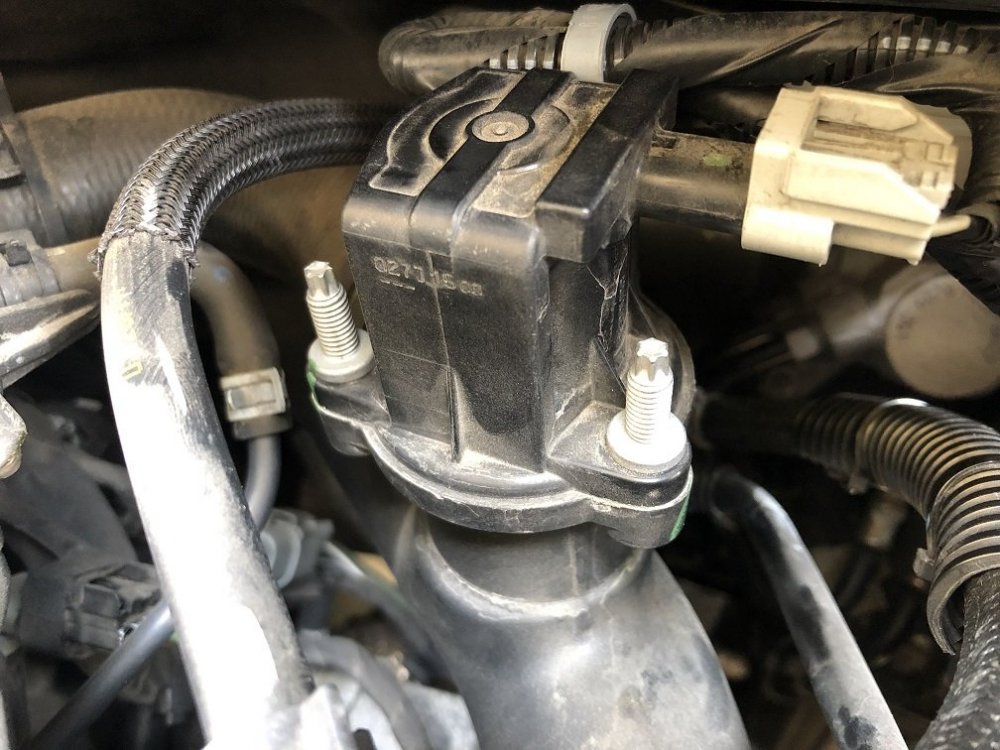

CTXCTS Posted July 17, 2021 Report Share Posted July 17, 2021 Hello, How do you get these damn studs off of the stock Bov? I was thinking the double nut technic but there is something covering the threads on the back. I have a 2016 Sport - all the videos have these hex head caps - mine are threaded studs with no nut poking up. Quote Link to comment Share on other sites More sharing options...
CARR142 Posted July 17, 2021 Report Share Posted July 17, 2021 https://duckduckgo.com/?q=stud+remover+set&t=newext&atb=v277-1&ia=web Quote Link to comment Share on other sites More sharing options...
snmjim Posted July 18, 2021 Author Report Share Posted July 18, 2021 On 7/17/2021 at 5:21 PM, CTXCTS said: Hello, How do you get these damn studs off of the stock Bov? I was thinking the double nut technic but there is something covering the threads on the back. I have a 2016 Sport - all the videos have these hex head caps - mine are threaded studs with no nut poking up. Expand Pic please, can't osmos your mental image...? Quote Link to comment Share on other sites More sharing options...
CTXCTS Posted July 21, 2021 Report Share Posted July 21, 2021 I just got this car and the engibe bay looks like it 2 tours in Iraq...but those are the studs Quote Link to comment Share on other sites More sharing options...
snmjim Posted July 22, 2021 Author Report Share Posted July 22, 2021 We pressure wash our engine bays twice a year, at the beginning of Spring & Fall. The BOV studs R removed with a typical Torx star female bit socket. Quote Link to comment Share on other sites More sharing options...
