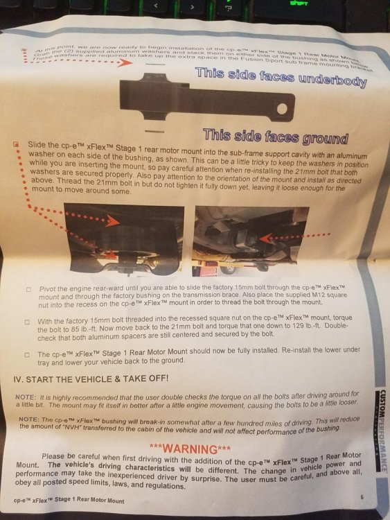

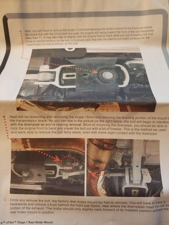

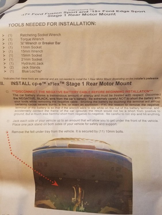

ituhata Posted January 5, 2019 Report Share Posted January 5, 2019 I got my motor mount in today. The instructions look way scarier than "just two bolts" ....rocking the engine back and forth? -_- And why do I need to disconnect the battery? 1 Quote Link to comment Share on other sites More sharing options...
snmjim Posted January 9, 2019 Author Report Share Posted January 9, 2019 On 1/5/2019 at 9:40 PM, ituhata said: I got my motor mount in today. The instructions look way scarier than "just two bolts" ....rocking the engine back and forth? -_- And why do I need to disconnect the battery? Expand It's much less effort than what it appears on the instructions. Some simple processes when put into words turns into a dissertation. Its literally as simple as: Jack up the car Unbolt the 2 retaining bolts Install the new RMM, correct side down, embossed Specs facing down, also you might need to slightly rock the motor Fwd or back by hand simply to achieve bolt alignment since that mount is what controls that rocking direction. Torque bolts to the Spec embossed on RMM and your done. Still verify my input with the instructions incase something was updated. Disconnecting the battery is a standard safety practice enforced by most dealerships.? 1 Quote Link to comment Share on other sites More sharing options...
ituhata Posted January 15, 2019 Report Share Posted January 15, 2019 (edited) I got it installed today. The change in NVH feels very subtle. If you hadn't told me that they swapped the RMM's out I might not have noticed for a while. EDIT: Lol, I take that back. I definitely would have noticed by the second time I got in. It is a rather clear difference, but other than the steering wheel, if you're not dogging it the rest of the cabin feels acceptably normal. However, I definitely can feel the engine at idle through the steering wheel, and things have tightened from the gas pedal to the tires. There are other things that feel different too, but I'e only drove it for a few miles afterwards so right now it's hard to put into words how the car feels other than to say it's simply better overall. Edited January 15, 2019 by ituhata 3 Quote Link to comment Share on other sites More sharing options...

McToberson Posted June 11, 2022 Report Share Posted June 11, 2022 I made a quick attempt at changing the rear mount yesterday (up mount, came with no instructions). I could not break the 21mm bolt loose with an impact and I didn’t have a breaker bar with me. I assumed I had the car on too much of an angle, applying too much thrust on the mount, holding the bolt in place. Should I be jacking the engine up for the rear mount swap? I’ve read through this thread and a lot of people have given advice. Some say it’s quick and easy, some say you need to do certain additional things. Is it possible to do this on ramps, maybe just partially up the ramp to get enough clearance to slide underneath the car, but not enough to force the engine to rock to such a severe angle? I really don’t like crawling under a car supported by a jack. Especially after experiencing hydraulic failure of a jack a few years ago. Cylinder failed while I was turning around to grab a jack stand. 1 Quote Link to comment Share on other sites More sharing options...
Perblue Posted June 12, 2022 Report Share Posted June 12, 2022 On 6/11/2022 at 4:10 PM, McToberson said: I made a quick attempt at changing the rear mount yesterday (up mount, came with no instructions). I could not break the 21mm bolt loose with an impact and I didn’t have a breaker bar with me. I assumed I had the car on too much of an angle, applying too much thrust on the mount, holding the bolt in place. Should I be jacking the engine up for the rear mount swap? I’ve read through this thread and a lot of people have given advice. Some say it’s quick and easy, some say you need to do certain additional things. Is it possible to do this on ramps, maybe just partially up the ramp to get enough clearance to slide underneath the car, but not enough to force the engine to rock to such a severe angle? I really don’t like crawling under a car supported by a jack. Especially after experiencing hydraulic failure of a jack a few years ago. Cylinder failed while I was turning around to grab a jack stand. Expand Good luck, I broke my bolt doing mine, not even a 1" impact would move it. Best advice I've seen is a huge cheater bar, pipe on ratchet, on a good quality breaker bar and keep slowly moving it back and forth. It would suck to do on ramps, a lift is definitely best. The ones who seem to say it's easy are 2018 and younger models, on the 2019 and up they seem to have dipped almost the whole bolt in lock tight. ALWAYS USE JACK STANDS WITH A JACK! 1 Quote Link to comment Share on other sites More sharing options...
McToberson Posted June 13, 2022 Report Share Posted June 13, 2022 (edited) On 6/12/2022 at 9:46 PM, Perblue said: Good luck, I broke my bolt doing mine, not even a 1" impact would move it. Best advice I've seen is a huge cheater bar, pipe on ratchet, on a good quality breaker bar and keep slowly moving it back and forth. It would suck to do on ramps, a lift is definitely best. The ones who seem to say it's easy are 2018 and younger models, on the 2019 and up they seem to have dipped almost the whole bolt in lock tight. ALWAYS USE JACK STANDS WITH A JACK! Expand Thanks for the heads up about the excessive loctite, I had a feeling that was the case. Do you know which color Loctite they used? Hopefully not red. Yes, I always use jack stands if I'm using a jack, I still have a hard time trusting them, too, lol. How did you extract the bolt after you broke it? With that much loctite, I assume you had to drill and tap? Edited June 13, 2022 by McToberson Quote Link to comment Share on other sites More sharing options...
Perblue Posted June 22, 2022 Report Share Posted June 22, 2022 On 6/13/2022 at 4:26 AM, McToberson said: Thanks for the heads up about the excessive loctite, I had a feeling that was the case. Do you know which color Loctite they used? Hopefully not red. Yes, I always use jack stands if I'm using a jack, I still have a hard time trusting them, too, lol. How did you extract the bolt after you broke it? With that much loctite, I assume you had to drill and tap? Expand Lots of Blue Loctite. I ended up using a milwalkee diamond tipped tile holesaw on a corded drill, with very very frequent dips in oil and steady mild pressure, too much knocks the diamonds off. I tried every type of bit and every one either dulled fast or broke off. Quote Link to comment Share on other sites More sharing options...
McToberson Posted June 22, 2022 Report Share Posted June 22, 2022 Wow, that's crazy! I ended up changing mine out a few days ago. I used a 1/2" breaker bar.. 1/4 turn counter clockwise, 1/8 turn clockwise... took a while but I didn't want to sheer the head off... yes.. bathed in blue loctite.. holy shit that bolt was long.. ? Quote Link to comment Share on other sites More sharing options...
