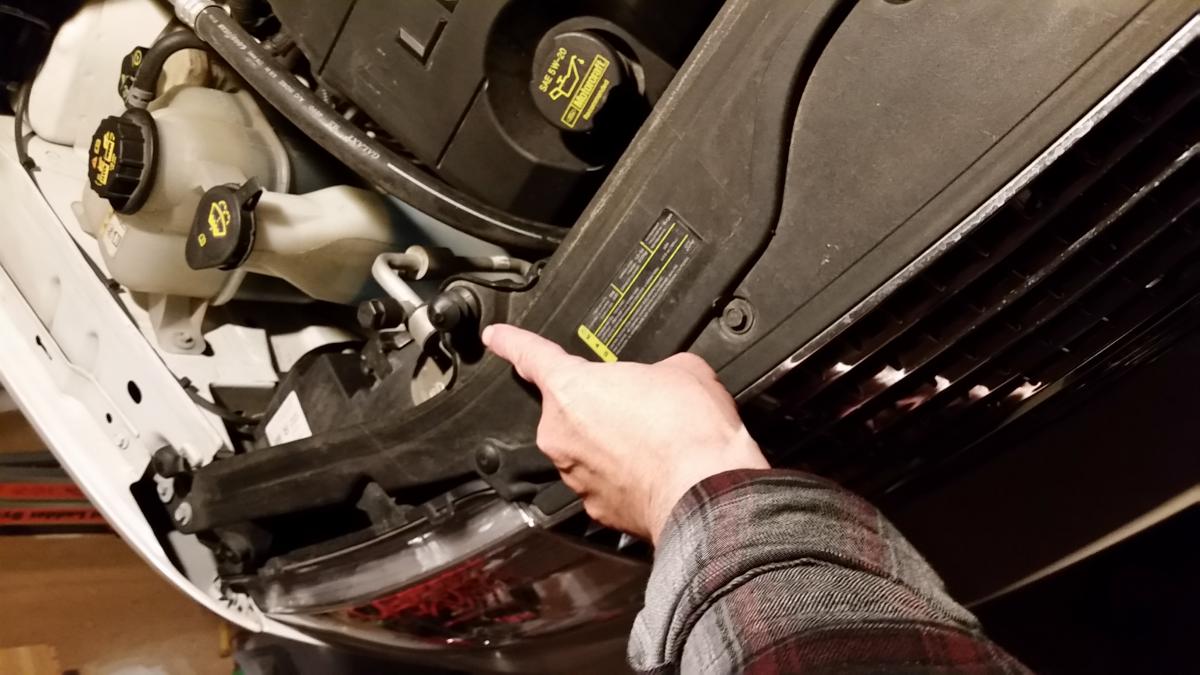

Abbby Posted January 3, 2018 Report Share Posted January 3, 2018 I have a 2010 MKX and it does they same thing. Works fine in summer and fall but when it gets cold it does the same thing. Fails when I need it!!! I have also tried also possible fixes and nothing has worked. There is another sensor under the hood that I wonder what it does. I know where the hood down sensor is and have bypassed that but no success. Mine does not have any under hood light. Pictures attached. Quote Link to comment Share on other sites More sharing options...

enigma-2 Posted January 3, 2018 Report Share Posted January 3, 2018 (edited) On 1/3/2018 at 1:32 AM, Abbby said: I have a 2010 MKX and it does they same thing. Works fine in summer and fall but when it gets cold it does the same thing. Fails when I need it!!! I have also tried also possible fixes and nothing has worked. There is another sensor under the hood that I wonder what it does. I know where the hood down sensor is and have bypassed that but no success. Mine does not have any under hood light. Pictures attached.Could that be a mercury switch to trigger on a hood open event? Or perhaps the antenna? I don't know for certain, but perhaps the under hood switch only works with the engine start security system? Edited January 3, 2018 by enigma-2 Quote Link to comment Share on other sites More sharing options...
