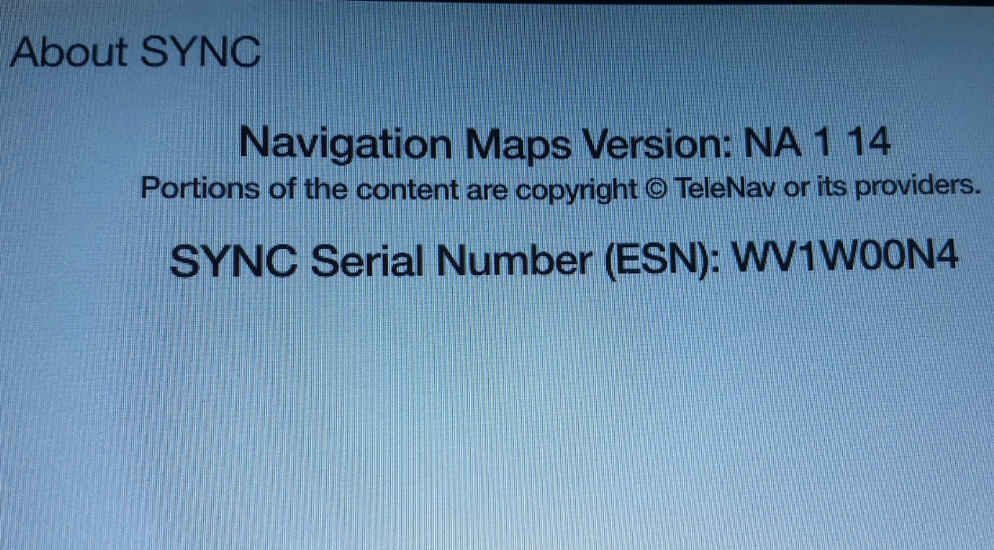

lildisco Posted March 9, 2018 Report Share Posted March 9, 2018 Oh my..... Quote Link to comment Share on other sites More sharing options...
blockisle9 Posted March 9, 2018 Report Share Posted March 9, 2018 Was that recently? Quote Link to comment Share on other sites More sharing options...
lildisco Posted March 9, 2018 Report Share Posted March 9, 2018 Tonight.... Downloading very slowly, but it is downloading Quote Link to comment Share on other sites More sharing options...
lildisco Posted March 9, 2018 Report Share Posted March 9, 2018 (edited) Finally finished Edited March 9, 2018 by lildisco 1 Quote Link to comment Share on other sites More sharing options...
