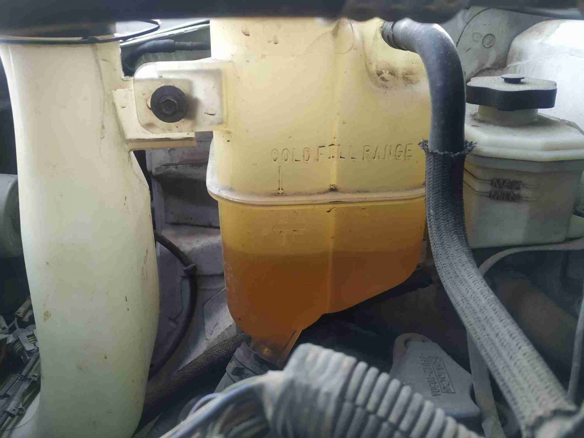

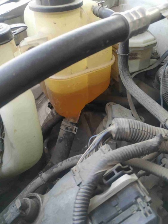

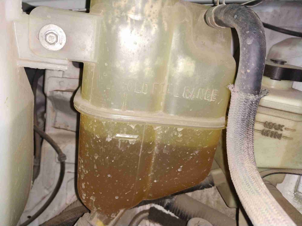

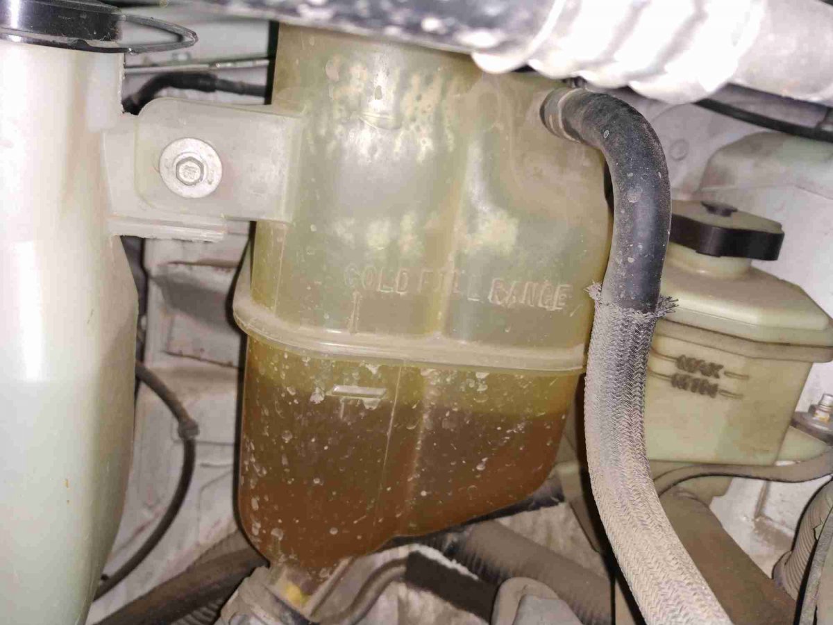

EDST777 Posted December 21, 2018 Report Share Posted December 21, 2018 (edited) Hi. I begin to worry strongly, I noticed that my cooling liquid in a broad tank decreased, I made the image on the cold and hot engine. Now hard frosts-21 degrees Celsius, two days ago after the trip, I heard a light smell of cooling liquid after the parking, it was observed also in the summer few times. Strongly cooling liquid does not fall. In oil on the probe of traces of mixing it is not revealed. In a broad tank of traces of oil it is not revealed. In disorder of the engine of traces of leak of cooling liquid it is not revealed, perhaps it evaporated having got through an opening which is available for branch at breakage of a pomp. There are no errors of the P0016 computer. My run of 157,000 km (100,000 miles). Year of release of 2008. Whether damage of a pomp is possible? Surely at damage of a pomp there has to be P0016 error? When it is better for me to replace a pomp? It is recommended to me the management of WSS-M97B51-A1 (yellow color). I can apply this cooling liquid further? Replacement of cooling liquid was made in 2017, it was 150,000 kilometers. Before cooling liquid was only added, the father-in-law of full replacement up to 150,000 kilometers was not made. What your opinion on replacement together with a pomp of chains of the gas-distributing mechanism, a natyazhitel and an uspokoitel of a chain? I also studied this opinion https://www.fordforum.com/forum/ford-edge-73/ford-edge-3-5-litre-v6-water-pump-30978/ https://www.cargurus.com/Cars/Discussion-t32094_ds771098 Thanks. P.S.: The first two images: on the cold engine The second two images: on the hot engine. Edited December 21, 2018 by EDST777 Quote Link to comment Share on other sites More sharing options...
PaulSchott Posted December 21, 2018 Report Share Posted December 21, 2018 Your pictures show that you have the gold colored antifreeze in the car. Ford changed the specs to use their green fluid. If you don't have antifreeze in the oil, the pump could be leaking from the weep hole that can be seen on the top of the engine. If you are loosing coolant you need to find the leak. If you think it's the pump than do not postpone changing it because it is much cheaper than changing the engine. The gold fluid doesn't have the ability to lubricate the seals on the pump. My pump required changing at about the same mileage as yours. 2 Quote Link to comment Share on other sites More sharing options...
EDST777 Posted December 21, 2018 Report Share Posted December 21, 2018 (edited) 2 hours ago, PaulSchott said: Your pictures show that you have the gold colored antifreeze in the car. Ford changed the specs to use their green fluid. If you don't have antifreeze in the oil, the pump could be leaking from the weep hole that can be seen on the top of the engine. If you are loosing coolant you need to find the leak. If you think it's the pump than do not postpone changing it because it is much cheaper than changing the engine. The gold fluid doesn't have the ability to lubricate the seals on the pump. My pump required changing at about the same mileage as yours. Did you change only a pomp? What condition of chains of the gas-distributing mechanism and an asterisk of VANOS was, I would like to recognize by another you put a set of TIMING CHAIN KIT Fits Ford Edge or you replaced only a pomp and laying of valve covers. I would like to know an approximate state on this run of chains of the gas-distributing mechanism. Thanks. Edited December 21, 2018 by EDST777 Quote Link to comment Share on other sites More sharing options...
