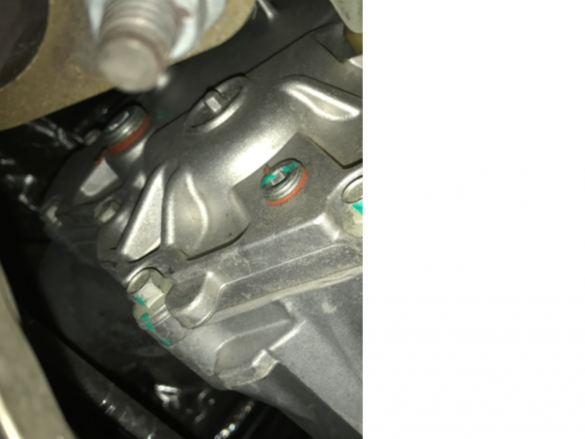

Tightanium Posted August 4, 2017 Report Share Posted August 4, 2017 I have a 2016 titanium. Are these the fill and drain plugs? The fill plug by the exhaust bolt. And below it a much smaller looking plug, but not really at lowest point of PTU. So not all oil would drain. Fill plug looks to be a pain to get to. Note. Not even sure if this is the PTU. Quote Link to comment Share on other sites More sharing options...

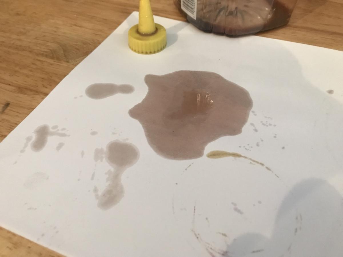

1004ron Posted November 19, 2017 Report Share Posted November 19, 2017 (edited) Today I changed engine oil, oil filter, and PTU oil at 5,200 mi. The PTU oil change was real easy with the drain fitted on these later models. As can be seen in the photo, the oil blacken the paper towel and there was a few filling attached to the drain plug magnet. I used Royal Purple 75-140 synthetic, and will most likely change it every 10 ~ 15K Today I did another lube service at 15K miles - the 10K mile service was done by Ford - I plan to have Ford do alternate services. The Royal purple that came out the PTU still looks good and the magnetic drain plug was clean after 10K miles. It doesn't take much to do the PTU lube service so I'll stick to a 10 ~ 15K mile interval. Also pleased to report that the engine is now 100% dry - no more oil leaks since the solenoid was replaced by Ford. Edited November 20, 2017 by 1004ron 1 Quote Link to comment Share on other sites More sharing options...
