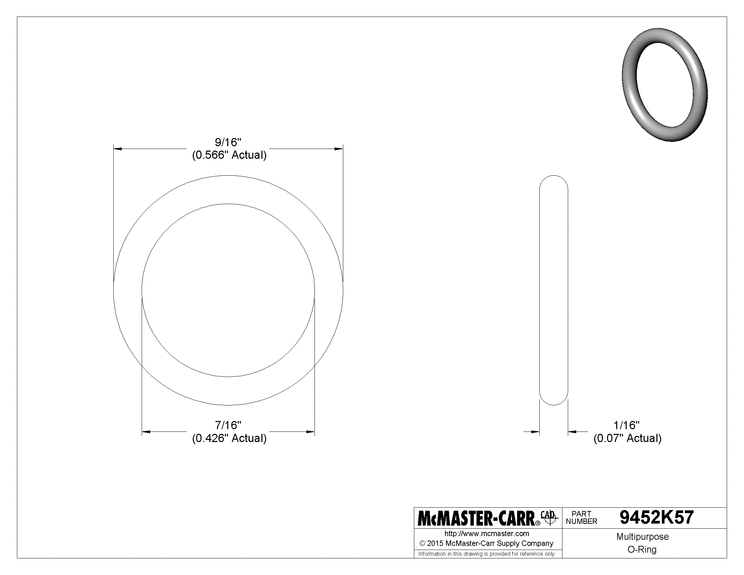

navaidstech Posted October 21, 2017 Author Report Share Posted October 21, 2017 Thanks guys... I appreciate the suggestions. Will definitely look into this. Since I'm pressed for time (need the car by Monday), I went with just a regular hardware store type o-ring for the time being. Not sure if it is petroleum friendly but it should hold me over until I get one that definitely is. Switching it out shouldn't take more than an hour. Just for the record, it appears the o-ring size appears to be 7/16" ID, 9/16" OD and 1/16" thickness. By the way, car runs great with the new speed sensors - knock on wood. 2 Quote Link to comment Share on other sites More sharing options...
PaulSchott Posted October 23, 2017 Report Share Posted October 23, 2017 If you have access to a McMaster Carr account you can order 100 pcs for $4 and change. 2 Quote Link to comment Share on other sites More sharing options...
