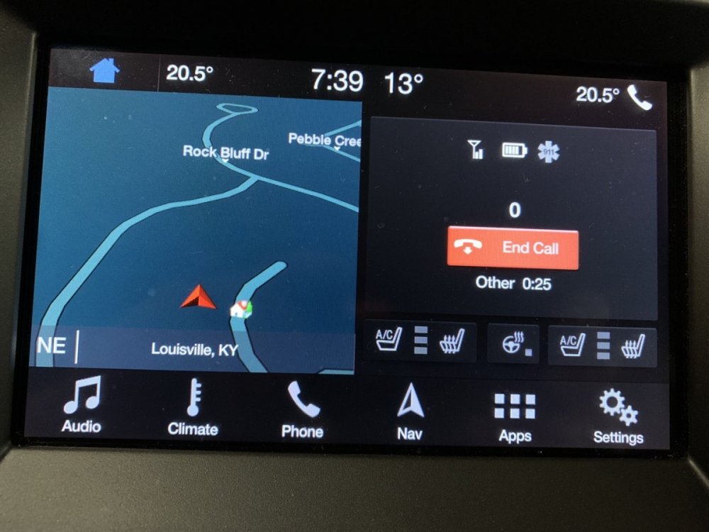

1004ron Posted October 14, 2017 Report Share Posted October 14, 2017 (edited) Apologies if this has been covered - a search revealed nothing. This problem comes and goes, and hasn't made an appearance for a few weeks, and then out of the blue its back. Often when I turn on the car it attempts to make a call and the voice advises to call 911 if this is an emergency, and if I look at the dialled numbers on my phone it show a solitary "0" in the "recents". Also, occasionally when turning on the car the radio goes silent and then a notice appears that it could not connect to my phone, and when closing the message the phone shows connected, and is able to make handsfree calls. 2017 Ford Edge Sport Sync 3 with iPhone 7. PS. I see another Android user reporting the same. https://forums.androidcentral.com/ask-question/814947-why-does-my-galaxy-s8-dial-0-when-connecting-ford-sync.html#post6018509 Edited October 14, 2017 by 1004ron 1 Quote Link to comment Share on other sites More sharing options...
